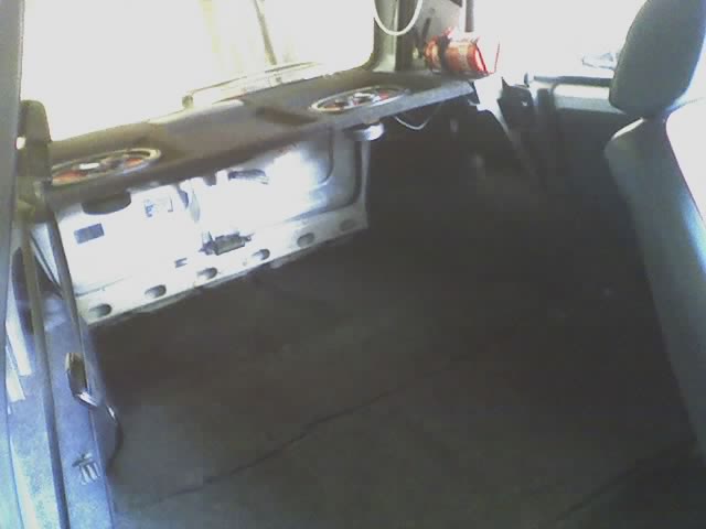

pictures of how i mounted mine in my gp ..
