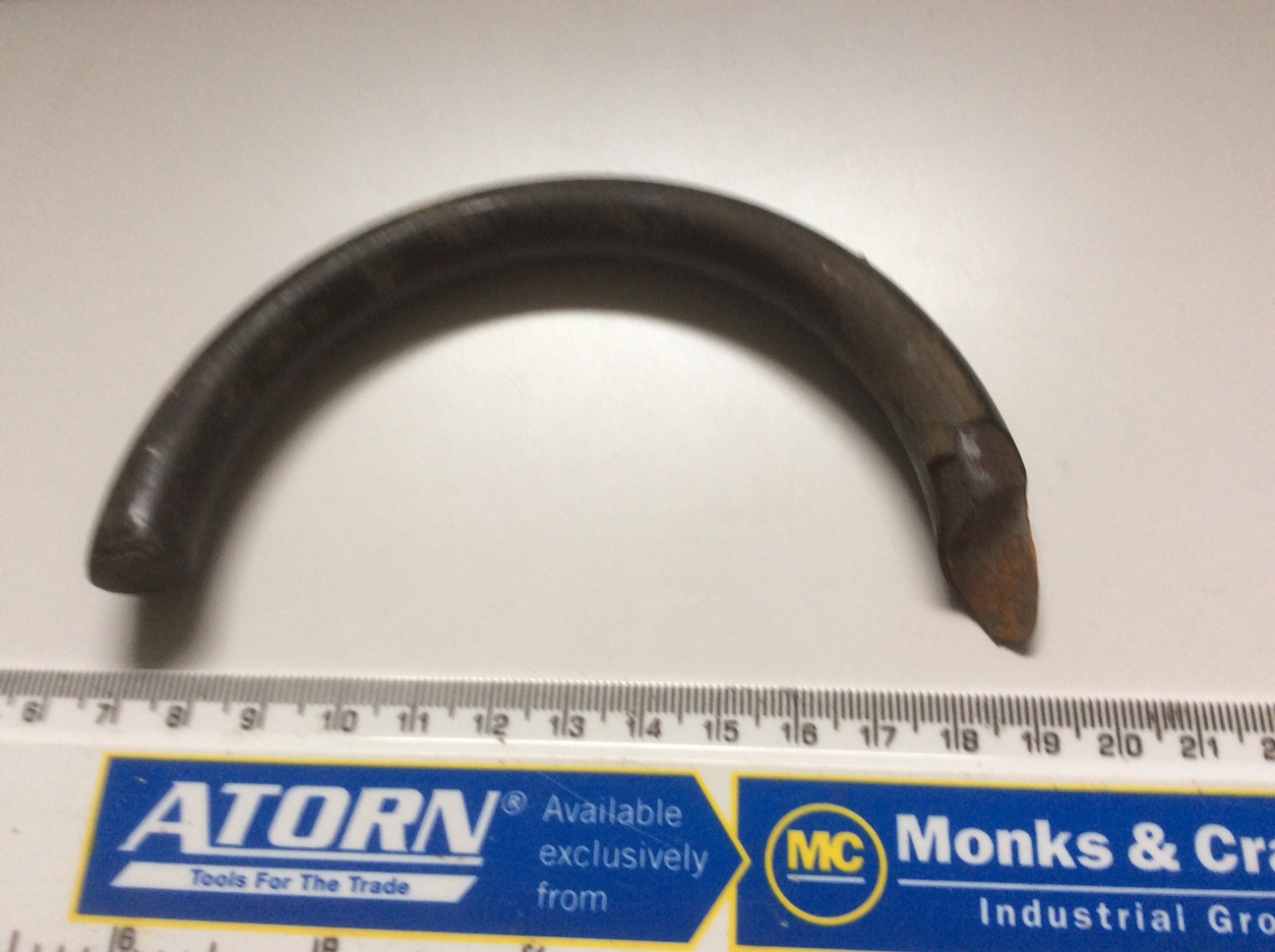

Greeted with finding this on the ground the other week.So have replace the spring. Note the shock bolt top is actually 1.25mm pitch M12, not standard coarse , but other wise an easy job to do. However in removing the cover panel between windscreen and bonnet, three different plastic fasteners are used, rear outer Fir tree, front outer a push rivet with a quarter turn release and then a two side centrally srung hollow rivet at the front centre postion.
Any ideas on the correct term for each of these and a source?
