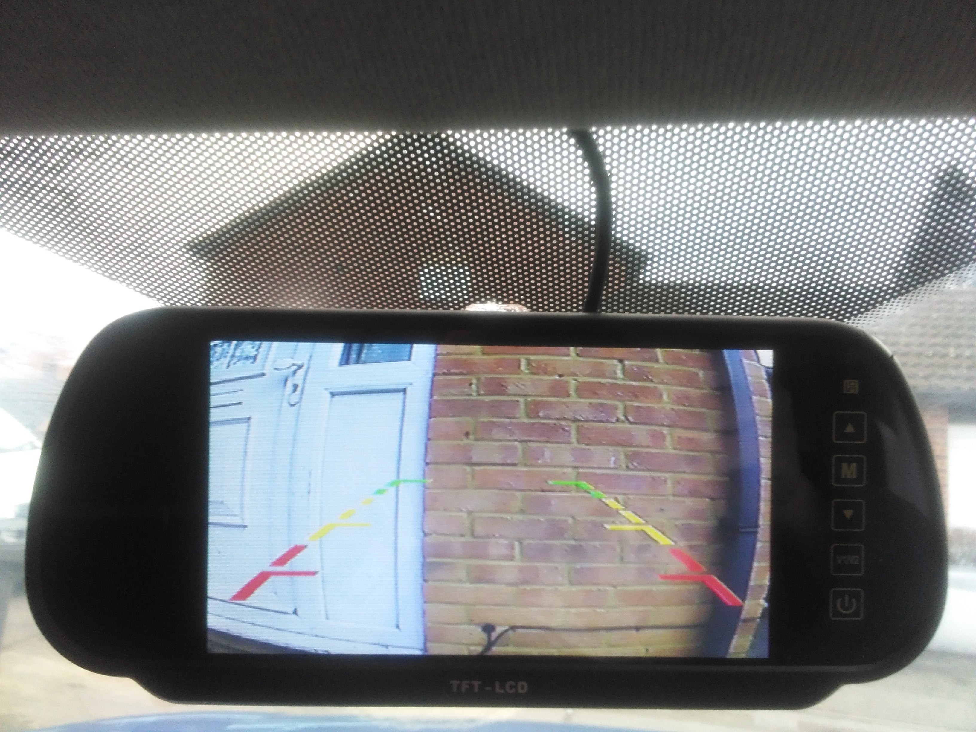

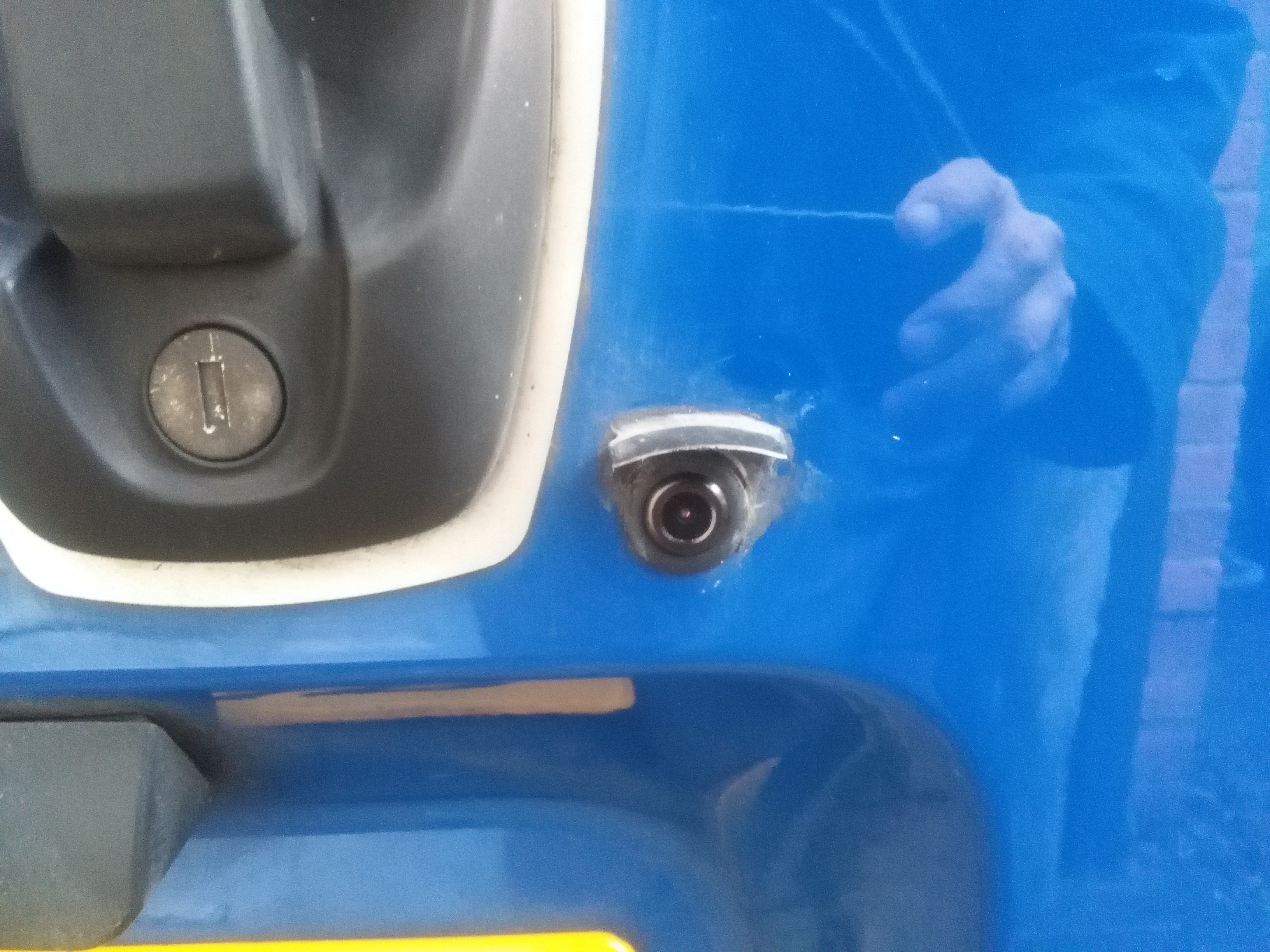

Hi boys , here are some pics of a reversing or rear view mirror I've fitted to my fiorino van.
£35 from fleebay , comes with Bluetooth connection but after a few months ,I got rid of the Bluetooth as interference make the screen go fuzzy, I've run a wire ,direct connection, no more interference, a clear HD view.
It comes with a hole saw , so I've drilled dead centre and cut a black to stop rain getting on the lens and sealed with mastic.
The view screen wired to 12v inside light.(no wires running down)
The camera wired to the back light not the reverse light ,means mainly I use it as rear view mirror . and for parking too with beep beep thingy, very handy.
The camera has a wide angle 170 degrees ( things look too far away ) , if a car is about 3 feet away ,it seems like 10 feet.

Here's another pic ,that's reversing back to the continuous beep , you can see how close it is.
