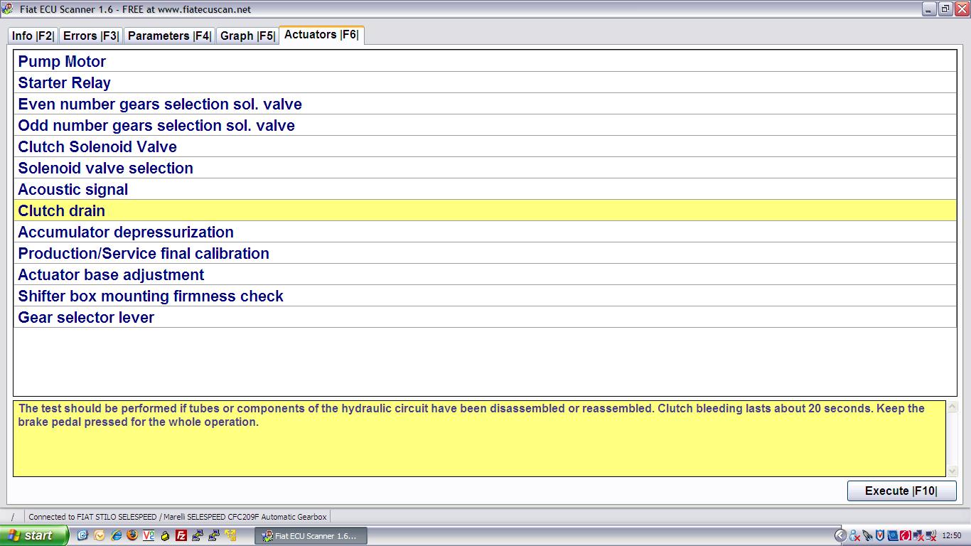

Whats the name you see?
Fiat Examiner updated my selespeed ECU firmware to a new version back in january. Maybe something changed and yanis software cant see it.
I'm really sad. I was counting on the software to see If my coils and plugs are working at its best as I think they are not.
\on mine it's called "Production/Service Final Calibration"
I've attached a pic of what I see for you (y)
