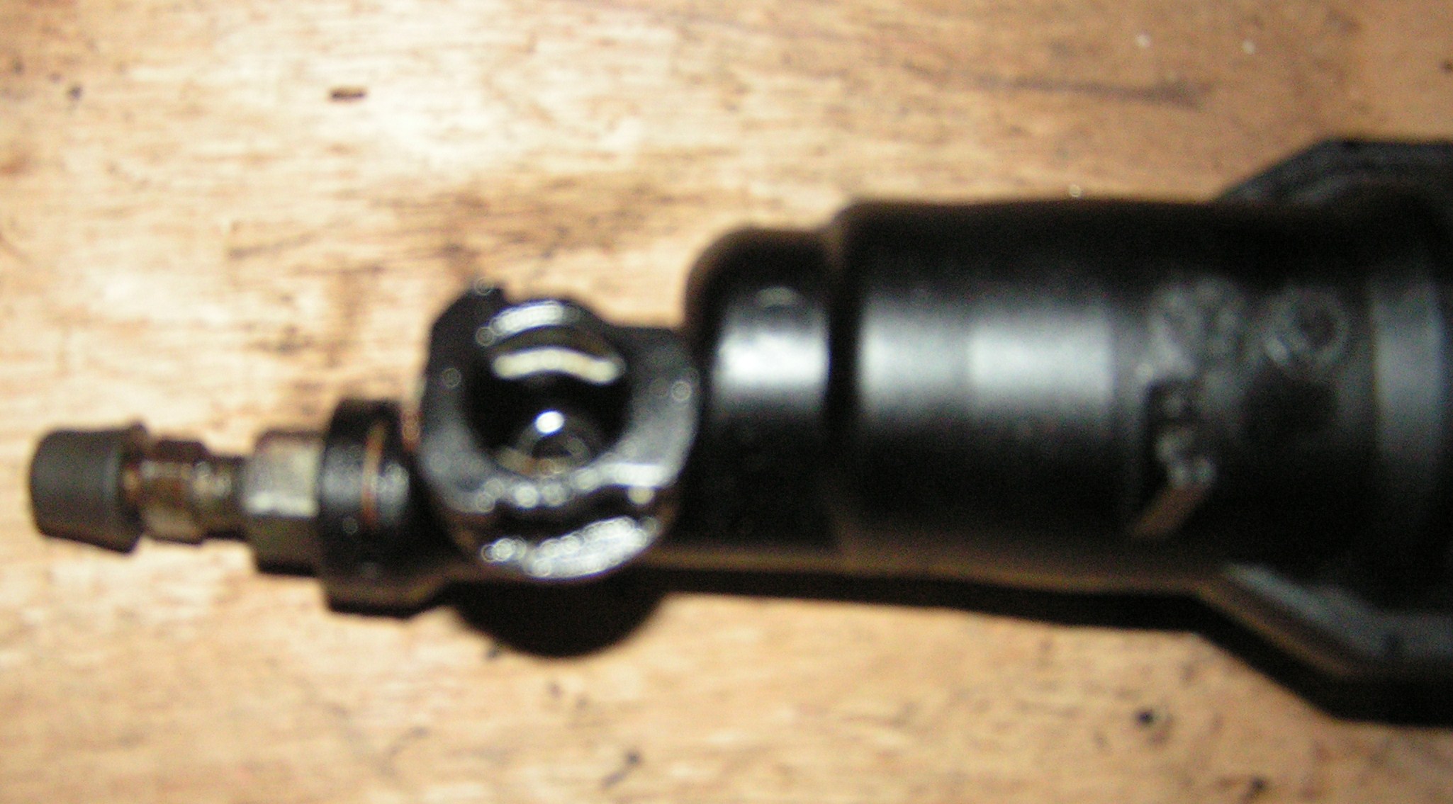

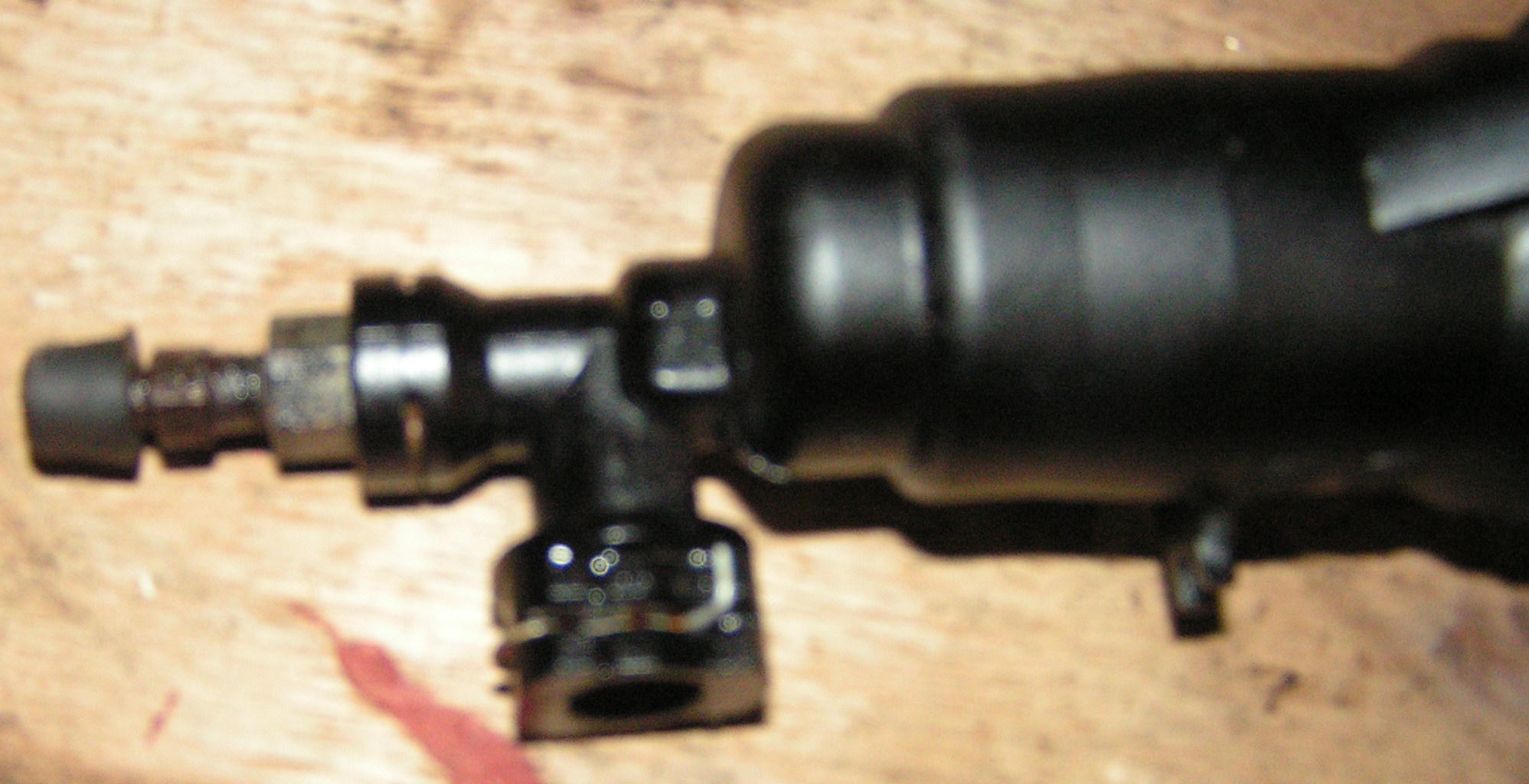

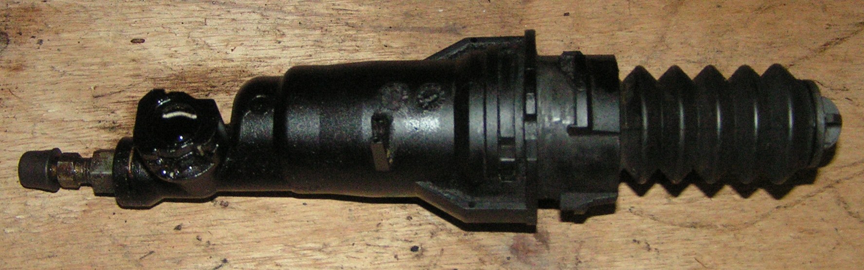

it is not that type of fitting but would have been better if it was, it is just a push in sort of thing with a clip that goes in behind it to stop it coming out, the thing is it was never a problem but is now after refitting.
hmmm, that a different setup to what i have seen then can you take a picture and upload it so we know what we are looking at and the best way to sort it for you
just taken some pics but are not that good, thanks again.

ok those type of fittings are a pain in the rear, the only thing i can suggest is to get a new clip to make sure it is holding the pipe in tight enough it might be worn and giving a bit of play on the union other than that i'm at a bit of a loss as to what you can do to sort that :confused:
Never had one off, but there may be a tiny cup-type seal that fits on the end of the pipe. Vauxhall use a similar fitting and I lost one on an astra once. Why did you split the pipe from the cylinder?
it does not look like anything is missing from the end of the pipe but you never know there could be, i had never done a clutch before and thought that would have to come off but seen later that it did not need to come off, I have a new onw on order and will be here tomorrow if that does not work it must be the seal at the end of the pipe but god knows what i will do then.
