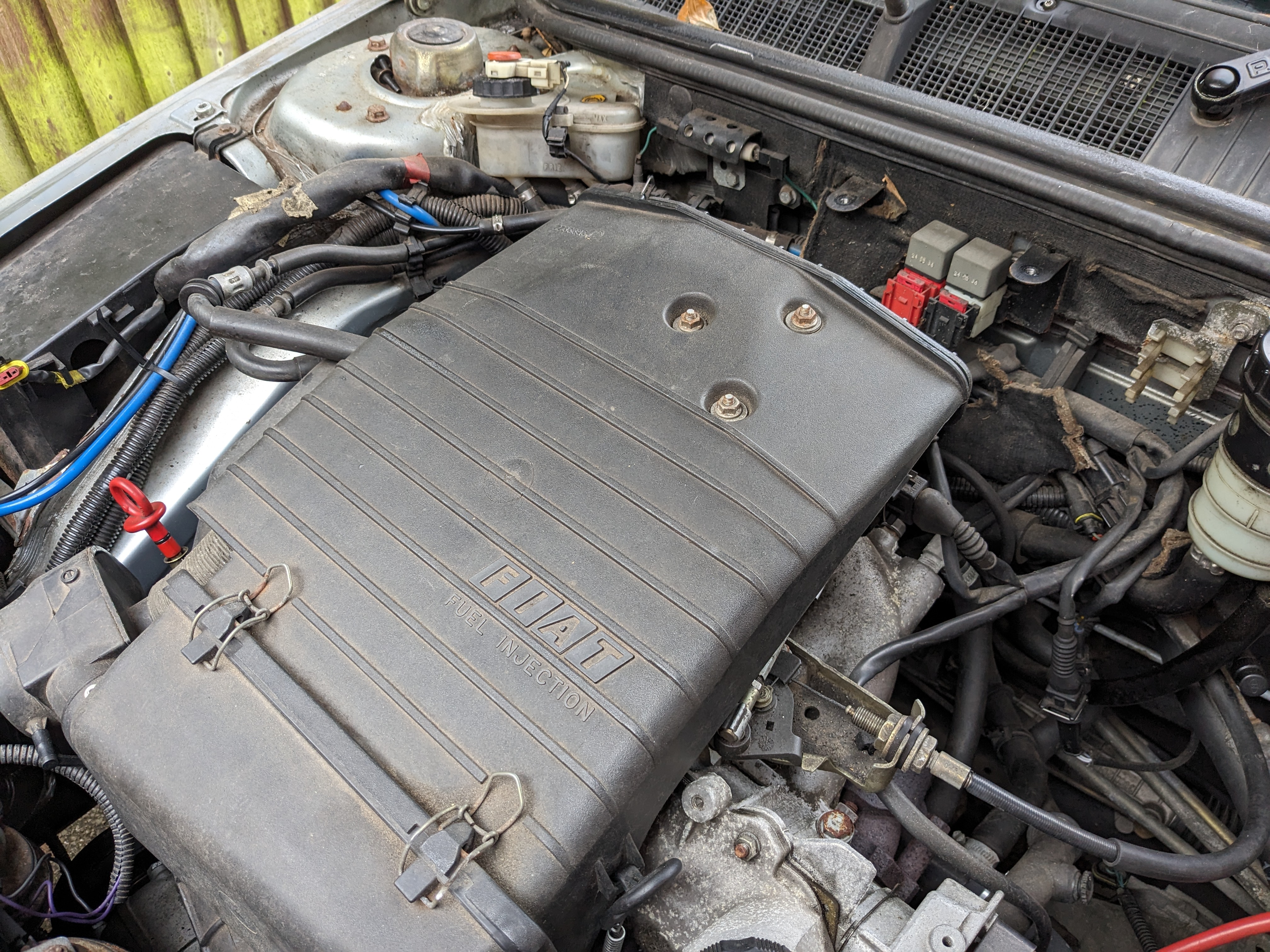

I've never seen this on the 1.6 i.e. The ECU must be doing this from 1993. But Ebay set to Europe finds most things :)
My Tipo SX 1.6 ie May 1993 (SPI - single point injection) had a Digiplex unit.
for manual transmission the P/N was 7745672 - MED 474
for auto transmission the P/N: was 7745675 - MED 477
Digiplex free. So it can be done, but easier to find a new unit :)
