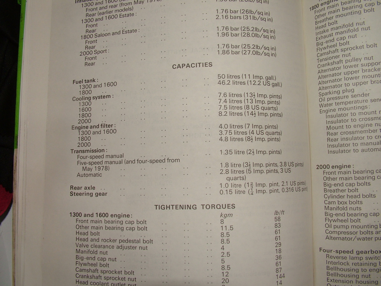

Hopefully someone else has more accurate information. This comes from a 1985 Technical Service Data Manual for the motor trade for the Fiat Argenta 1995cc. The last two photos are from a different manual which goes up to around 1982. Sorry this is all I have. Note there is differences in the capacities shown.

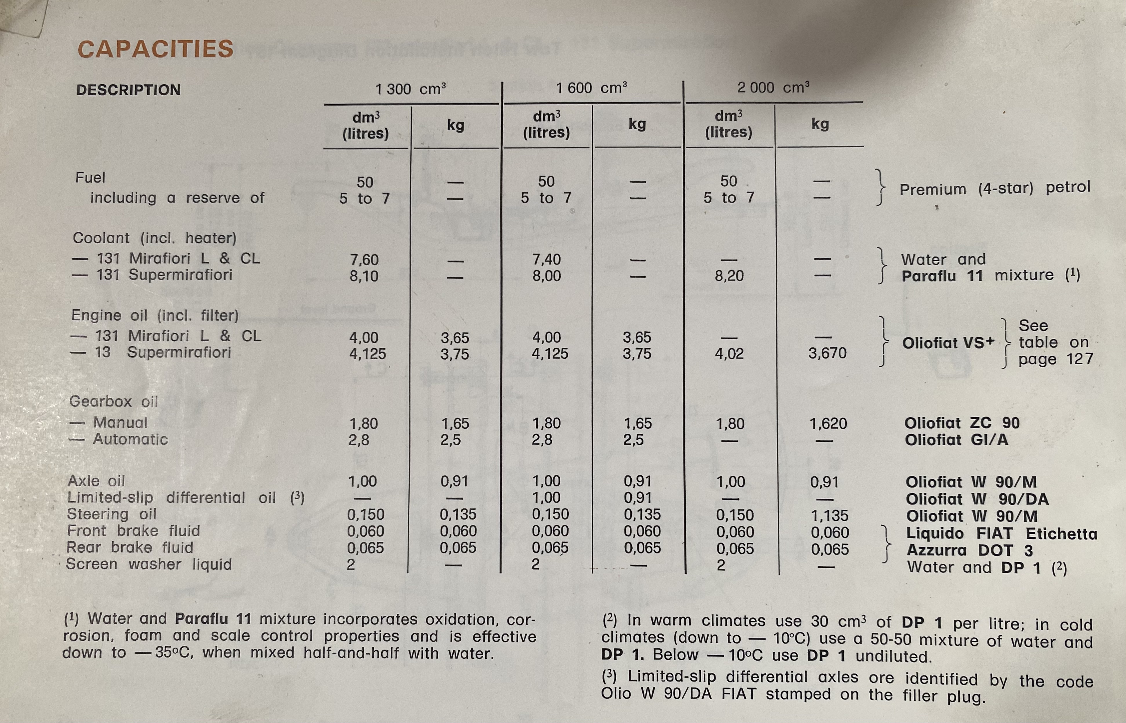

For the sport/racing but, as you can tell, there’s very little difference in oil capacities across the lampredi engine range, due to the fact that it’s the stroke, rather than bore, that is the real difference in engine sizes…most of the capacity differences across the two litres fitment in Fiat/Lancia had to do with sump shape, heads and induction methods

I've dug out my old Haynes manual for the 131.
They state 4 litres, for all the 131 engines, both ohv and twin cam, including the filter. That seems to ring a bell, and is a good place to start. Add that much, let it settle, use the dipstick.
Haynes manual number is 310, if you can find one.
