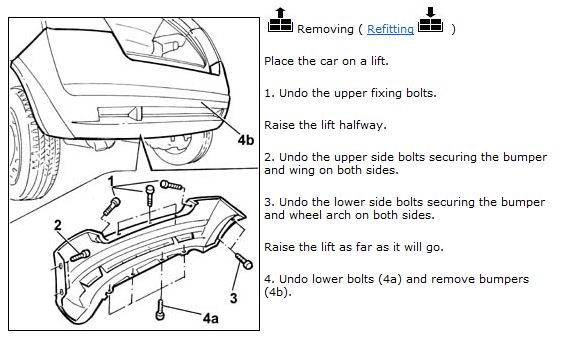

This is all it shows in the workshop manual for the 3 door.
