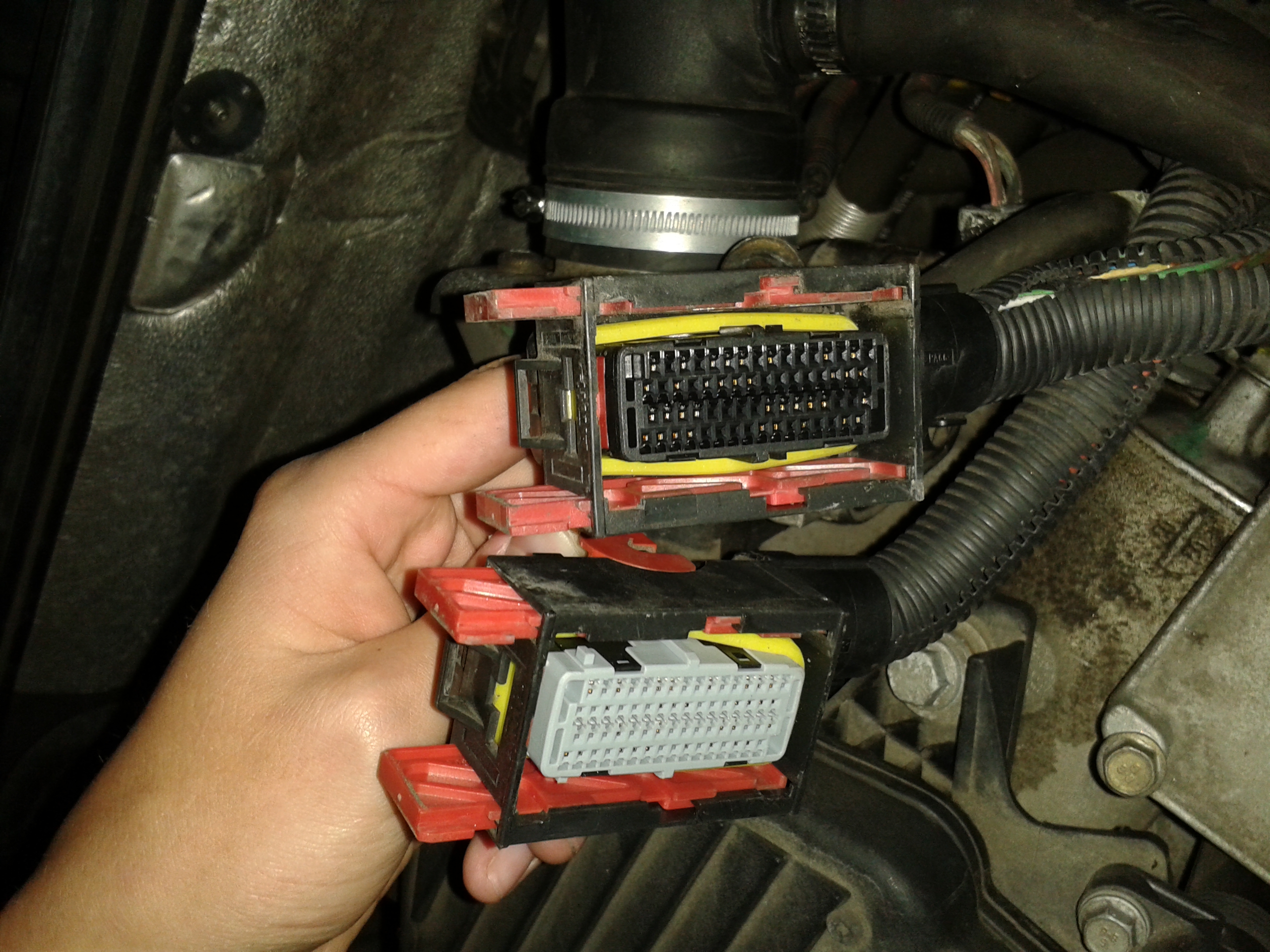

If the ecu is not getting the right voltage, ground or signals from other components it will give you loads of errors. Even if it's just one of the pins that has poor contact. Buy a contact cleaner. Don't use tissue or anything it may leave residue. Spray the contract cleaner directly into the pins for a good few secs don't be afraid to spray it. Make sure it dries completely before connecting it again. 20 mins or so.

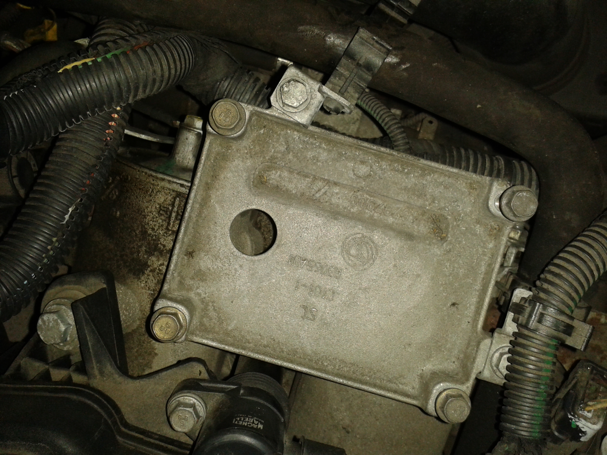

Cleaned all ecu connectors and ecu itself, but couldn't fire a car up because after yesterday towing battery is flat... when ignition on and trying to fire it up car is dead only asr failure, ebd failure and loose connection on a screen.
So will arrange to sort it out.

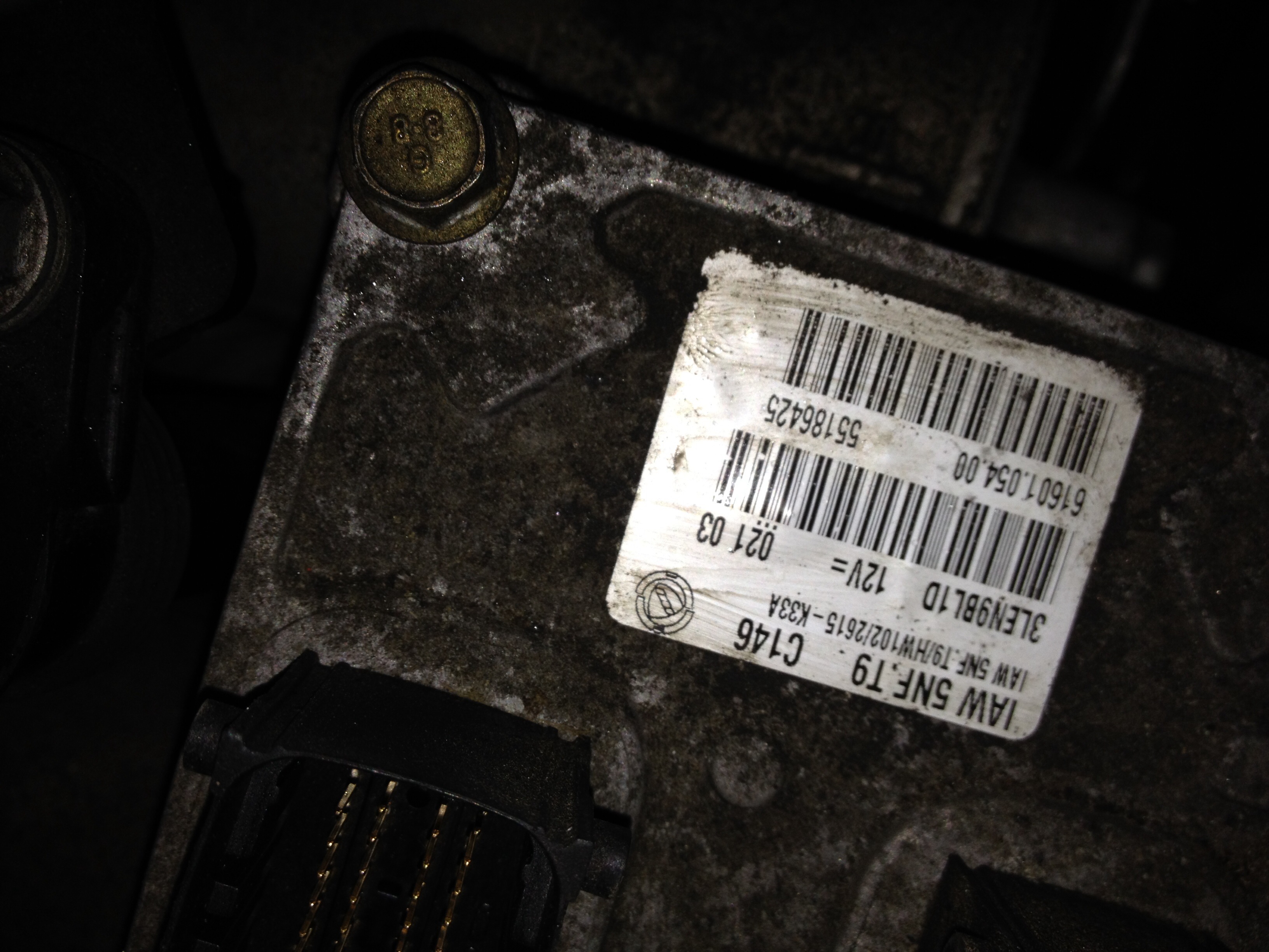

Question regarding ecu, I was looking online for a replacement just in case and found one however last digit is different, mine got 0, but on a website is 1. Does it mean it won't fit?
My ECU number: 6160105400 / IAW5NFT9
Website ECU number: 6160105401 / IAW5NFT9
