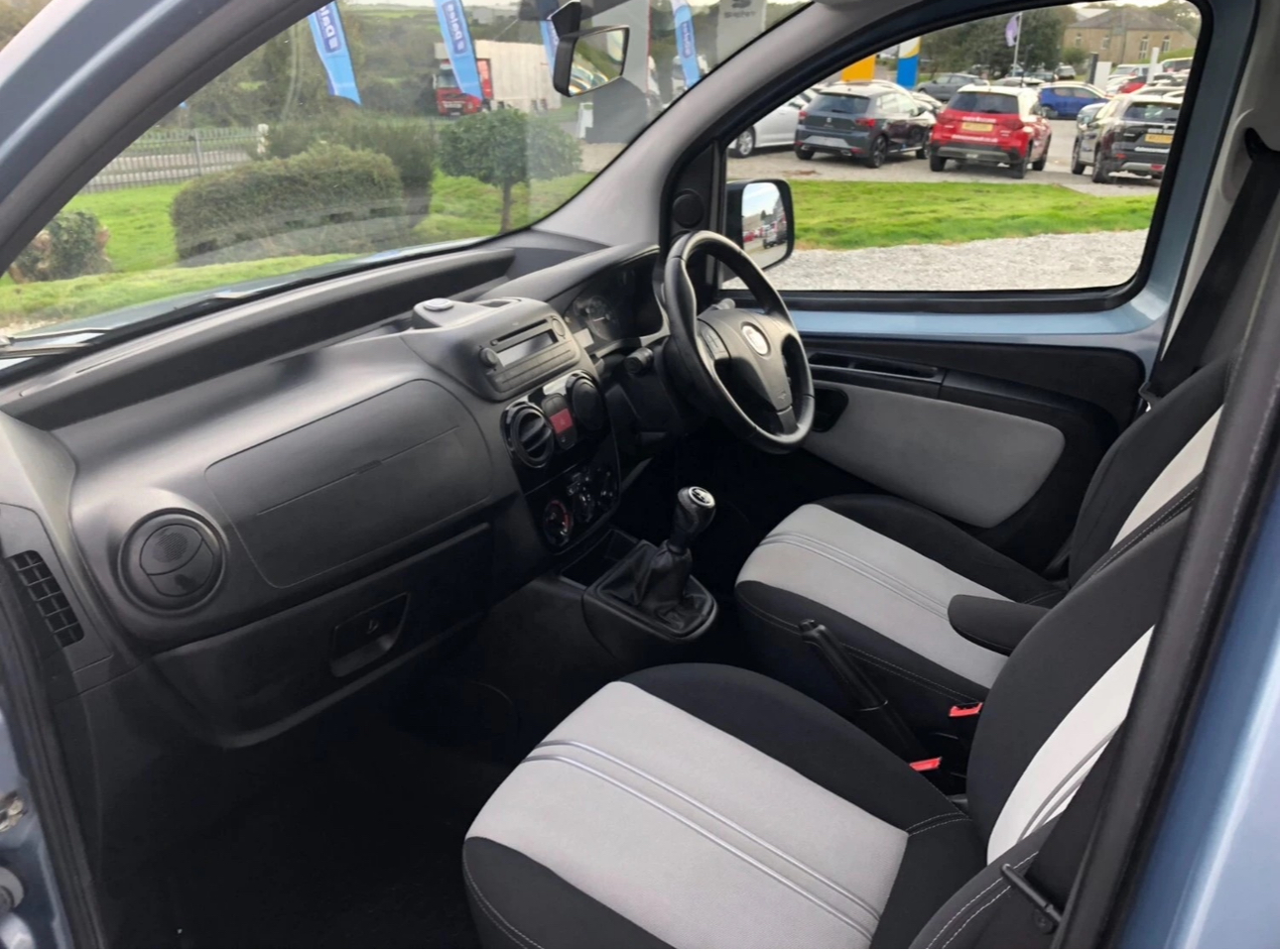

Just picked up my Fiat Qubo last Friday. 1.4L petrol. Great car to drive. I was looking to convert it into a micro campervan but would like a fold flat front passenger seat. How would I find one in the UK.
you_doodle_2023-10-07t12_42_50z-jpeg.431466
Citroen nemo van has a folding front passenger seat as standard from 2014 (I think). Just done this myself. Mounting brackets all line up. Minor trimming of floor insulation and a resistor across the seat airbag sensor and all done. Looks tidy and no warning lights

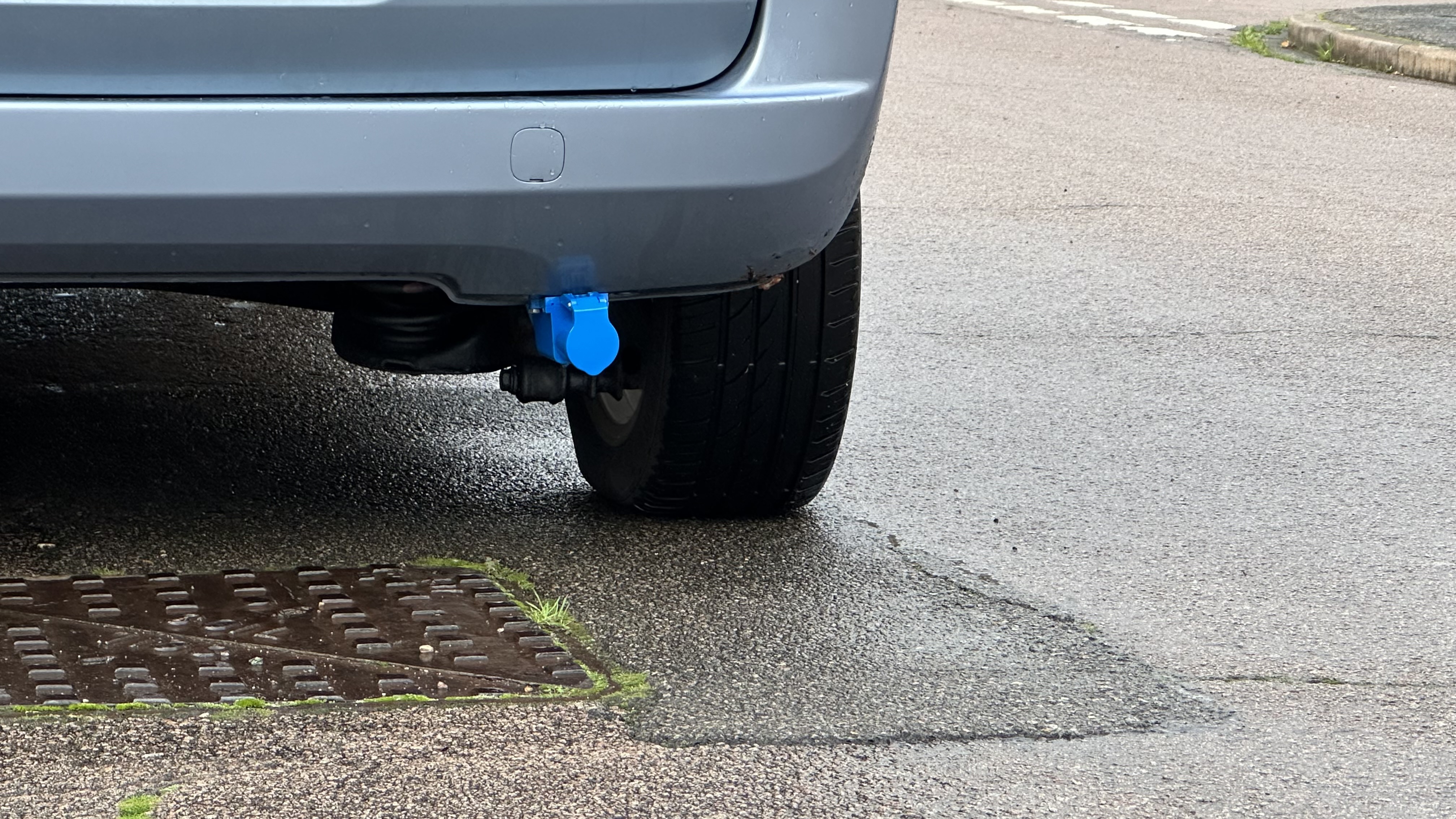

I have seen people do micro camper conversions of the Qubo. So I thought I would create one as well. It’s just for one being such a small vehicle.
