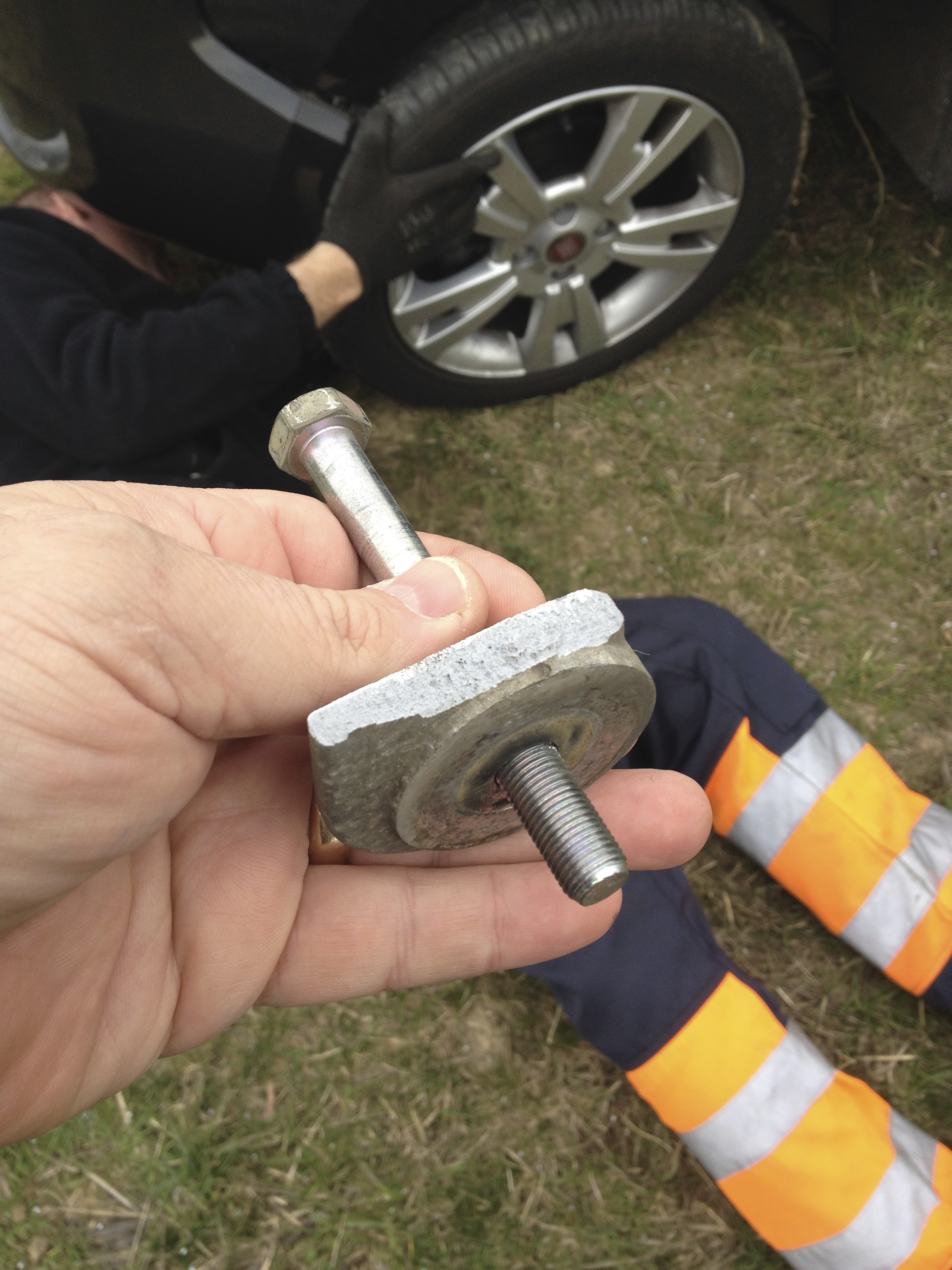

On a sharp bend at about 20/25 mph with 2 hands on the steering it snatched it out of my hands & we headed for a I ditch & field ,we came to rest approx 100 ft from the road ,

These are horrific, total malfunction, inferior part? hairline fracture?

it was the bottom wishbone in 3 places i think ?
i have one bit of the suspension in my posetion and its got metal fatigue (n)

Hi, Looking at that picture of the piece of wishbone............the fracture line looks very clean, I just wonder if it was caused by the incident, as opposed to causing the incident. Maybe another component failed, and as a result the wishbone broke ???????? Just a thought. Look forward to hearing what Fiat (dealer) has to say. Cheers Qube O......

TBH the sheared component in your pictured hand . looks like an aluminium alloy.. so shouldn't be a "stressed component" of the steering / suspension.., ( another component may be faulty)
either way there is NO WAY this should have failed on a NEW / vehicle with sensible road mileage,
