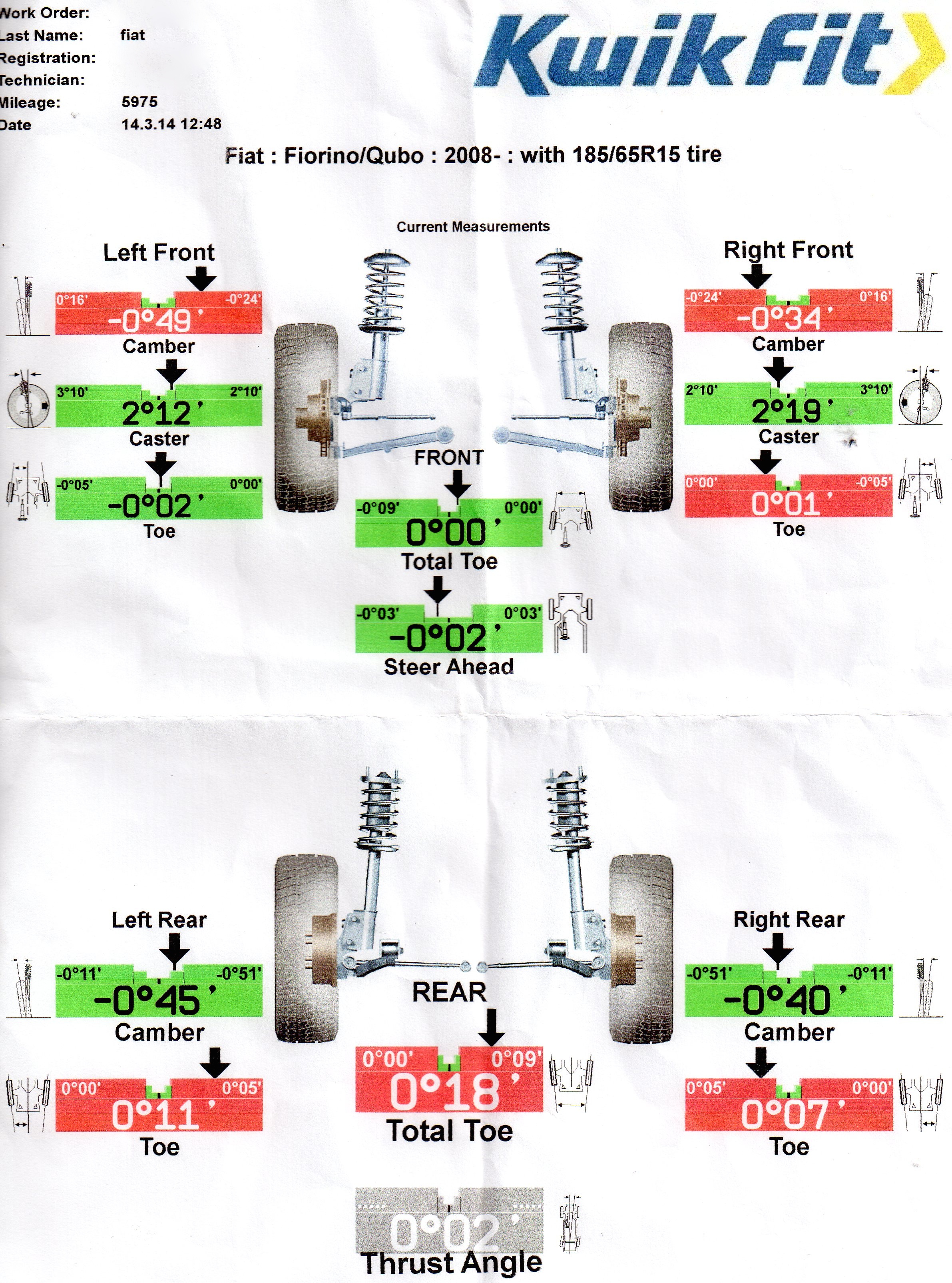

if i post the tracking photos on here maybe someone can understand them ,
i just need to photoshop the registration out of the pictures
the kwik-fit people said it was SAFE to drive ,
kwik-fit people said with the printouts it was best to take it to fiat to deal with it (it could of been warranty issue )
any advice on the tracking pictures would be great,

At last with the printouts it is starting to make some sense.
Generally only the tracking is adjustable. This is normally the cause of tyre wear. The full alignment check shows the accuracy of the body alignment and suspension mounting bushes.
The first Kwik Fit identified issues with camber and caster which are not adjustable. They referred you to the dealer as only they in conjunction with Fiat can find a fix or replace the vehicle. At that time, it should have been safe to drive if alignment was the issue. In hindsight, it could have been flexing of the bottom arm causing the alignment issues, so unsafe to drive, but not having been there it may not have been apparent to the inspector.
The second printout is a key clue here. The values have changed significantly. The rear values are close enough to be minor differences in operator or equipment, but the front values have changed enough to suggest that something has moved in the time between the two measurements. This could well be evidence of the bottom arm flexing, changing the readings.
With just the evidence here, it would appear that the bottom arm was fatigued and failing. This caused the rapid tyre wear and the changing readings. disappointing that the inspectors did not see any evidence of the arm fatigue, but for the alignment check they may not have looked under the car. (Difference between fitter and technician)
The issue now is whether the bottom arm cracked due to faulty material (could indicate a batch fault), a design fault which may indicate that all cars are at risk, or whether it failed due to abnormal loads and forces. These could include regular kerb or pothole strikes, so would be down to the driver. If a fault with the component, Fiat will want to determine that and determine if a recall is needed. They will take it seriously. If their inspection determines no fault with the material, they will say not their fault, but may, if asked nicely, contribute to the repair costs. Motability should be fighting this as it is their car. If you're not happy, ask for the broken bits back and talk to Dept. of Transport who will order a recall if they believe materials are at fault.
