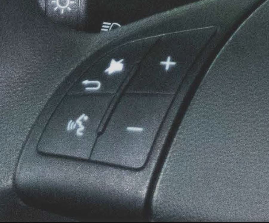

My van is from 2014 and on the steering, I don't have the windows logo button but the voice control button. That's fine by me but I don't understand what the voice control is for, because it's in Dutch language and it doesn't have Bluetooth either. I see phone book, last call, saved contacts, etc on the dash screen but how to upload my contacts?

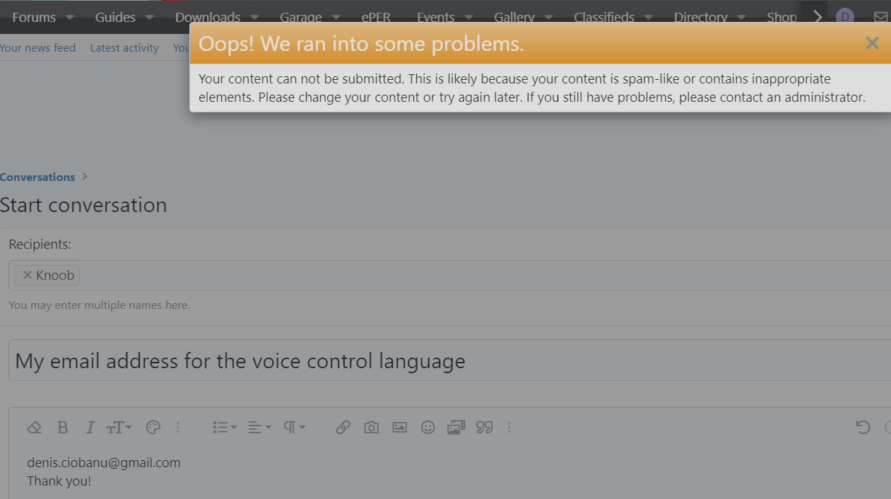

Thanx for the file. I don't have blue and me. Just voice control. I don't know how that works because I don't have Bluetooth. Only just USB but I don't want to connect my phone to a USB cable every time I drive the car... Are you sure that the file you give me will be good for my car? I don't want to end up with software issues.
The dash menu is in Duch as well as voice control. Can I change both of them to English?
Thanx!
