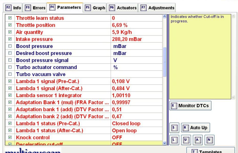

ok check screenshots, although engine was still cold (~50C) will check again tomorrow after a ride with engine hot.
iPhone app is EOBD-facile/ the other screen is from multiecuscan.
iPhone TPS = 20%
Multiecuscan= 6.69%

Yes B1S1 is switching fast I just captured at the low voltage phase.
S2 Voltage is ~0.50 all times normaly (check multiecuscan previous screenshot after-cat)
Check new attached screens also.
ps. Like a said engine was cold ;)
edit: yes closed loop.

Yeh they look ok , shouldnt be reading -50 cold though should be reading actual engine temp easiest way is to cross ref with ambient air temp when engine stone cold before starting they should read roughly the same

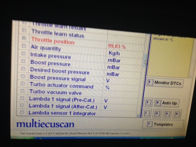

After a 30min ride:
Throttle position
Idle (and not moving): ~5.91%
Accelerating: ~99.83%
I'm attaching pedal sensor values too.
