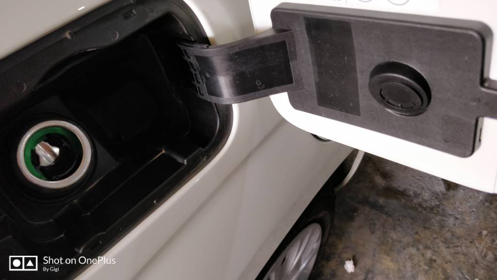

Hi all is the fuel dust cap that goes between the inside of cover and nozzle mentioned in the owners manual supposed to have come with the car as mine came like this see attached pic. Thanks IMG_20190323_152932.jpeg

So its seems that they do come without it also too bad i thought mine was lost before i bought it and could claim it back from fiat dealer

The filler nozzle has a metal plate across it that can only be opened by putting the end of the correct fuel pump into it (it won't open if the size is not exactly right - and so prevents you putting petrol in a diesel car, or putting leaded into a petrol one - or anything 'wrong' into either). Commonplace across the Ford range as well as the Panda. (look up Ford SmartFuel)
Part C should be present on the fuel door.
My 2017 model has the rubber cover. It would appear to be vital too. I shall check my new one has one when delivered Thanks for the warning. I would complain and ask for one to be provided.

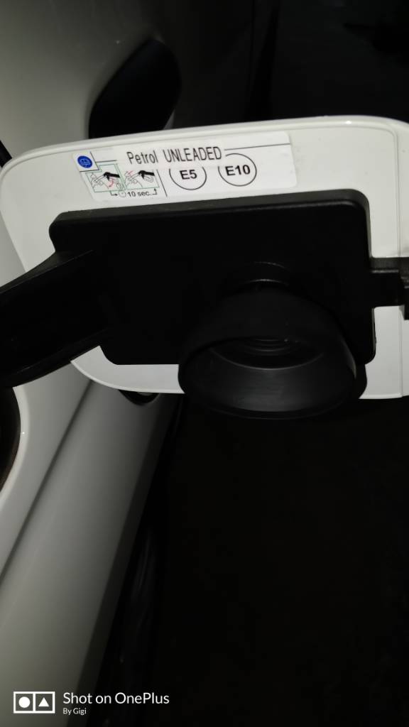

I went to the Fiat dealer again its true some export models do not come with it ( if you see my photo you notice that were it should fit its closed) but fortunately he ordered the part for me for free and they will fit it also.
Maybe you are right but if you noticed mine before dealer fitted it ..the hole where it should fit was not perforated meaning that it was not fitted from the factory.
