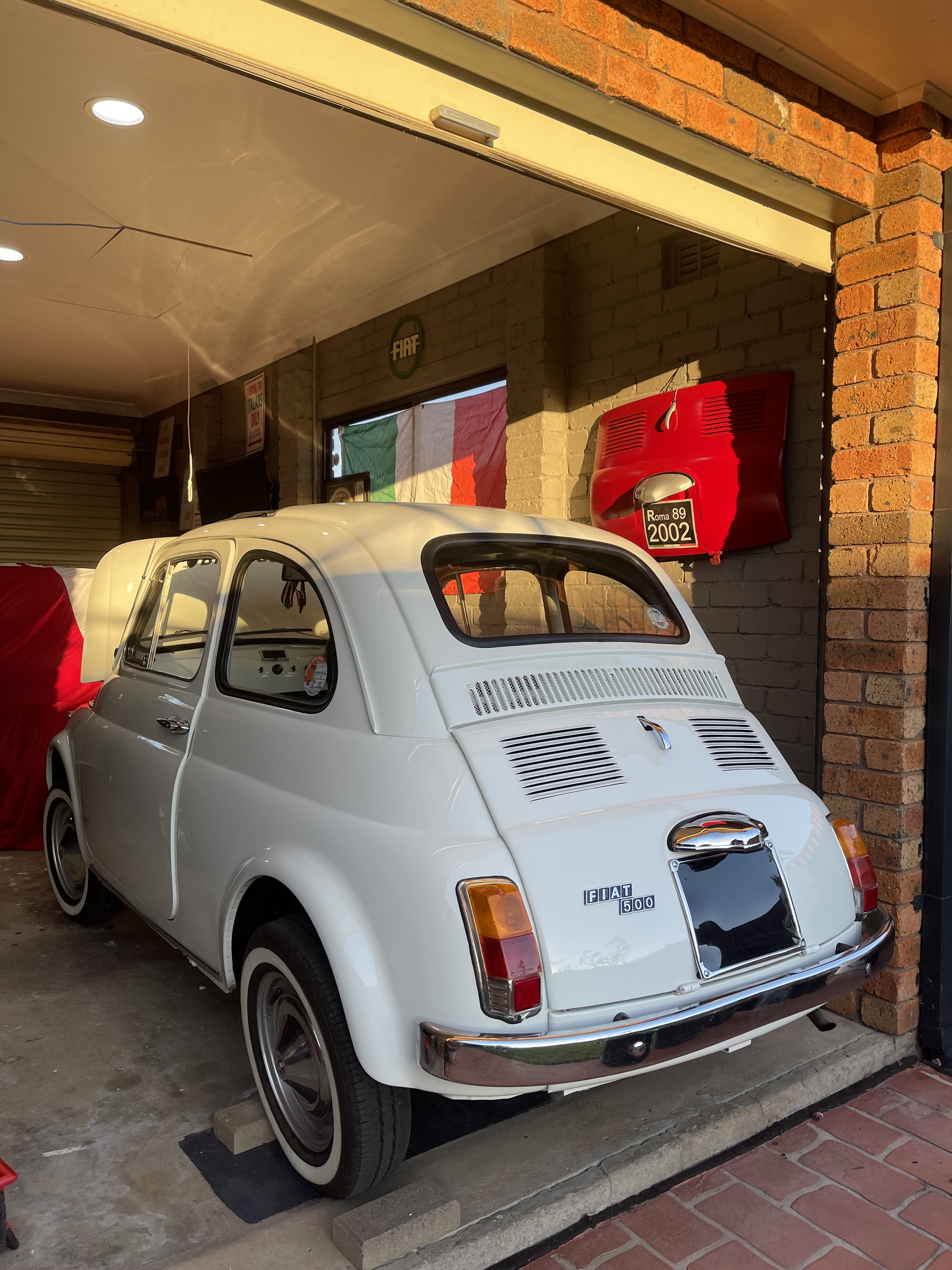

Hey guys my 1968 Fiat 500 F is having problems when driving, doesn’t do it all the time, when your coming to a stop the car stalls and you have to re star it and will only say on if you hold the revs up also when start car is struggling not sure what could be wrong, and generator light is on and won’t go away I’m assuming all this is electrical issues battery is at 12volts and doesn’t drop at all even after driving with head lights on for a while any help would be appreciated thanks
