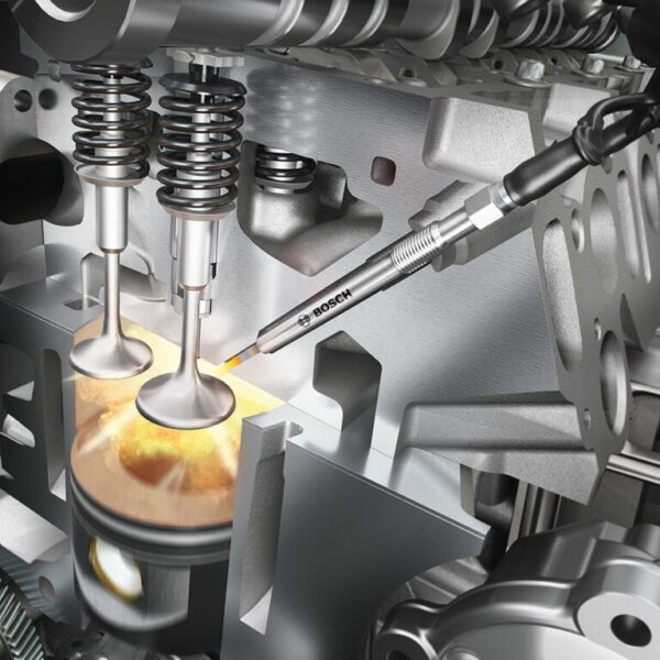

I think the glow plugs on the Ducato are sealed directly onto a conical part of the cylinder head. I don't think there is any separate insert. See the attached generic pictures, the second one is a still from a video by Pichler who market a set of tools for cleaning up this part of the head.
See
Did the glow plugs come out complete, or was any part left behind ?
As this is a critical operation, you may wish to chat to a friendly Fiat technician, if you can get past the receptionist !

Hi Anthony489. Firstly, thank you so much for replying. It's sincerely appreciated!
I got all of the glow plugs out intact. There is definitely some kind of sleeve or seat in there that is not part of the cylinder head.
My biggest fear is that something broke off of this 'sleeve' and is now laying all cosy on top of no3 piston just eagerly waiting for me to turn over the engine so it can bend some valves 😂
I've given it quite a lot of thought and I'm considering to pull the head off. But before I do that, I'm going to try and remove this 'sleeve tube seat thingy' that's in there.

So I have an update regarding my dilemma, and I am happy about it, but at the same time I feel like a fool.
I was convinced there was something like a removable seat or chaft in the cylinder head where the glow sits, but I was mistaken and Anthony489 was correct. There was a piece of old glow plug stuck in there. It was part of the threaded area which I assumed I destroyed when drilling out the old glow plug. This piece got pushed in deeper when I was cleaning the threads with the tap. It fooled me because it was so perfectly round.
Again Anthony489, thanks for responding. Case closed.
