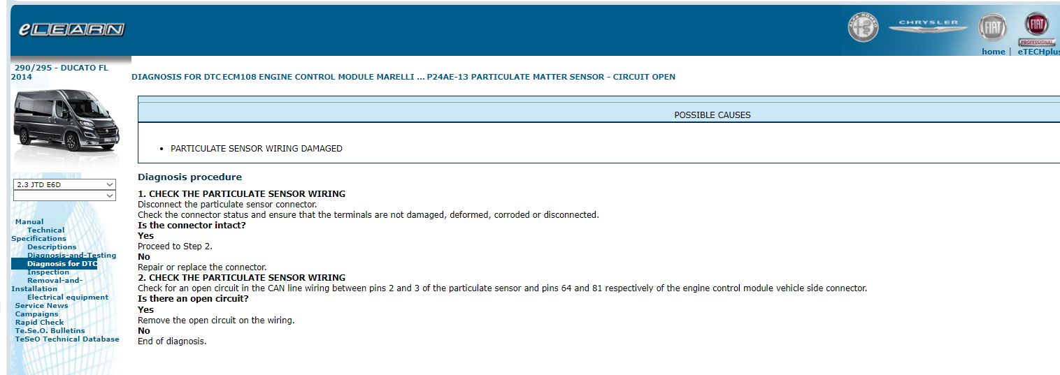

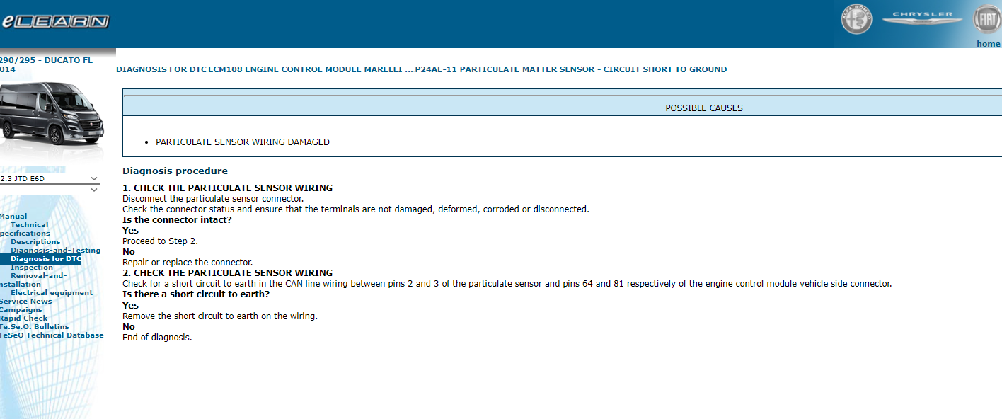

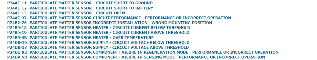

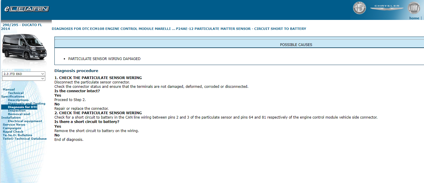

wHAT IS THE FULL error code. here are 3 possibles and diagnosis
Here is list of possible Particle mattter sensor errors.

That is a very interesting and useful site! Still not sure where the sensor that has the problem is though!
It is P24AE-13 particulate matter sensor -circuit open
So check the connector then continuity to ECU pins as suggested

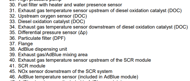

The only sensor I can see on my vehicle is one that looks like number 40 on the diagram below. However, nothing on this diagram is labelled PM sensor.
