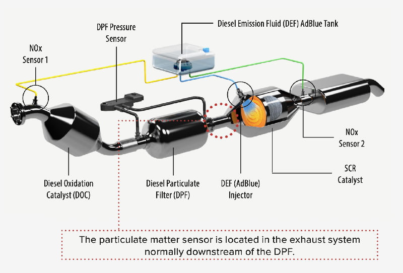

Got a engine warning light a while ago. Multiecuscan software says it's the Particulate matter sensor at fault. (Pa24 AE) I did have Fiat check it too and they said Nox sensor. Is that a different name for the same thing?

And Nox is definitely not the same as soot sensor/ totally different

A question when is a particle sensor a NOx sensor
I withdraw the above as it appears fiat also call Nox sensor "particulate sensor "
I don't know where the "soot" description came from.
Apologies

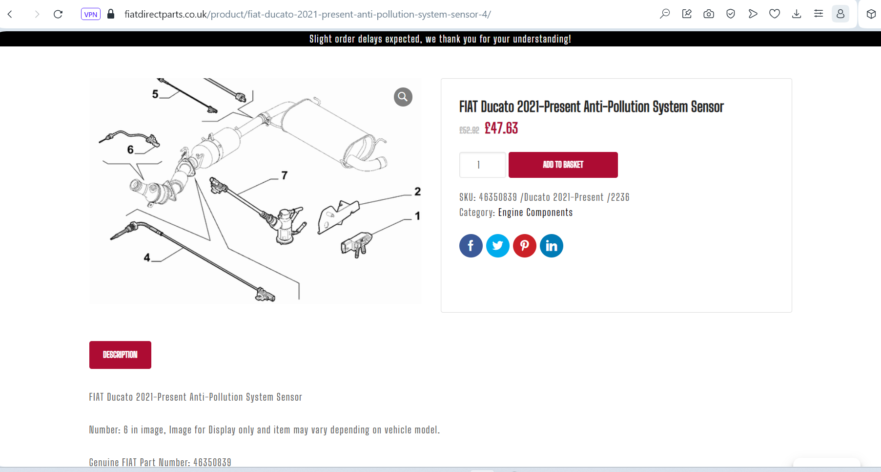

This is my worry about getting this fixed. it seems to be called so many different things and come at such a range of prices. How do I know which part I should be buying for my particular fault?

That's an easy question.
Ring shop4parts with your vehicle details and ask for a price for the part, remember forum member who have donated get a nice discount.
The part name is nox sensor or gas particle nox sensor
If shop4parts can't help with this (I would be surprised) ring coastal motor homes with your details to make sure part number in your post, 6000633295 , is correct and buy it from them- they are very good .
Unfortunately on this site the photo of the part does not match the part number.
The part number is for a temp sensor not a nox sensor like the photo.
Not digging at poster just adding In case anyone tries to use that part number for a Nox sensor.
Cheers J
Which is the incorrect part?
