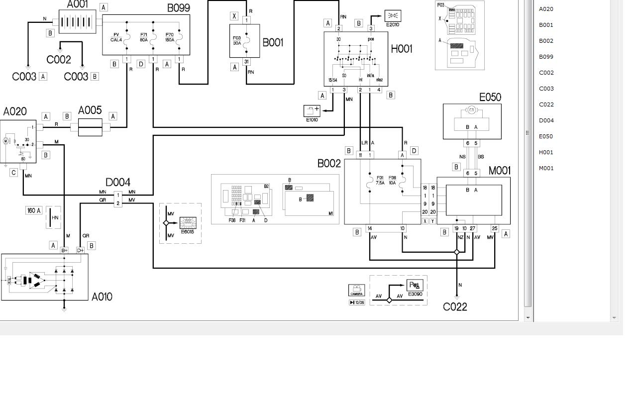

I can confirm that there is no starter relay on x250 model. See attached diagram, which is barely readable (copied from forum). As suggested by @bugsymike possibly a wiring fault, but that could include the ignition switch.

A jpg picture of the relevant part of the drawing in the post above
