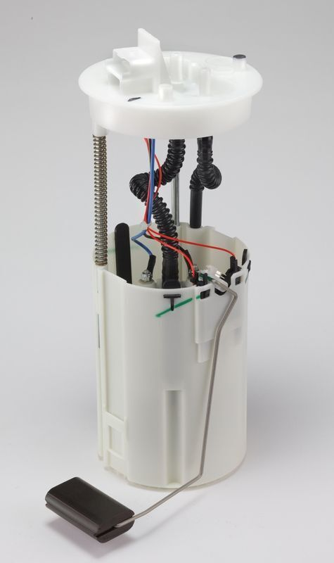

I am guessing you have a low pressure fuel pump in the tank, normally when you turn the ignition on you will hear a slight whine as the pump builds up pressure to deliver to the high pressure pump on the engine via a fuel filter.
If you are not hearing this noise I would check the fuses and relay related to this. If you have power there then the pump in the tank, usually held down by a large plastic nut would be my next thing to check. It works as the fuel gauge sensor and the low pressure pump is in it also.:)

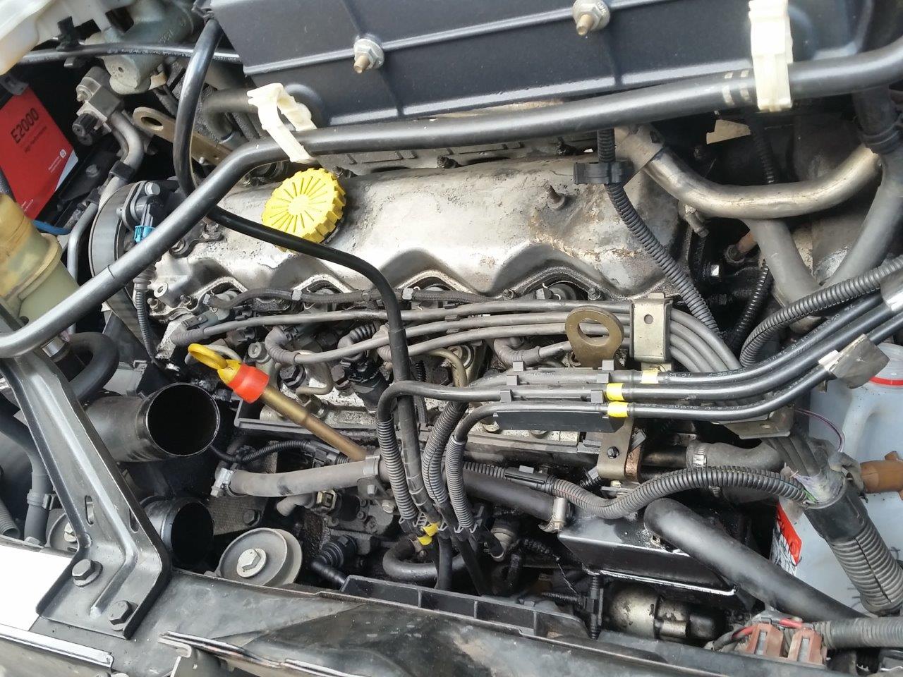

As @bugsymike has already posted a photo of a 2.8jtd, I will attach a photo of a 2.8jtd which has had some of the pipework and engine cover removed. In particular note the four injector cables in a clamp, immediately to the rear of the vehicle LHS engine lifting lug.
To enlarge on the questions regarding the engine model, the 2.8jtd was introduced in 2000, but due to the delays in motorhome conversion, and registration it is quite possible for a 2001 motorhome to be fitted with the earlier 2.8idTD engine.
