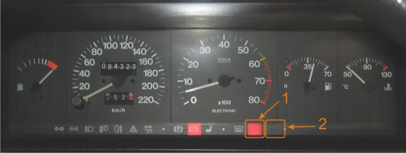

FIAT Croma i.e., 1995 ccm, 88 kW (120 HP), year 1988., engine ID 154C000.
First of all I must say that I have visited many mechanics in my town (Leskovac, Serbia) and nobody can tell me whats wrong.
Questions:
  1. What is meaning of red light blinking on instrument panel about half minute upon car ignition and after that continualy lighting (I have marked that with number 1 on picture)? Besides that I am curious what meaning have yellow light (not lighting in my case) that I marked with number 2 on picture (if it is important on check panel is always blinking LED for door closing)?
  2. If the engine is cold, upon starting I must hold foot on gas pedal for about few seconds on about 2000 RPMs otherwise car will shut down. After that I see that idle control valve is doing his function and keep engine running on 1000 RPMs. When the engine is worm I do not have this problem. What could be cause?
