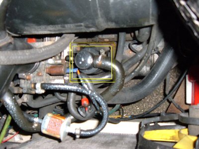

Hi there.. in case you are still looking for the Oil Filler ! it is the one at the back of the engine by bulkhead just pull out the black plastic breater.. You will need a funnel with long flexiable tube ! I bought one from Halfords and have recently given my 92 Fiat Ducato 2.0L Petrol an oil change and new filter. Cheers Teckie (y)
Picture of cap attached; if it is as stiff as mine the top will need levering off with a screwdriver
