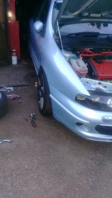

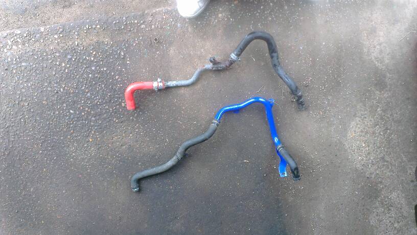

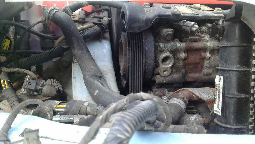

Hade to replace the front coolant hose as I finally found the cause of the overheating
And my crappy headlights
The headlight was crushing the water hose restricting the water supply
So replaced the coupe hose which is a lot longer with the shorter Bravo hose from my marea 155
Took the car for a long drive and temp never goes above half way and didn't have to touch the fan

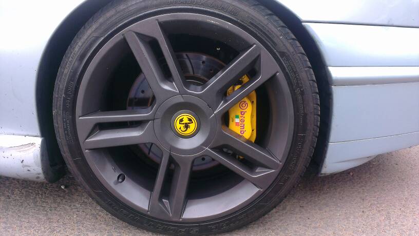

Just sent my stilo blades to be refurbed in anthracite with new wheel centres will look awesome when they come back.
20mm hubcentric spacers also ordered

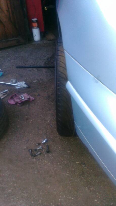

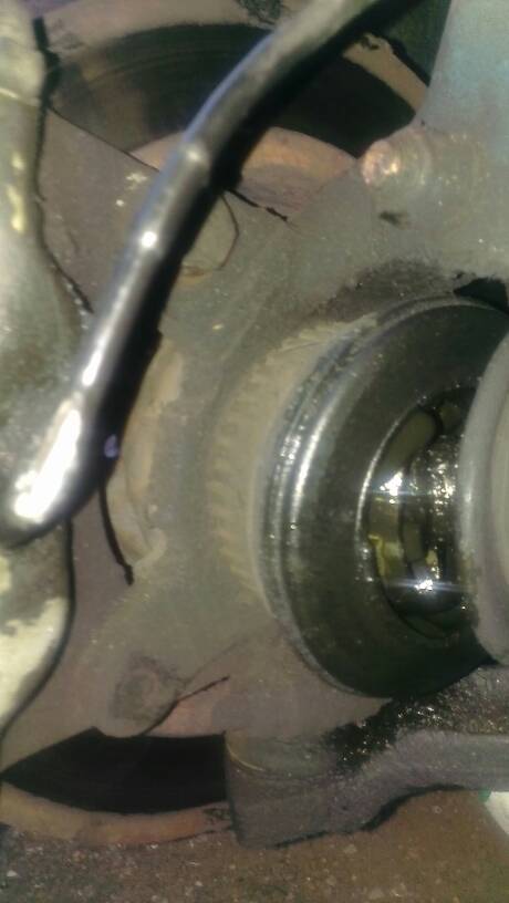

Well after doing the wheels I found yet another problem with the Bravo
Torn CV boots. :banghead:
Well that 2 new genuine fiat coupe CV boots ordered
And will need new calipers next month
As the bottom bolt had sheared of
