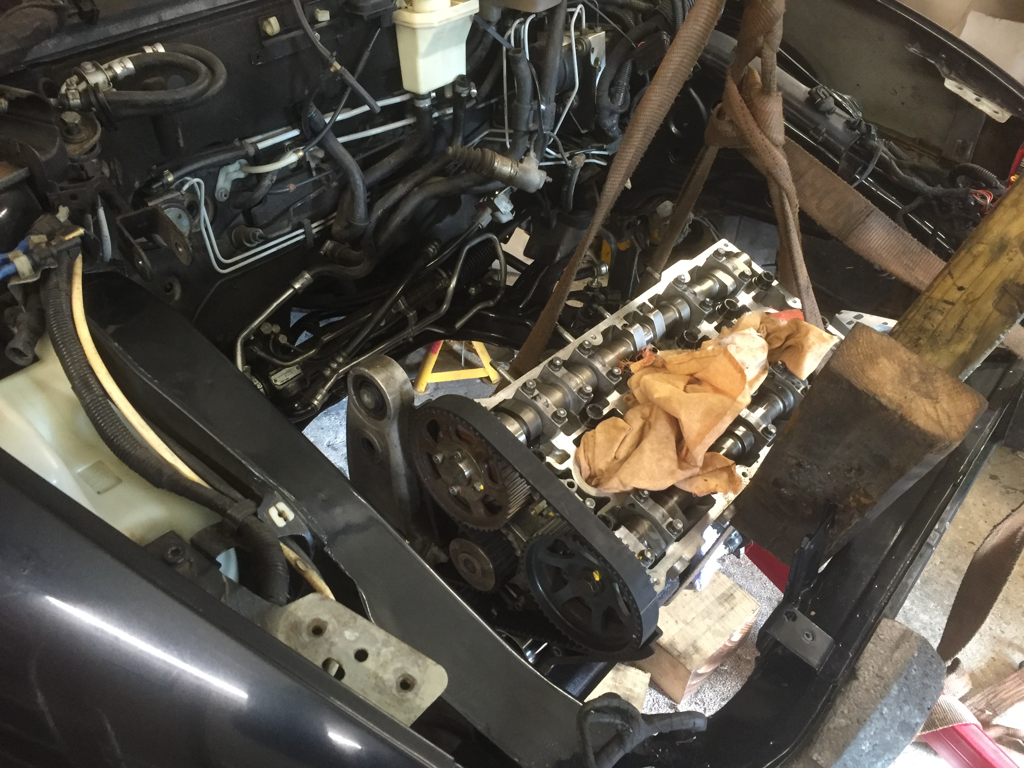

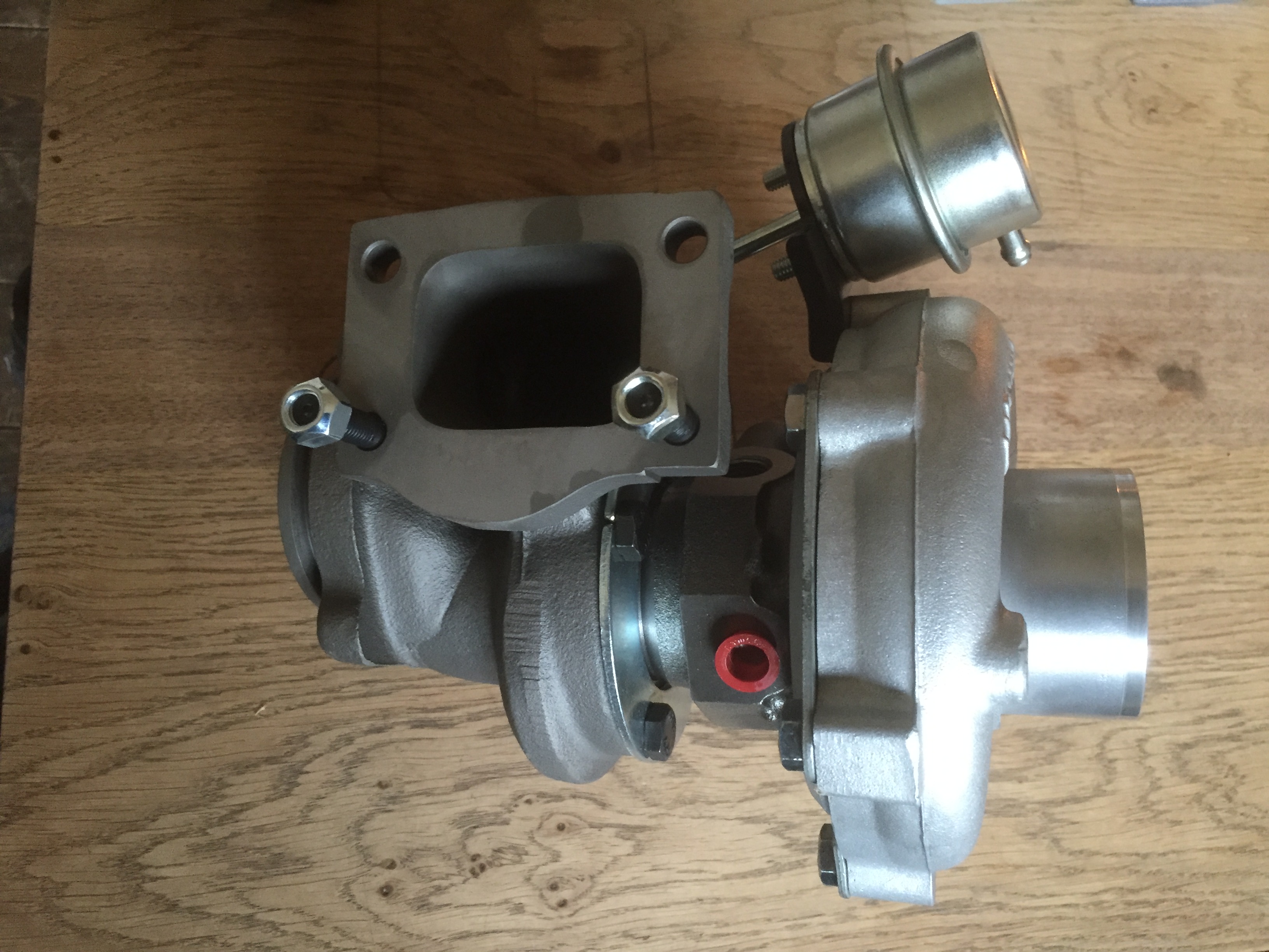

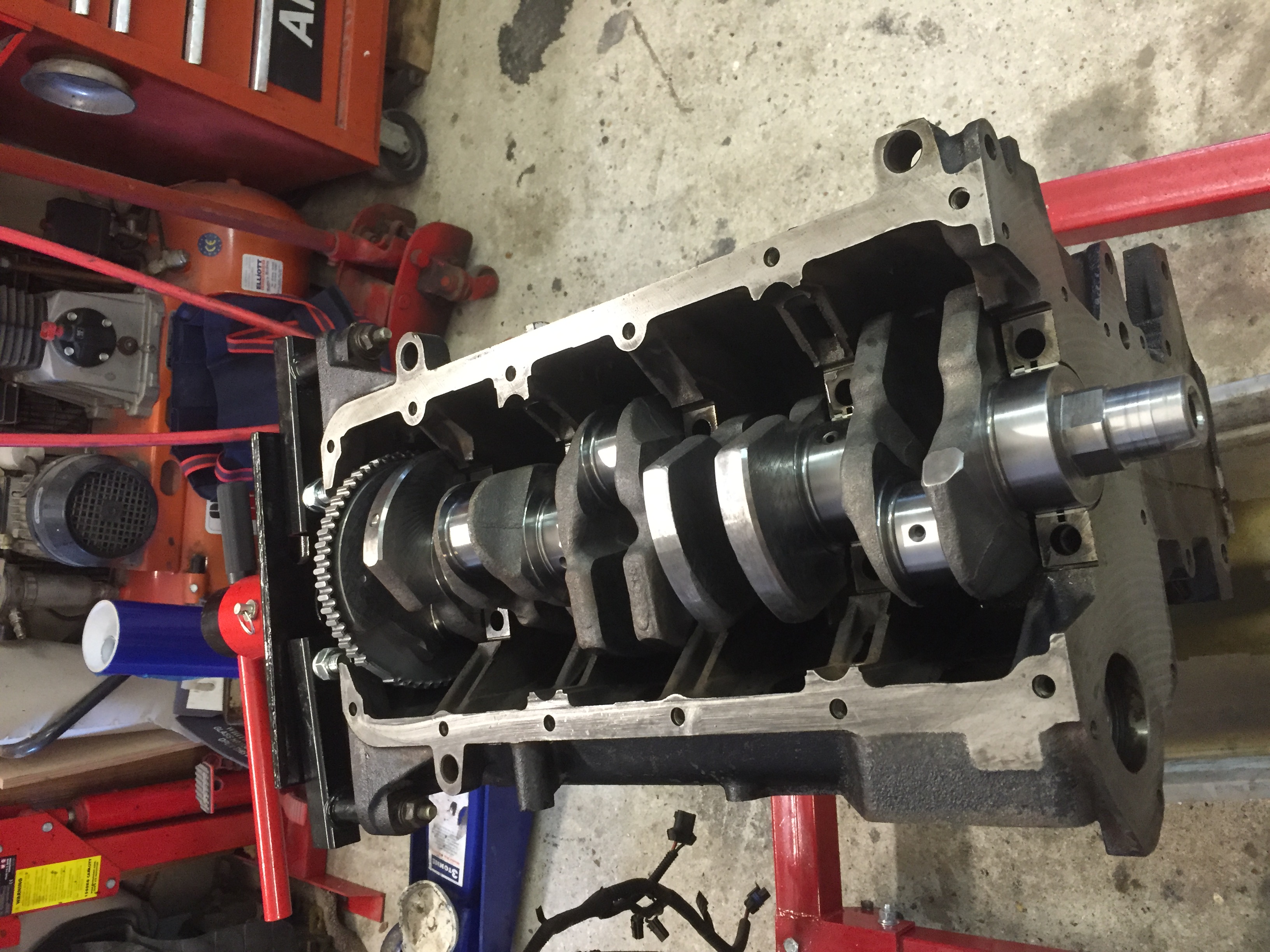

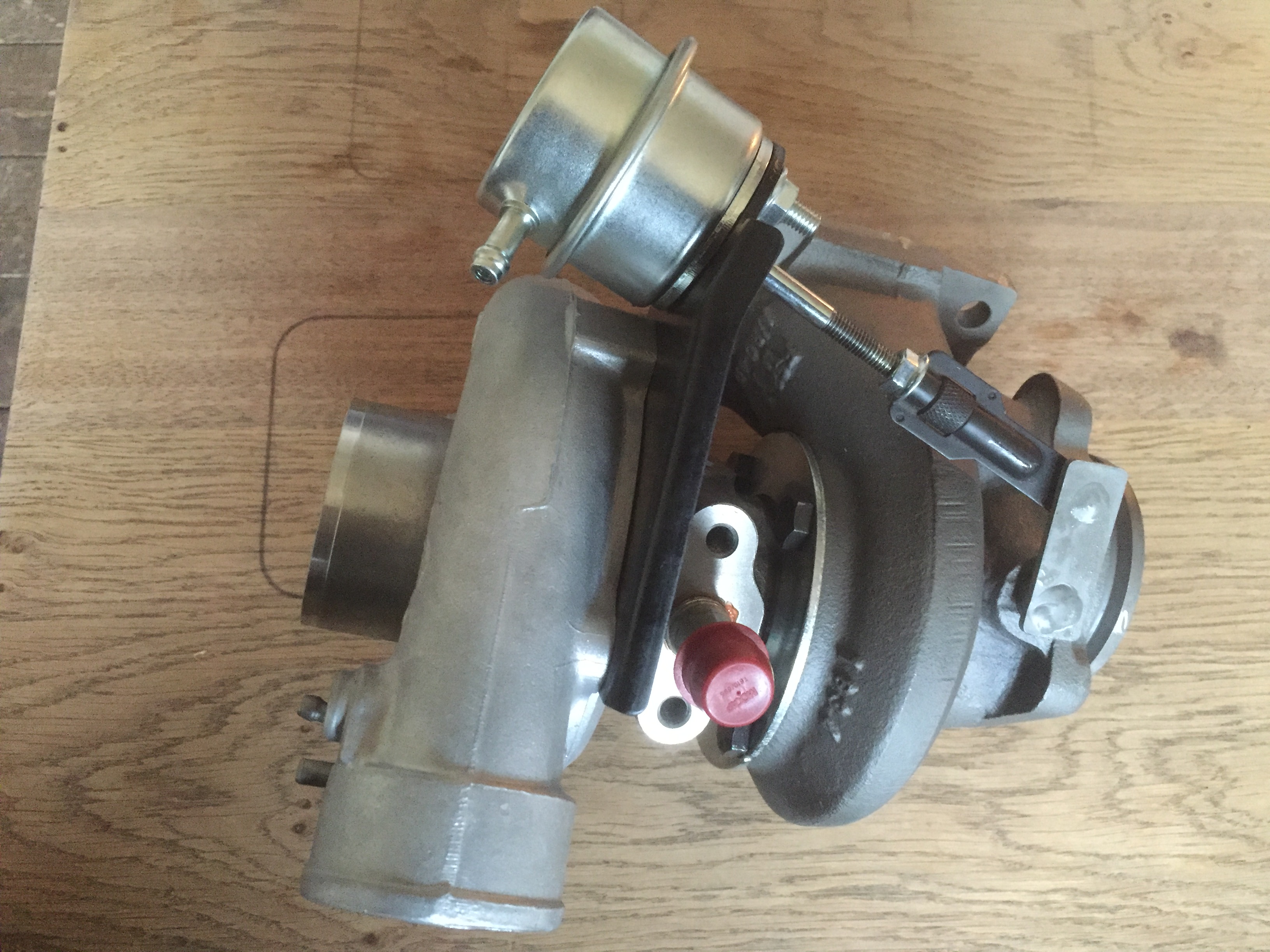

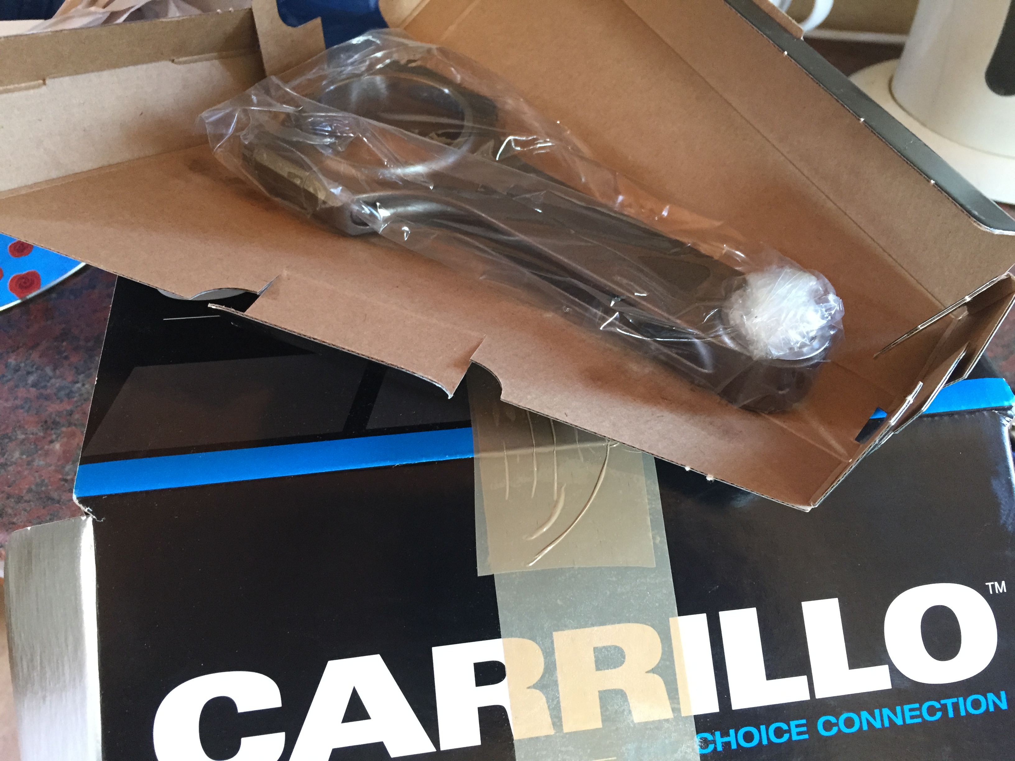

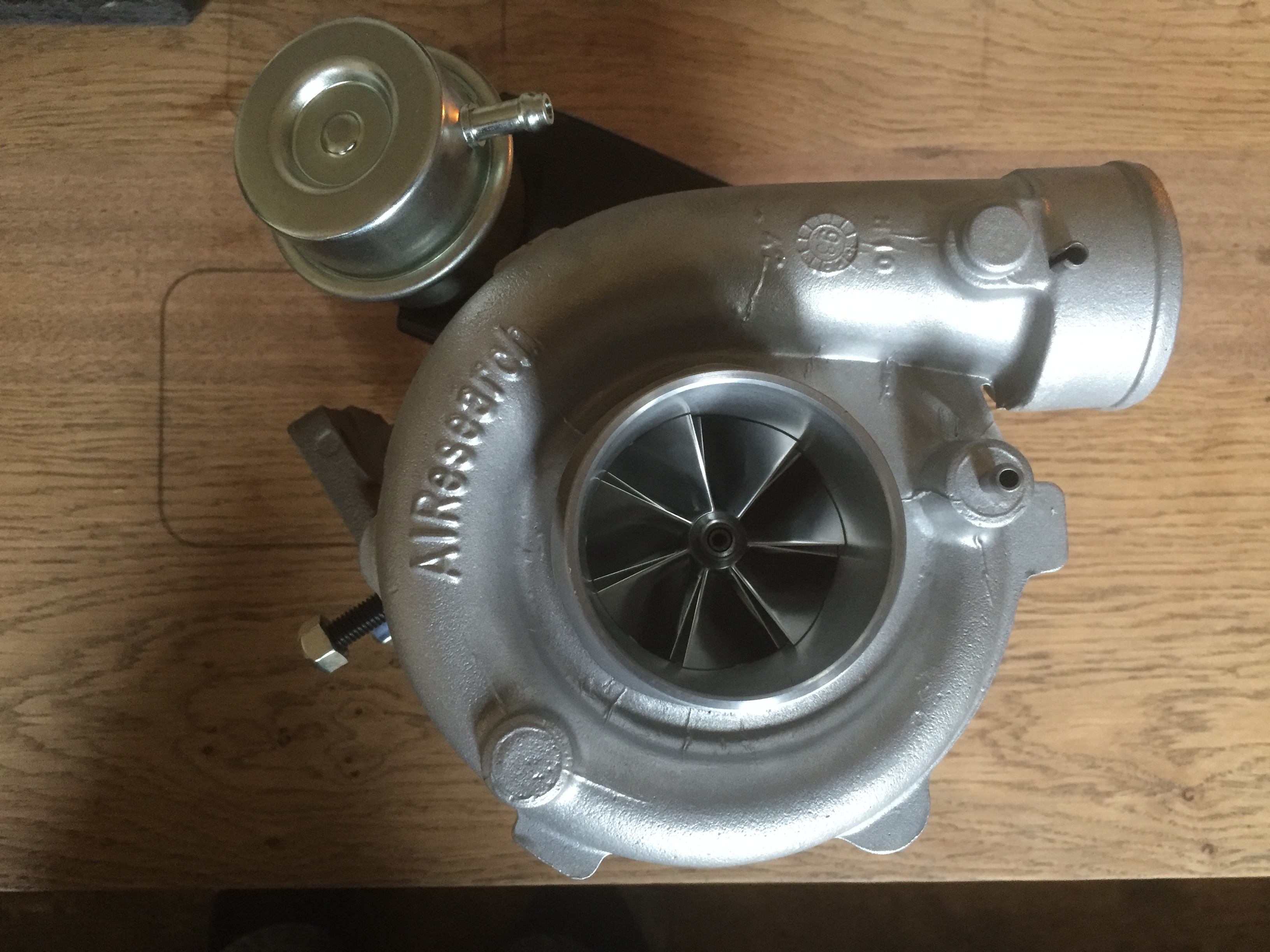

These turned up at the beginning of the week, nearly ready to start the rebuild now.:)

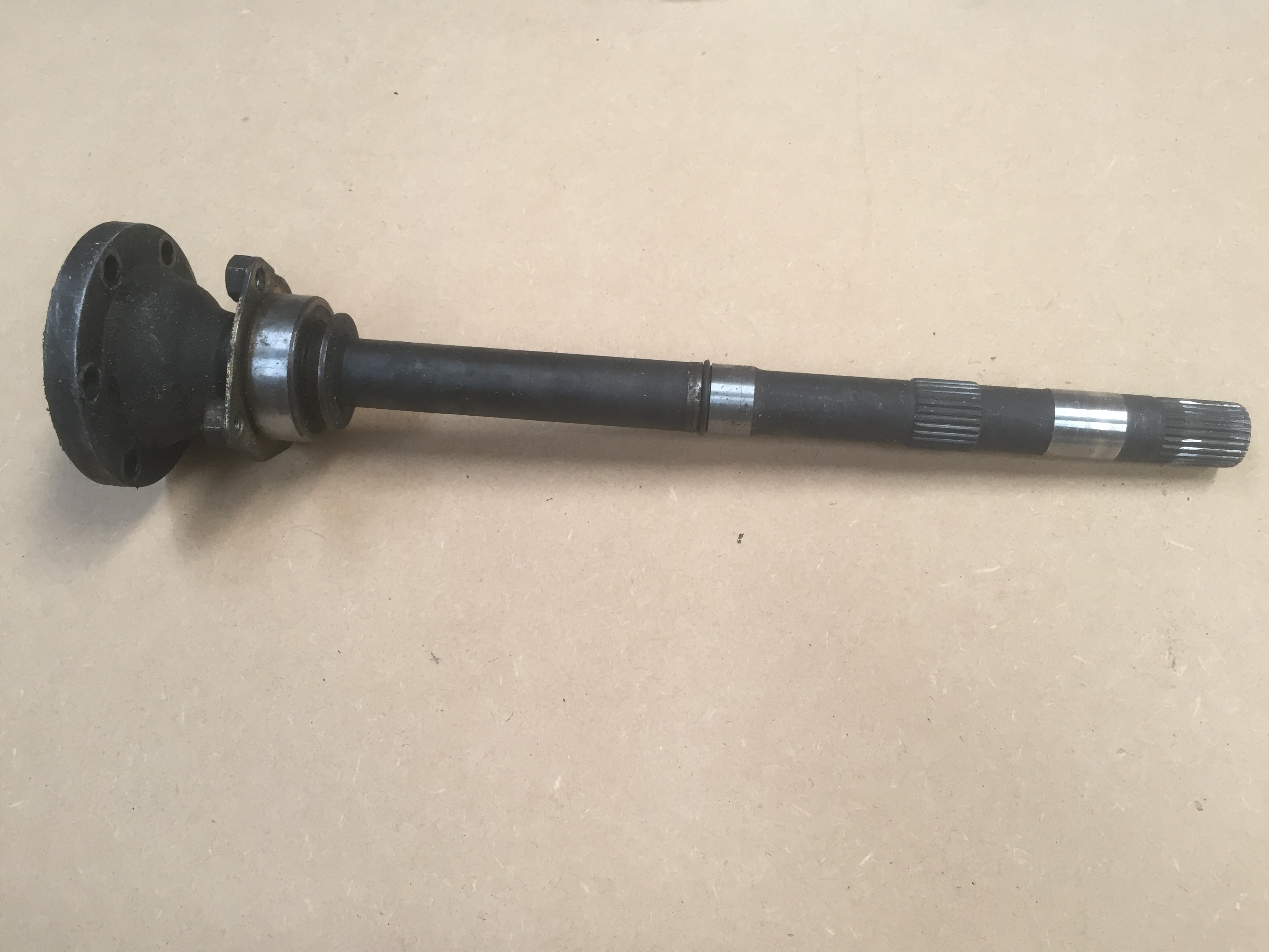

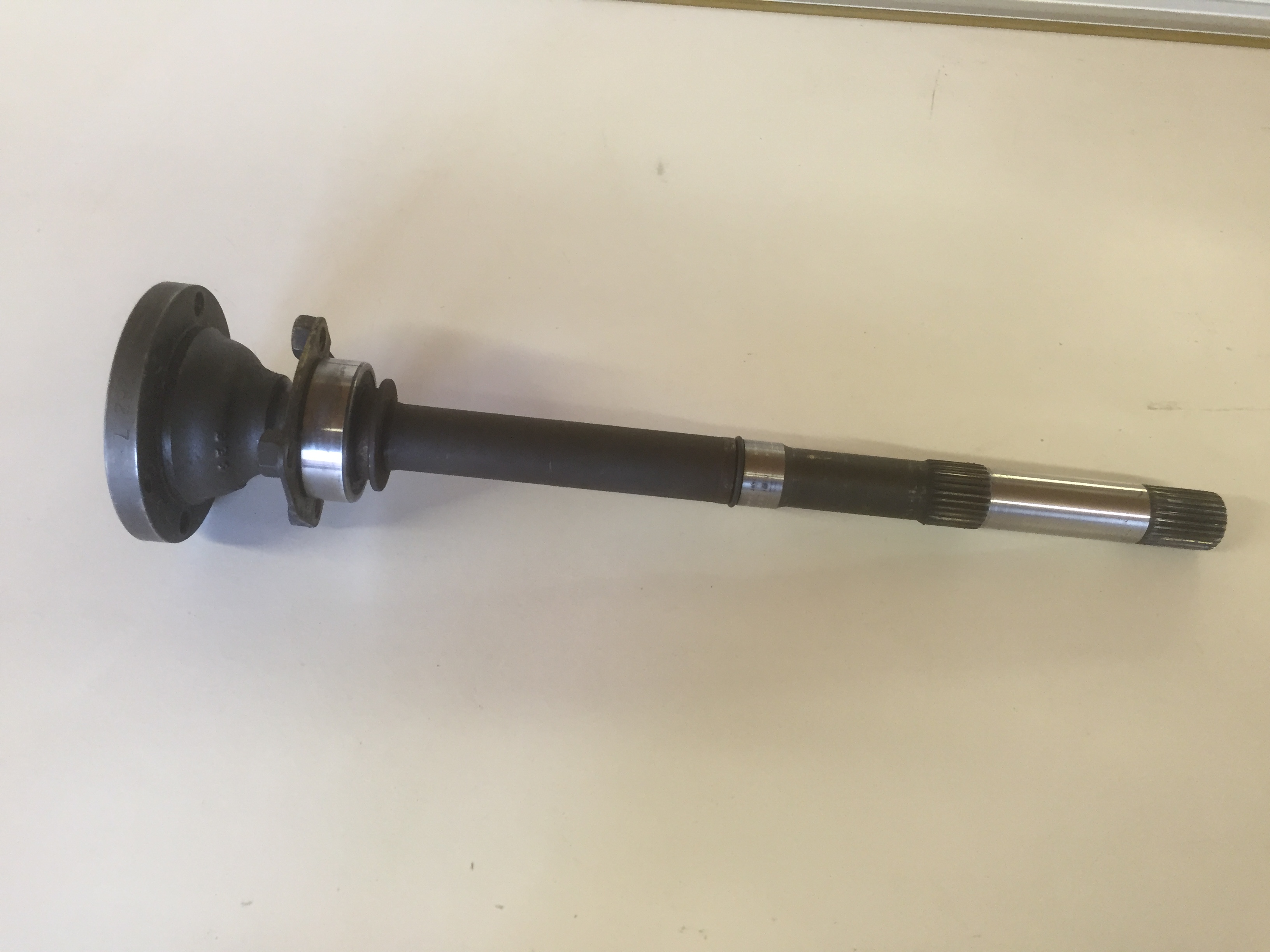

The Diff is now fitted in the gearbox. I have machined the inner driveshaft to seal nicely with the GTA gearbox cover plate and custom seal. I have also purchased an uprated vibratechnics gearbox mount (the other 2 engine mounts were uprated to vibratechnics previously)

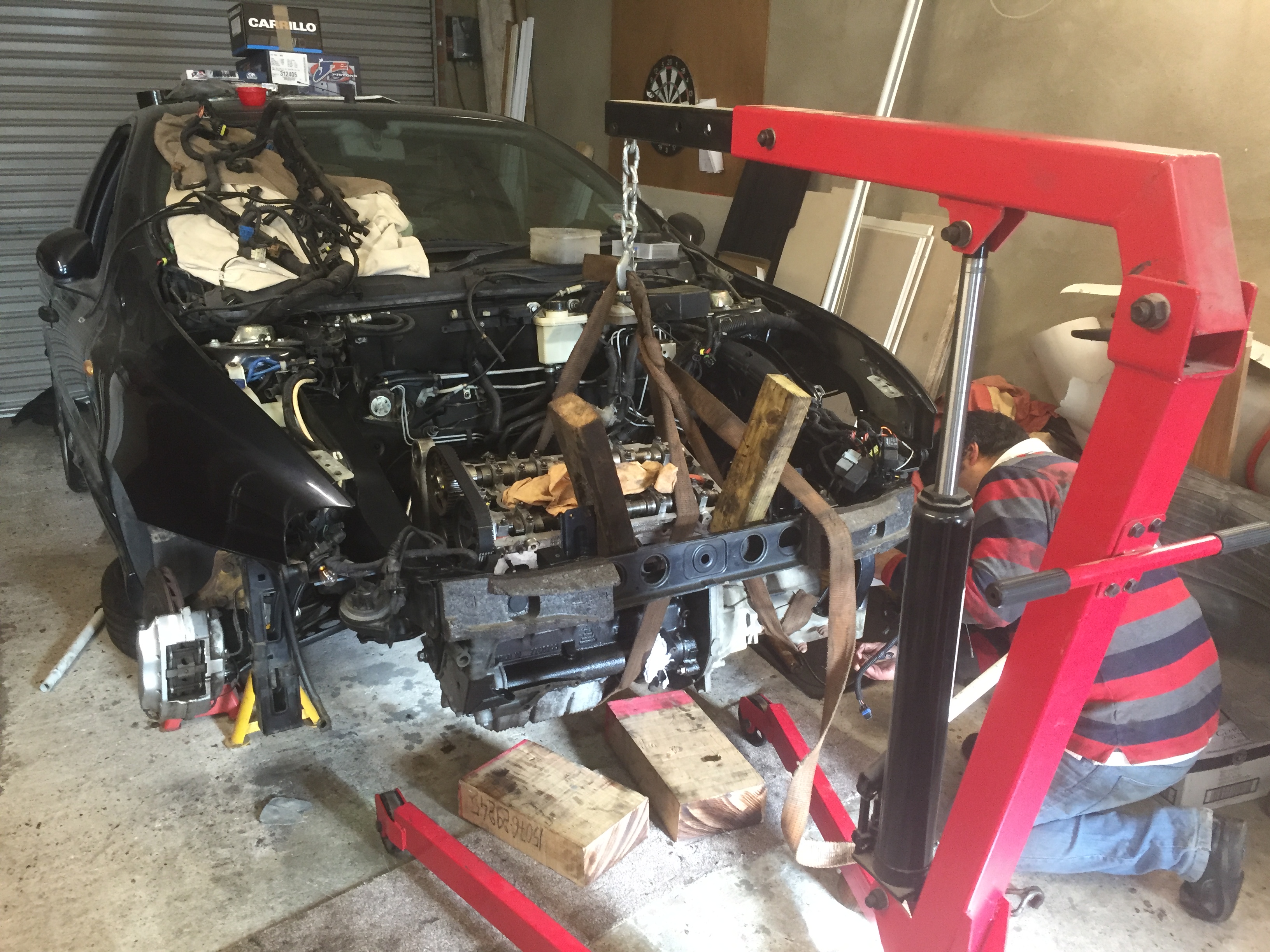

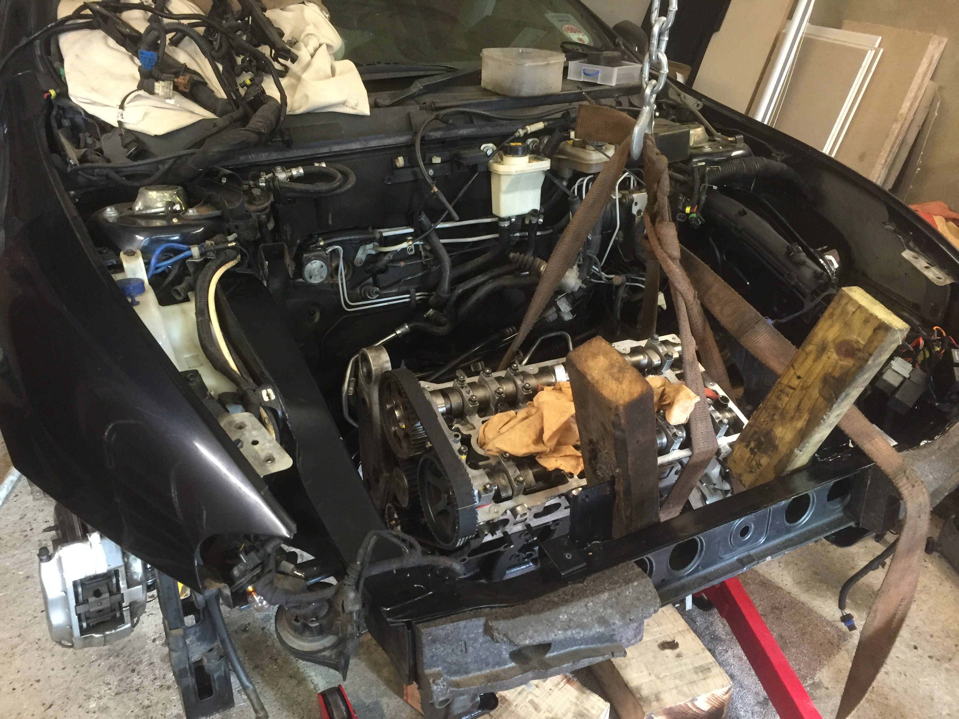

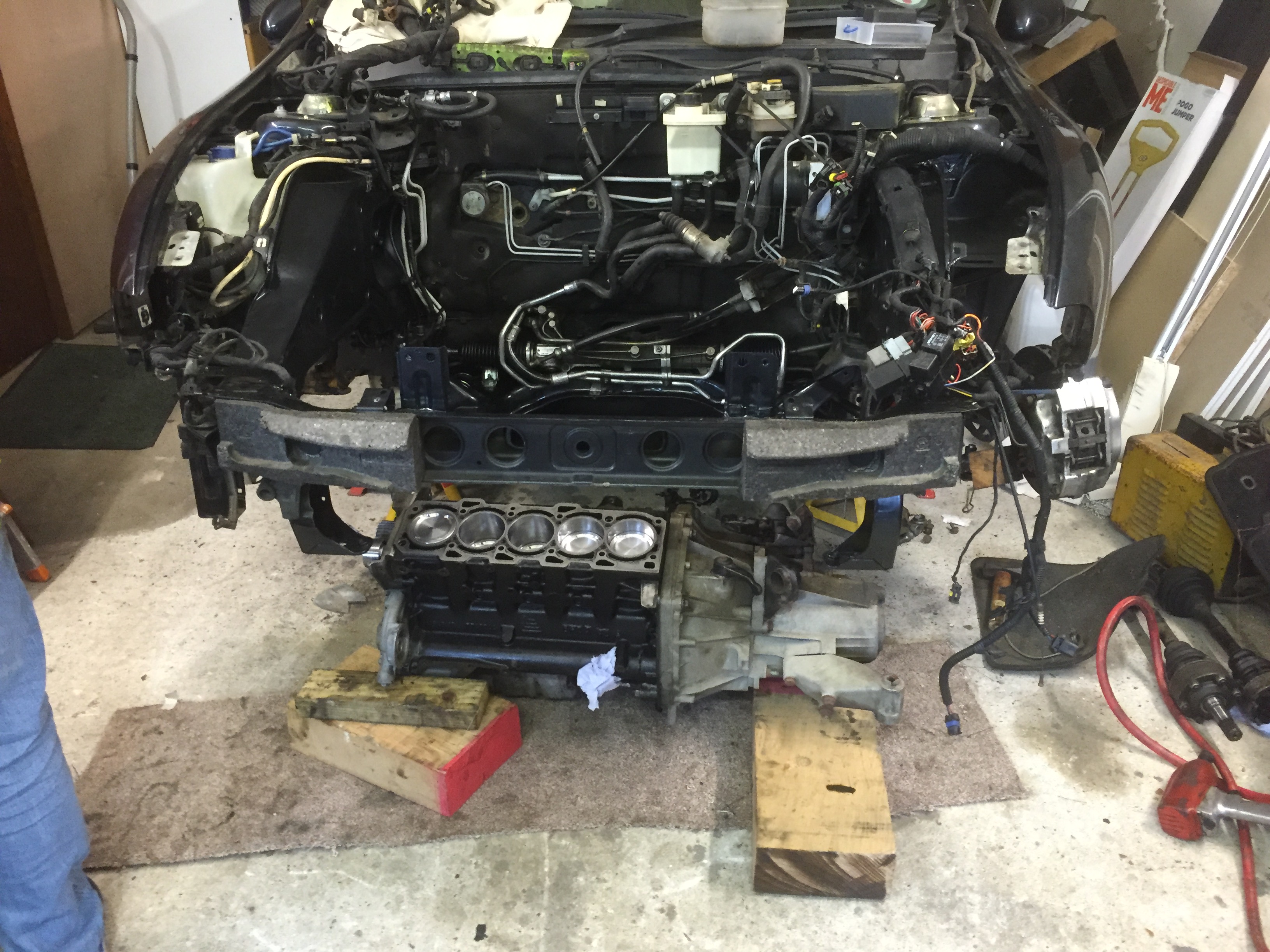

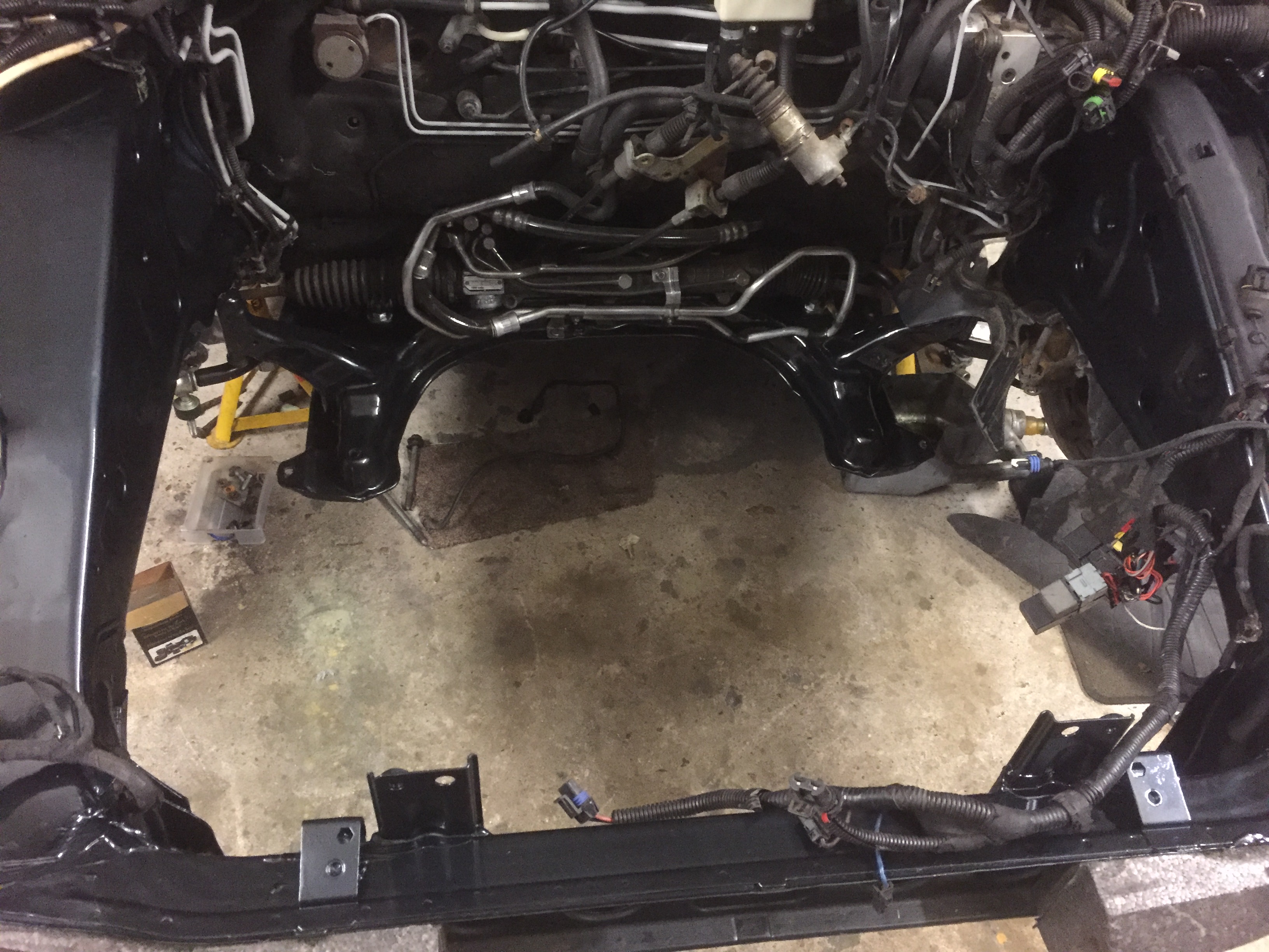

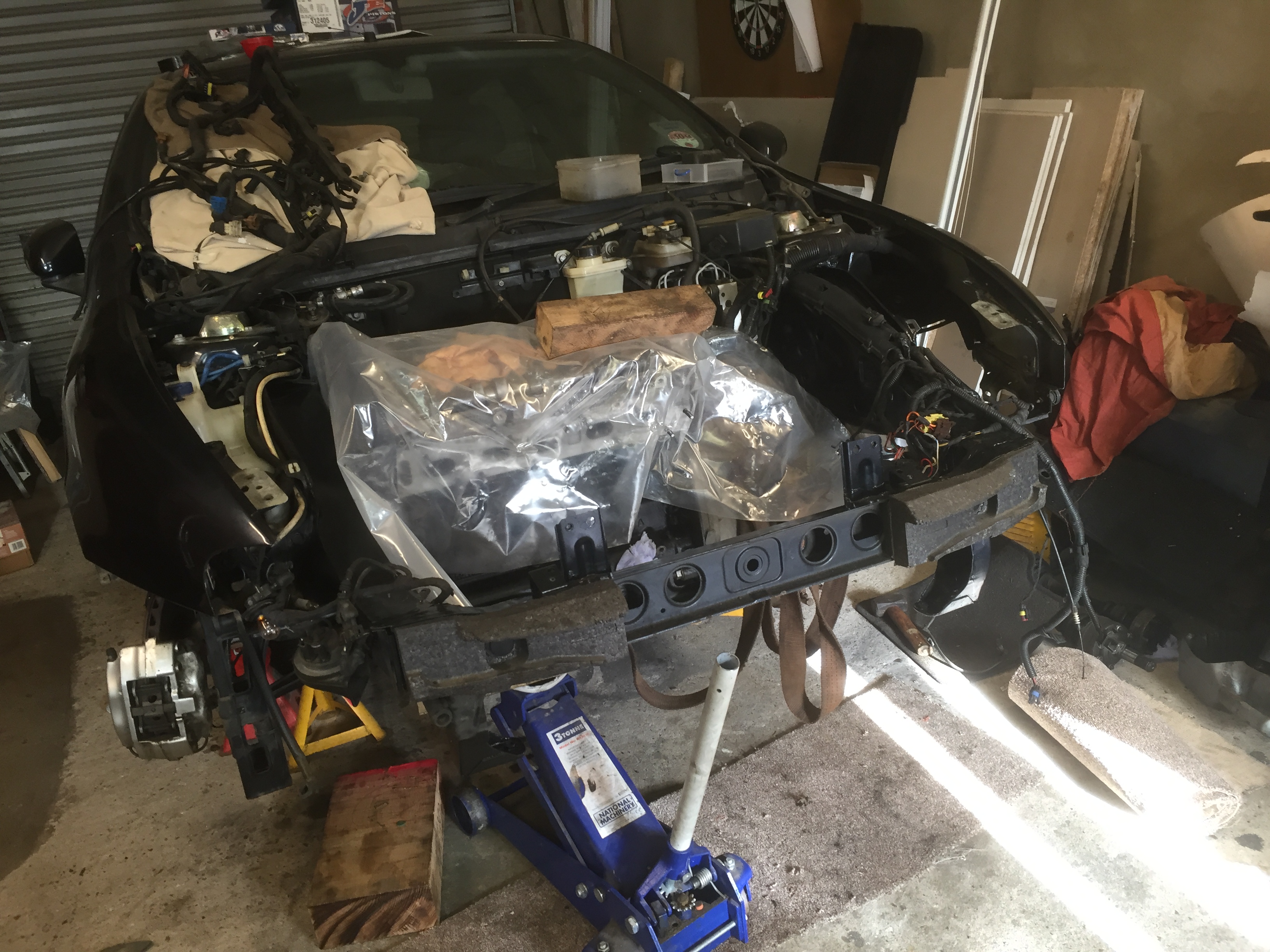

The engine bay was prepared, ready for the engine installation.
Subframe was seam welded, had a metallisation coating and then powder coated.
Black powerflex bushes are fitted to the new anti roll bar, drop links and suspension arms.
The steering rack needed new gators, so we fitted new track rods and ends.
