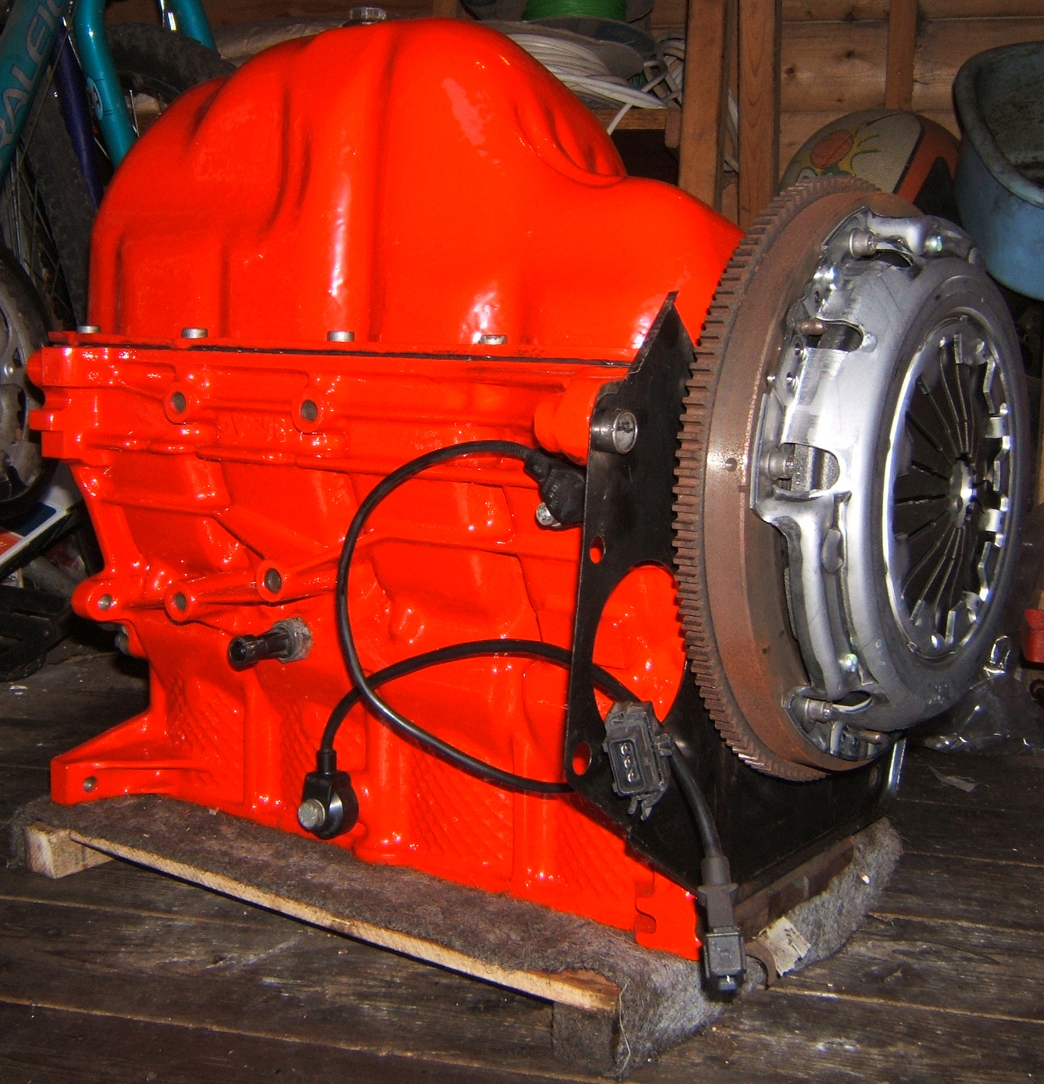

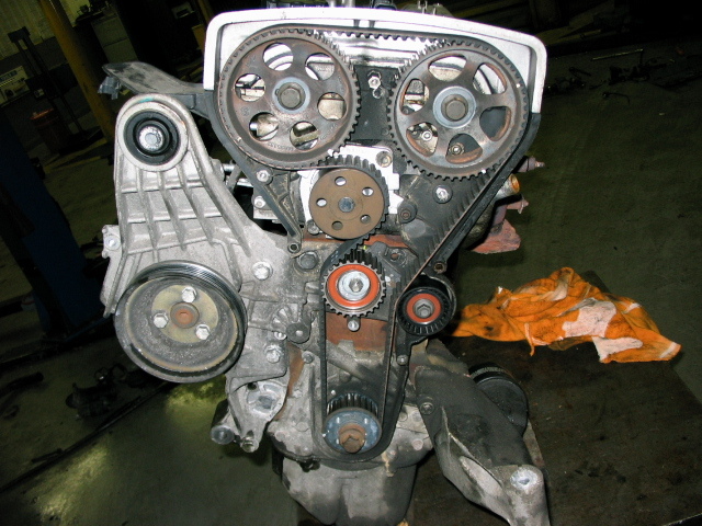

There is a cam shaft sensor on the exhaust camshaft sprocket behind the sprocket.
And a crankshaft sensor that reads a phonic wheel inside the block of the engine. The sensor is just under the starter motor on the flywheel end of the engine.
I have been told by two respected member's here that you have to take the exhaust sprocket off if you want to change the cam shaft sensor. But I have never done the job myself. I have changed the crankshaft sensor before which is very easy with the right access. just watch out for loosing an O-ring in the hole on the block or binning it with the old sensor.
Is it defiantly the cam sensor you need to change rather than the crank? Its very rare we get posts about people changing cam sensors but crank sensors are often know to produced intermittent starting for people that have posted before.

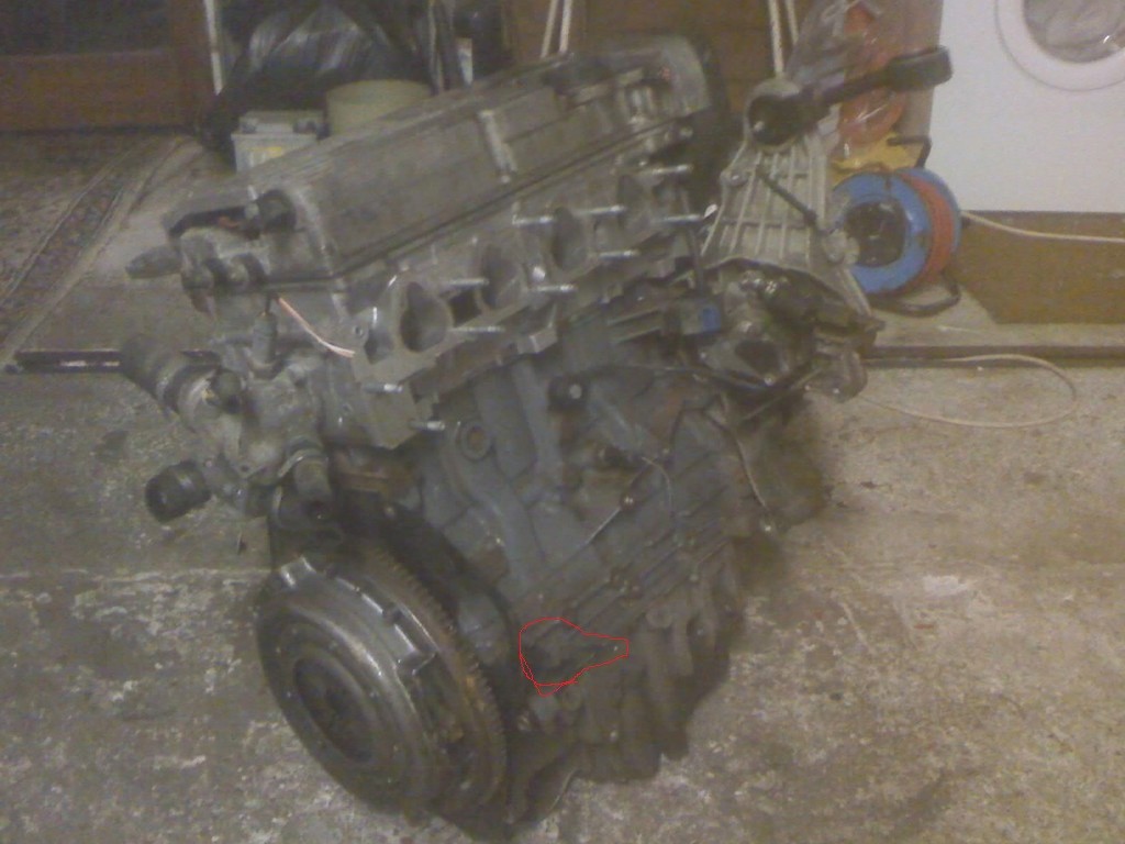

When I changed a crank sensor the engine was out of the car, but I would attempt it from underneath first. I cant imagine getting access from above because of the starter motor and the air intake. In this blurry picture from TheSultan you can just make out the sensor.
