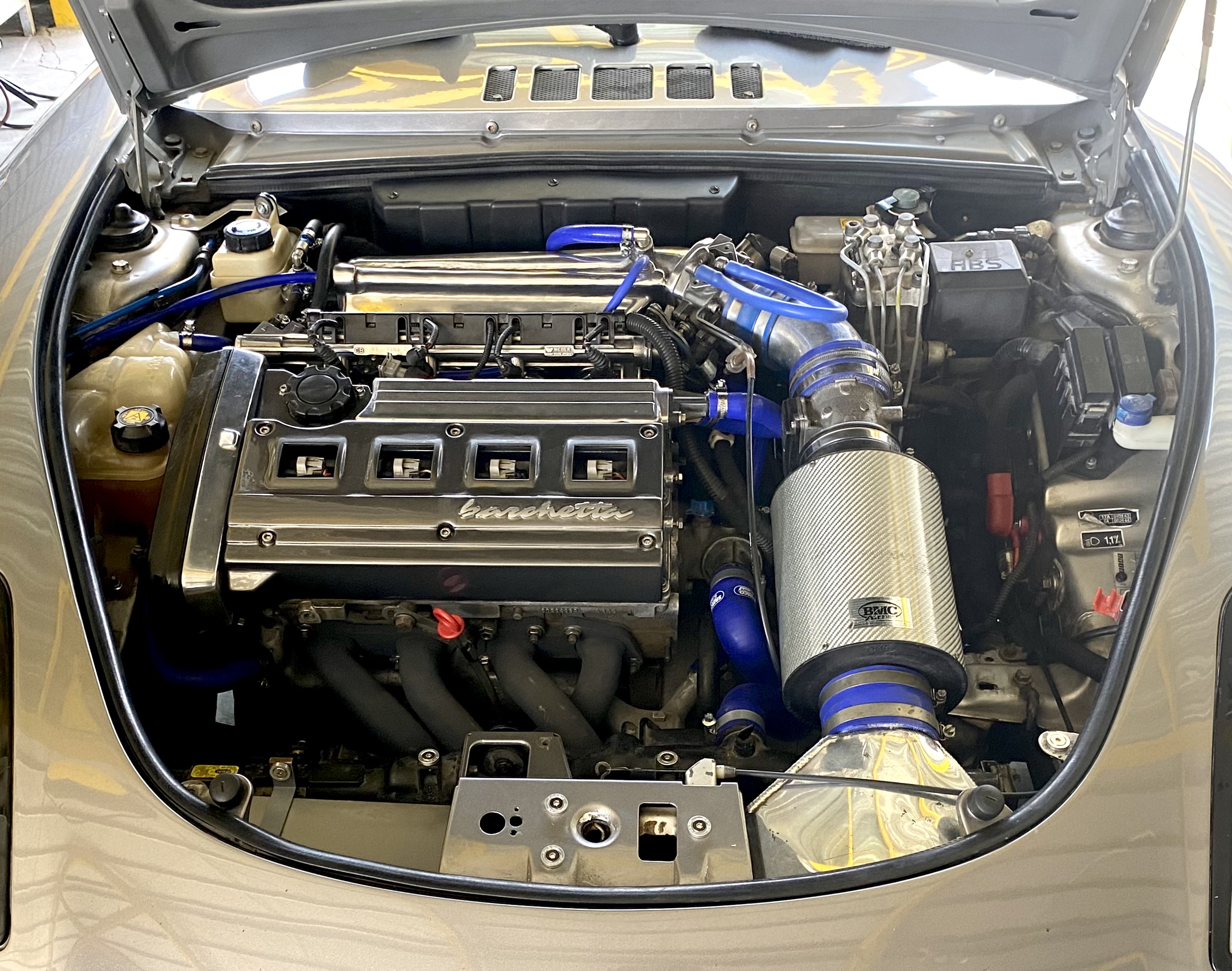

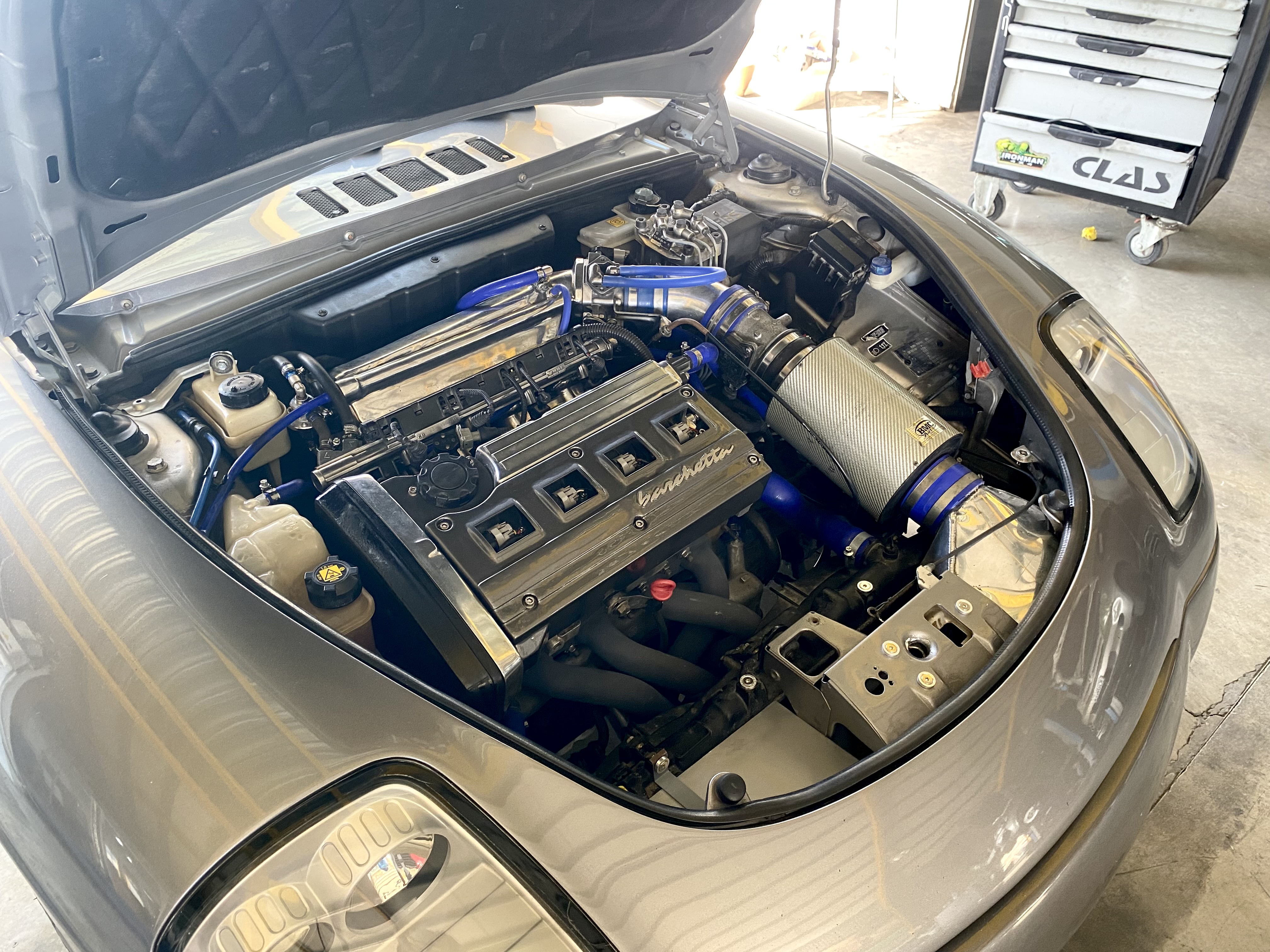

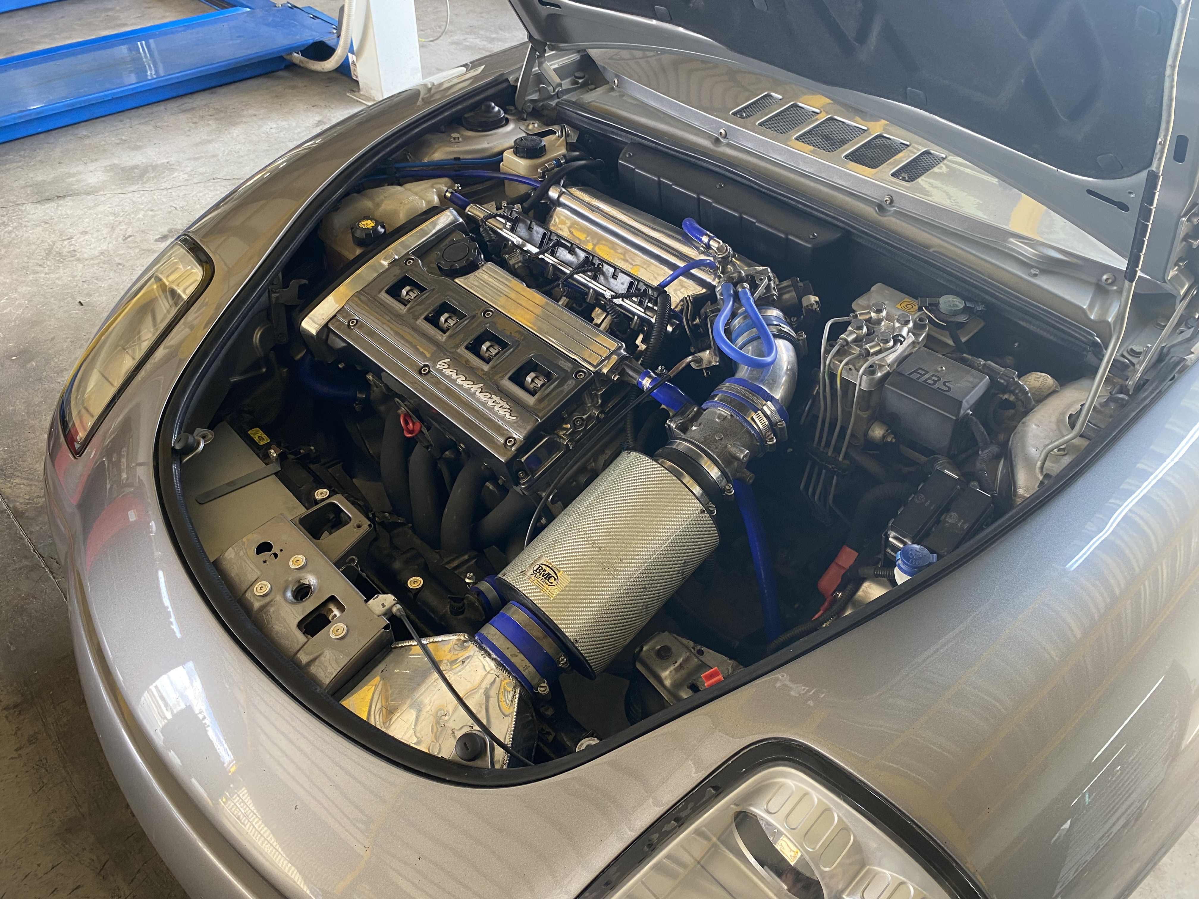

One off made ram intake system, bored polished throttle body , uprated high performance fuel pump and regulator, supersprint complete system, ceramic coated manifold .
4kg lightened flywheel , ported polished head to stage three with 2.0 ltr Alfa JTS . Remap , performance chip on hitachi EcU .
Expected 165-170 bhp

I Will been Soon ported and polish head, worth It? Have now 2.0 ts cams but gonna replace it for the 2.0 jts.
What chip do you use for the ecu?
Remap Will not work because ecu reset itself after programming
Hiya, I have replaced the chip in Hitachi ECU , it’s a plug in / out type . You read , remove and tune and replace .
Now I have recently done further modifications, I may add a piggy back to be able to tune better air and fuel. Will see soon when I have tested on the road .
