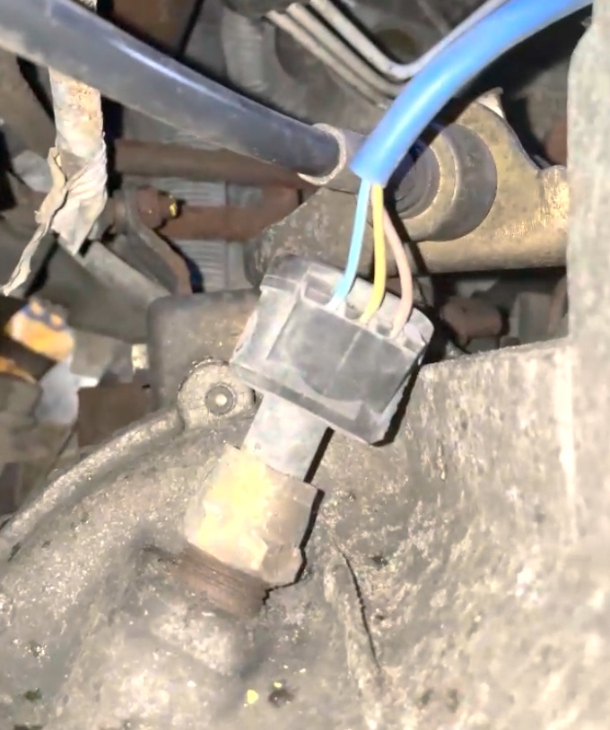

Thank you for the response. I did take the speedometer to an old tv/radio guy, who checked over the soldering. Could not see anything wrong on the solderings. I also tried to put some voltage and MilliAmps straight on the pins on the speedneedle, circuitboard pins that is. This made the needle move, more milliamps made the needle go higher. This means that some parts are working.
The sensor I removed looked like picture 1.

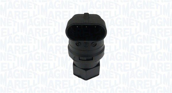

The sensor was replaced by this: Picture 2.

At the same time, what is the difference? Could this work on mine? 46817374? I used AutoDoc to get the speed sensor part 46817374.
When I tried the new part, it would give me a voltage between 0-8 volt. That would give me a puls, but not sure what is the correct one. Then I tought it might just be the sensor type that is not working correct, or giving the right type of signal.

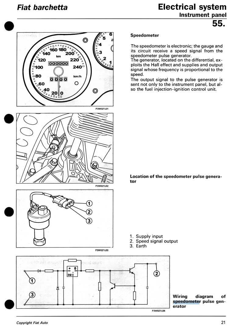

The service manual outlines some of the detail on the sensor:

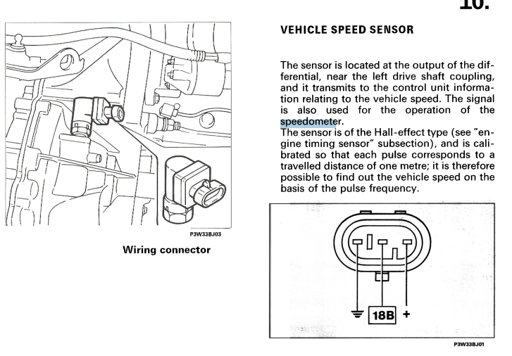

The 1998 update to the service manual gives some detail on how the speed sensor works:
Given that is pulses rather than a voltage you may need a scope rather than a meter to test it.

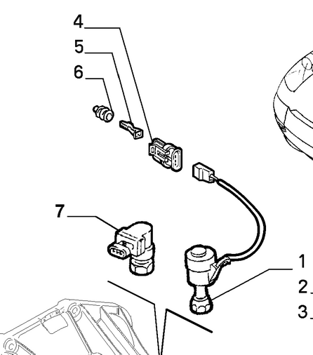

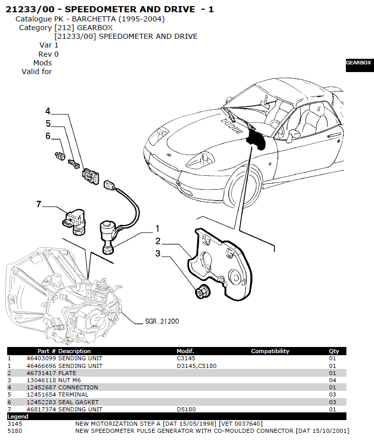

Out of interest the change between the two parts is how the connector is attached to the sensor. You can see the two different versions in the manual pages I posted earlier and in ePer (part 1 is the older sensor, part 7 the newer one) :
ePer describes the change 5180 that brought in the new version as "NEW SPEEDOMETER PULSE GENERATOR WITH CO-MOULDED CONNECTOR (DAT 15/10/2001)" which describes the change well. The sensor went from having a small tail wire with the connector on the end to having the connector moulded on to the sensor. I suspect the operation of the two sensors is identical and that it is just how the connector is attached that has changed. Both manual sections state it is a hall effect pulse sensor.
