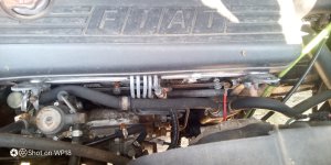

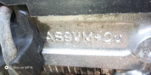

I have a Fiat Arca 1992 and I want to replace the cam belt before I start using it. I know it is a 2500cc non turbo diesel and it has low mileage with only 164000km on it. I can not find the engine number on the engine.
I presume it is either a 8144.67
Or a 8140.27.
Can somebody please help me?

Probably an 8140. But check on Vin plate on bonnet slam panel possibly. Let me know exactly and I may have cambelt fitting details.etc.

There is no vin plate anywhere I can see and NK (not known) on the log book.

In that case the best I can do is this, my 1996 cam belt book only lists the Ducato of that era with the 8144, but I have shown the details of an Iveco Daily of that era with the 8140. Note there may be some subtle differences as Iveco RWD and water pump different as not an engine mount area.

From two sources the 8144.67 is a 2.5D, with indirect injection, while the 8140.27 is a 2.5TD with direct injection.
See https://en.wikipedia.org/wiki/Fiat_Ducato, and here https://motor-car.net/cosworth-engines/1292-iveco-engines/13709-sofim-engine
I only had one indirect injection 2.5, it was in a 1996 Iveco Daily 35/8 (3.5 tonne 80Hp) all the rest were Direct Injection:)
