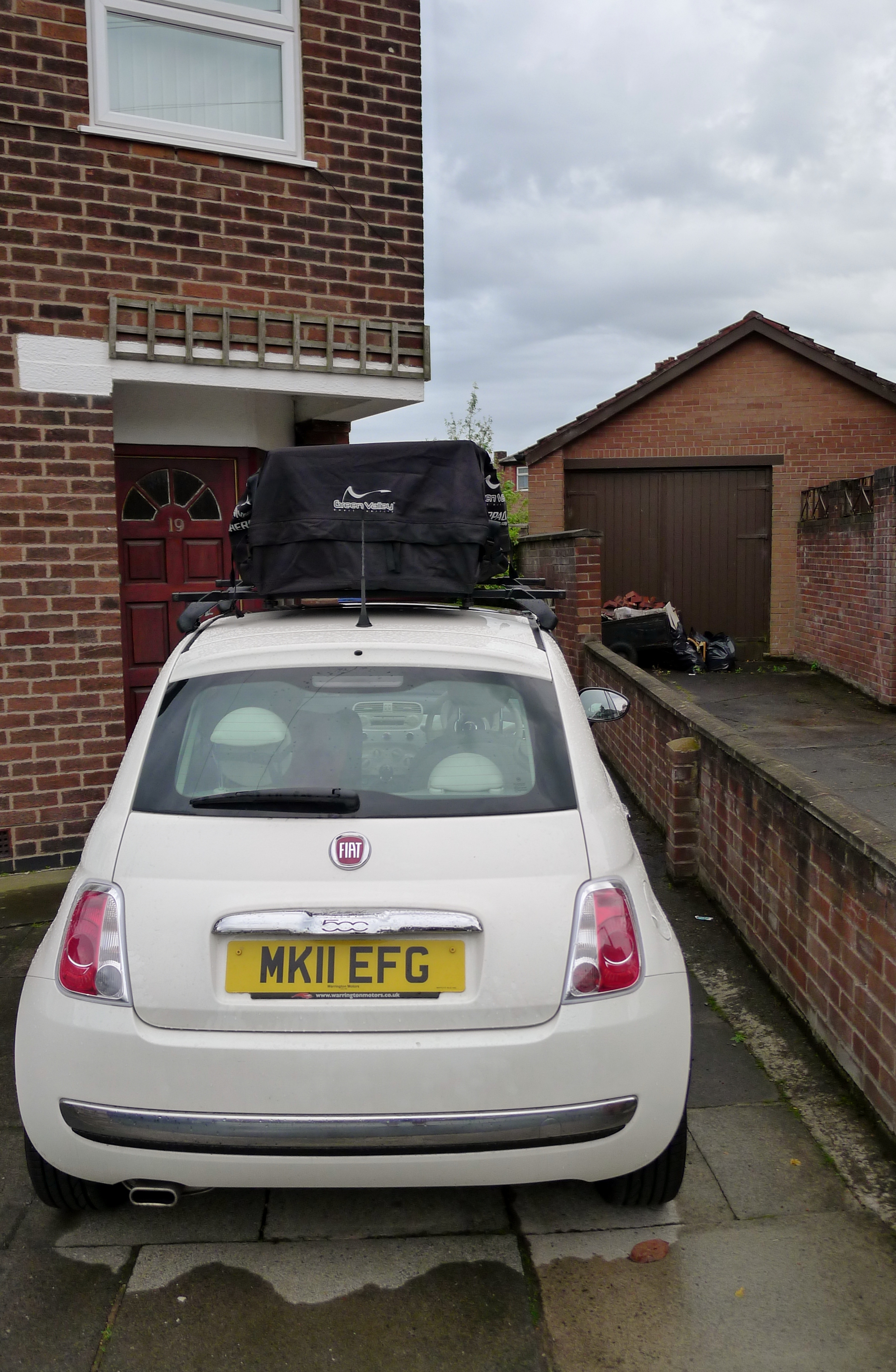

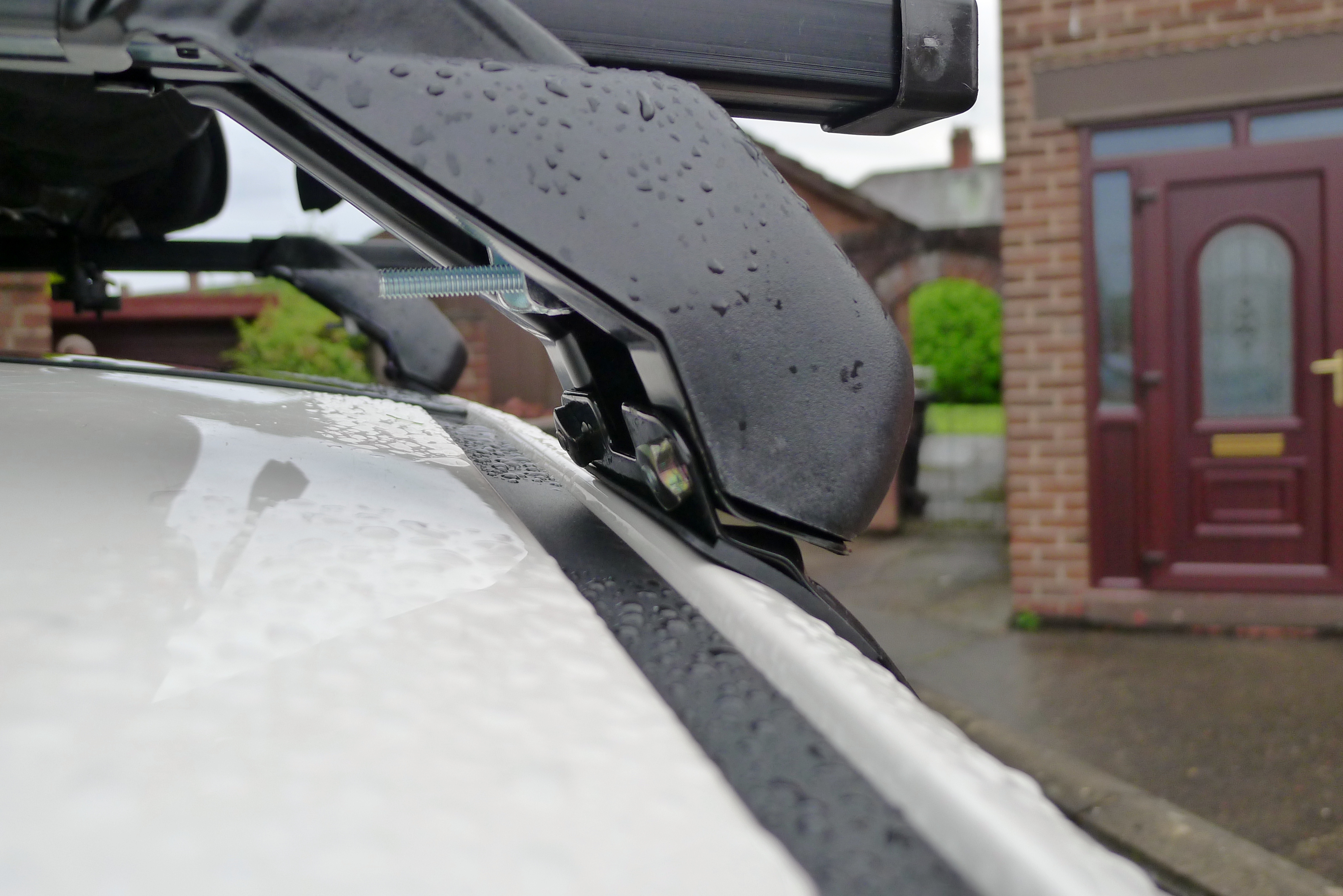

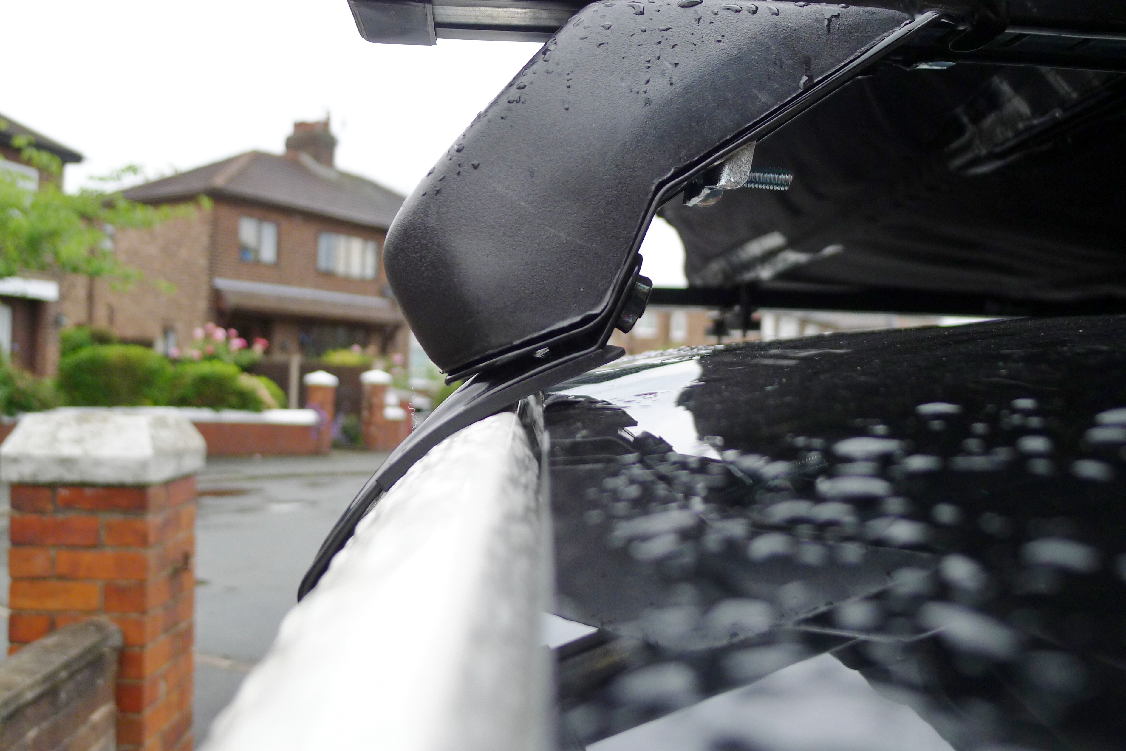

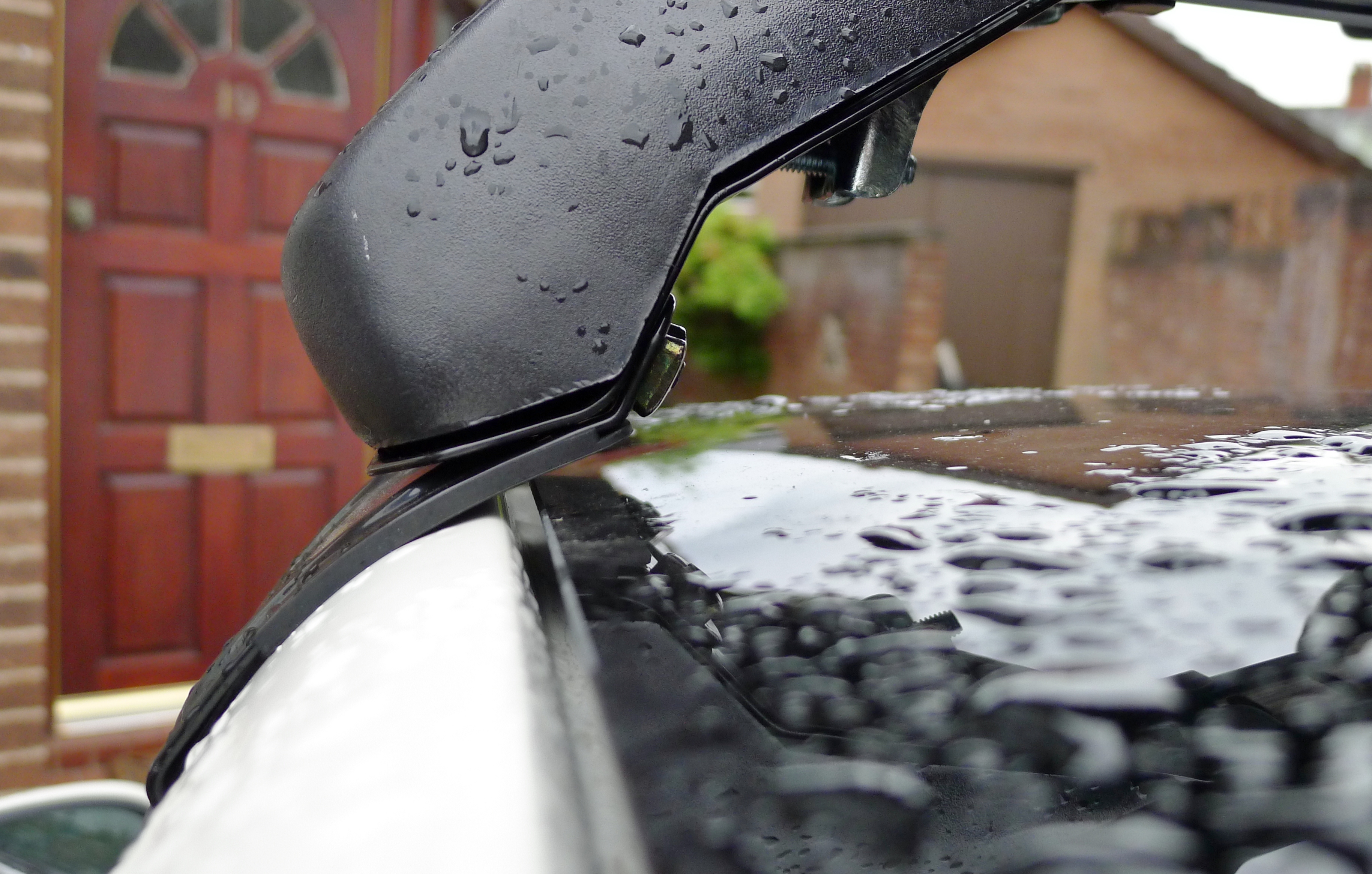

Right, I'm back!
Apologies it's taken so long. Weather has been awesome, but my list of priorities dictated that roof bars were way down the list if there was great weather. And then it crapped it down today, so it seemed appropriate between showers to have a go. I'm quite pleased.
Loads of photos for you to make your own minds up either way.
Hope it's not too overkill.
I'm very pleased with the results. It's a bit early to claim "job's a good 'un", but I think this is as good as it gets for the lounge, and I'd be quite happy to carry 50kg of stuff in the roof pack I have. Of course it's not an aerodynamic roof box that lets an m5 tourer cruise at 130mph on the autobahns, but I feel safe enough tickling 60-70 down to Suffolk next July for a festival with my 10 month old, wife and a dinky car full of gear.
Hope this thread has been of use to somebody at least. Any questions about the whole lot, please feel free to ask.

Thanks Tim for posting all the pics. Noticed that there's a screw used on the first bar with the anchor point at the 'middle' of the door opening.
I had a little think about the 56mpg speed restriction and tried to work out why that speed :confused:. It seems that's the Lorry speed limit restriction so if you on a motorway and you're going as 'fast' as the Lorries - there's less likelyhood of getting 'run off' the motorway.
I would imagine that roof 'bag' will create a lot of drag - would you not splash out and get a decent roof box ? :)
Hi
Yeh, I think the anchor point is to provide a little extra torque resistance, as the front sits quite high. Both bars are very sturdy when I give them a good yank.

A report back after last weekend's camping trip; what this set up was bought for.
Roof bars were simple to affix after doing it once already, 5 minutes max. The soft roof box is a little more tricky as it's quite a manual job turning the plastic thumb tighteners and lining it all up evenly, probably about 10 minutes.
On the roof I fit a 17kg steel frame tent (Vango Calisto 500), a 36l coolbox weighing about 20kg. Then a few lighter things, roll up alu table, camping chair, picnic blanket, folding water carrier, and a bag for life for of camping gear. Total weight about 43kg.
In the car we packed a W60xH30:LOL:36 plastic tub with all the cooking/eating gear and dry foods. Another folding chair, double airbed, small folding table, big bag of clothes for us, and a few odds and sods in the little bits of space left. The lid just about shut :)
Baby girl in the back, buggy (3-way fold Quicksmart Easy Stroller) behind mummy's front seat, collapsible Samsonite bubble cot bed, sleeping bags, blankets duvets and tent carpets all stuffed down next to baby Summer, plus a big bag of her provisions and clothes, and our day bags.
It all just fit perfectly (y). Driving was kept to 65-70, for 2 1/2 - 3 hours

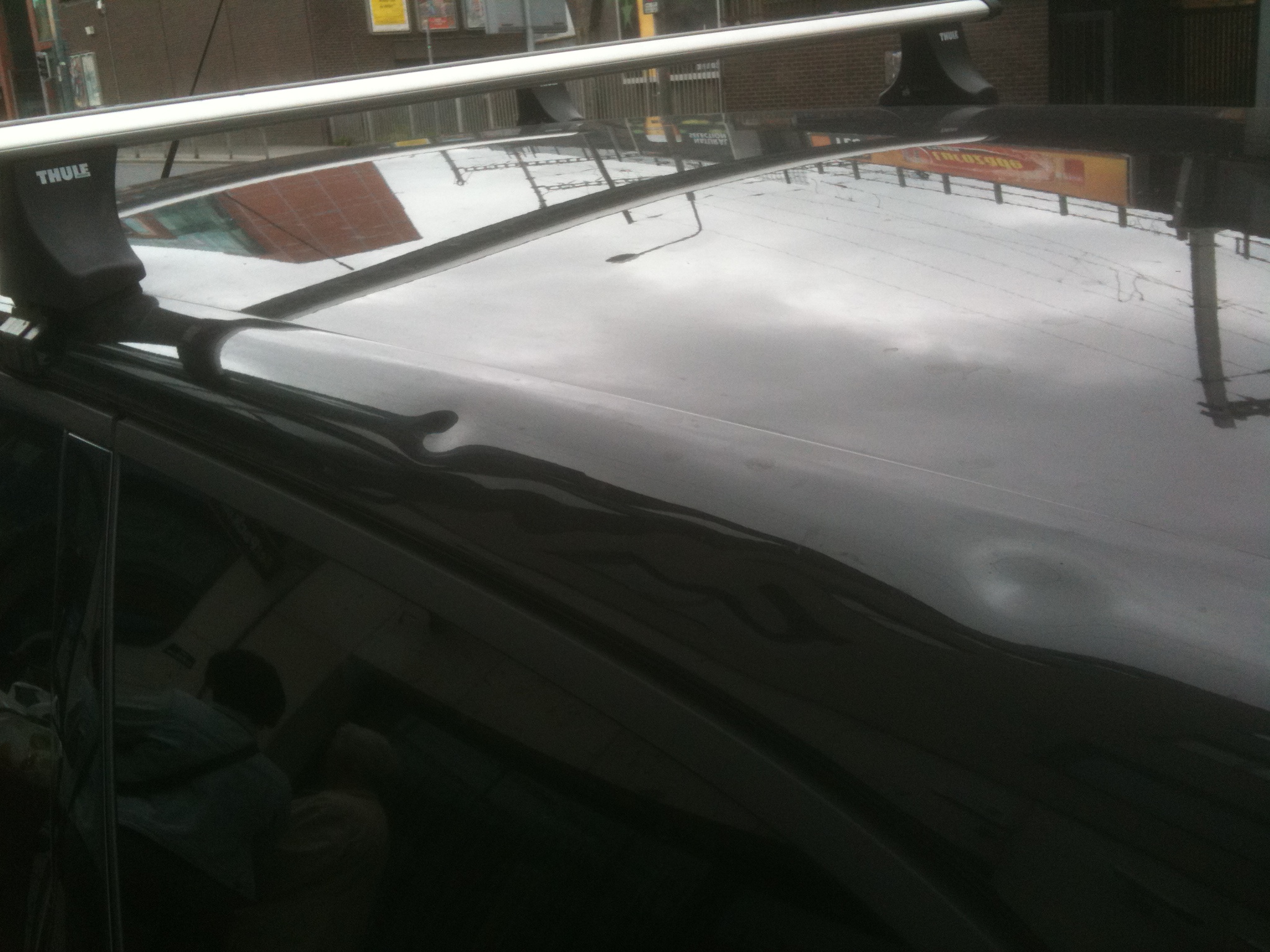

Spotted this the other day when I was relying on the Bus service in Dublin and got impatient and walked to the next stop. Looks like the owner of this car got over confident and kept loading the car up. ;) :)
Although its worked for our OP I still wouldn't be putting one my funk baby. :)
Im pretty sure that would have been caused by someone ratchetting the tension on the feet too tight, so they pulled together. The clamping forces are something like a max of 5nm when tightening the roof bars. Bet they had a 1/4" ratchet handle on them. :)
