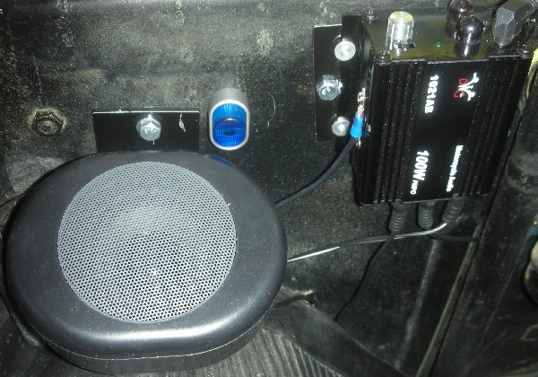

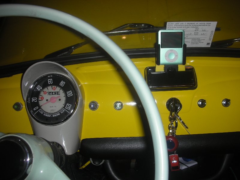

We wanted music also but something that wouldn't take away from the classic look of the car. What we came up with was an ipod mount in the ashtray. It is quickly removable and when the ashtray is closed it looks original. For the amp and speakers I used a motorcycle system mounted under the dash. Only 4 small bolt holes were drilled, preserving as much of the car as possible. At first it didn't work untill I learned about ground loops. Once I installed a ground filter we were cruising to 60s Italian music.

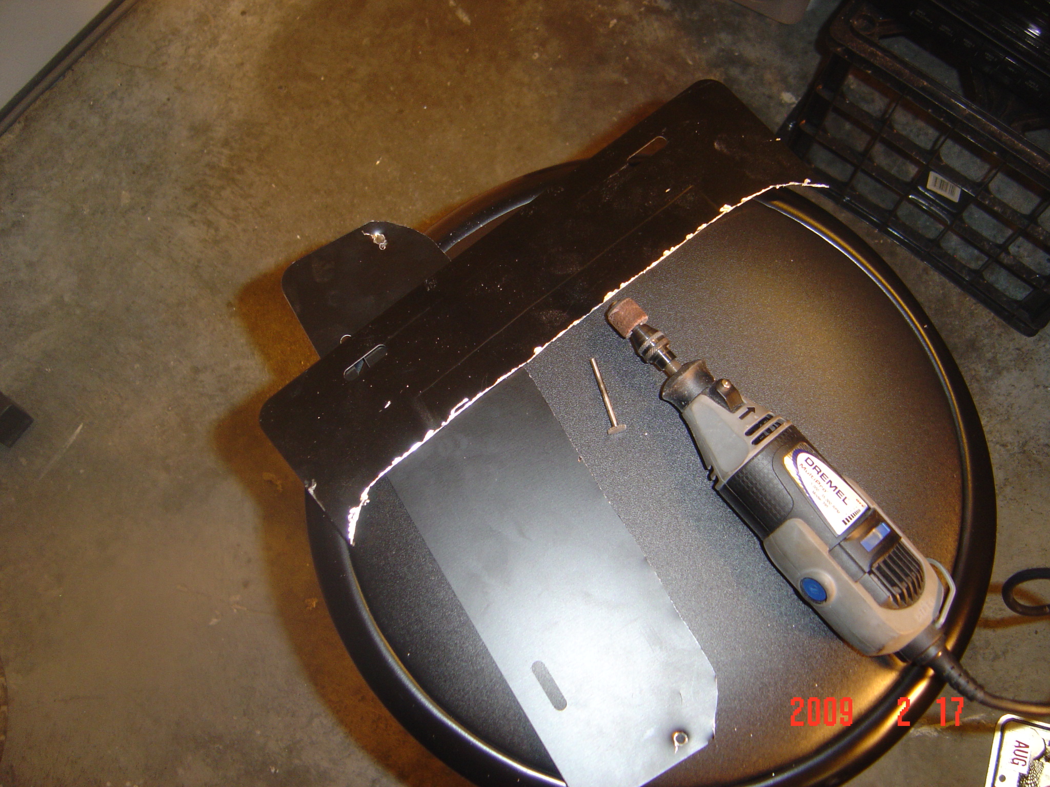

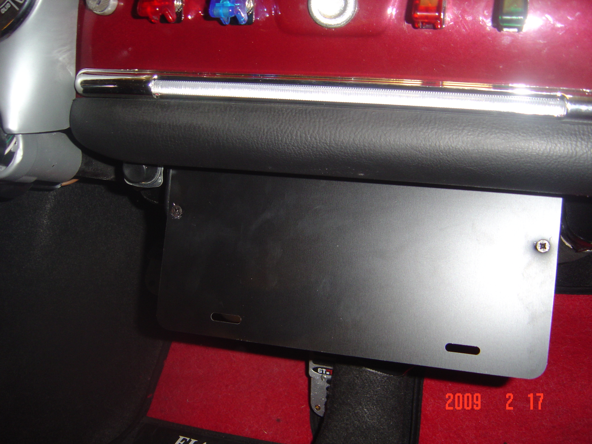

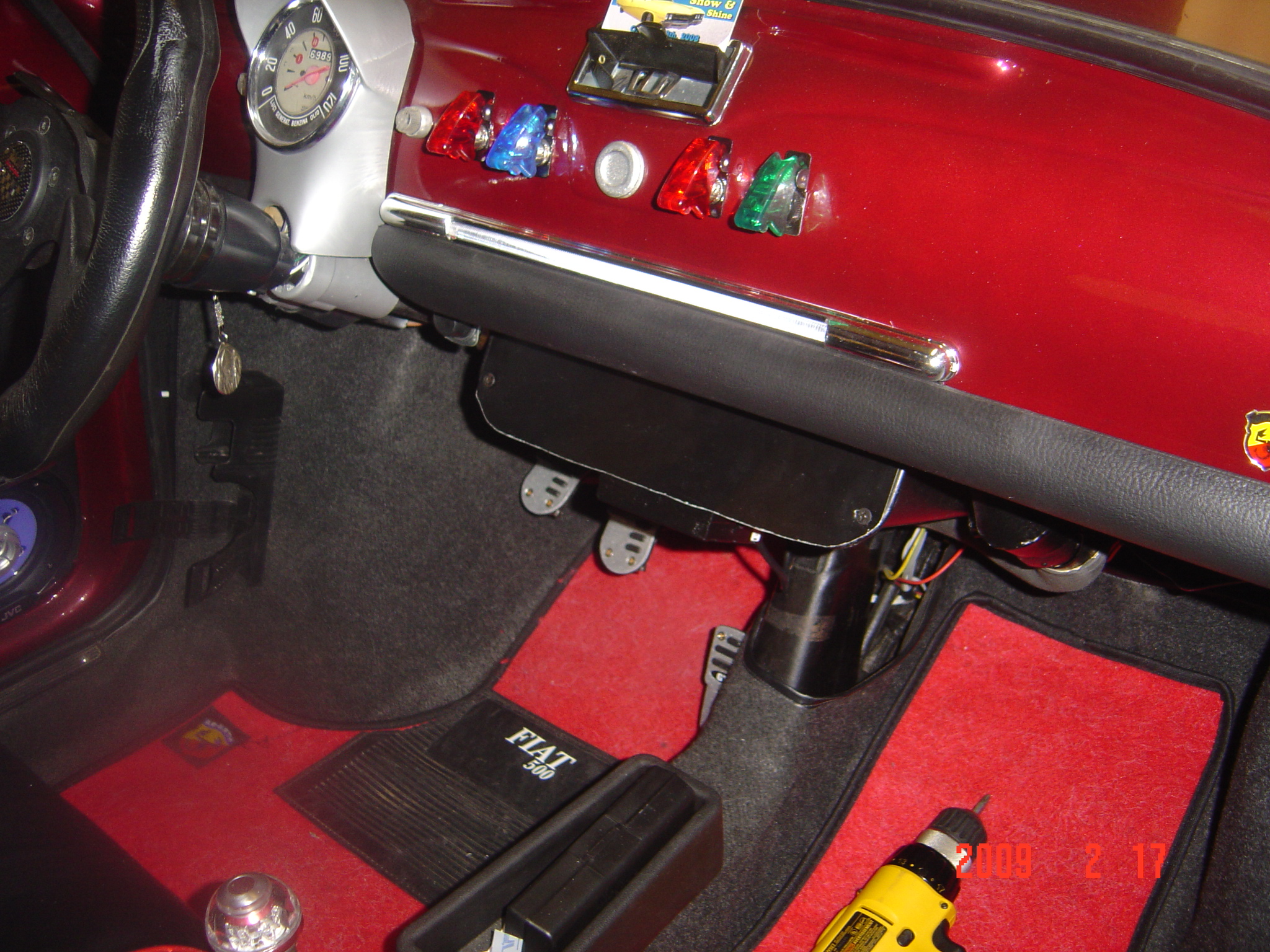

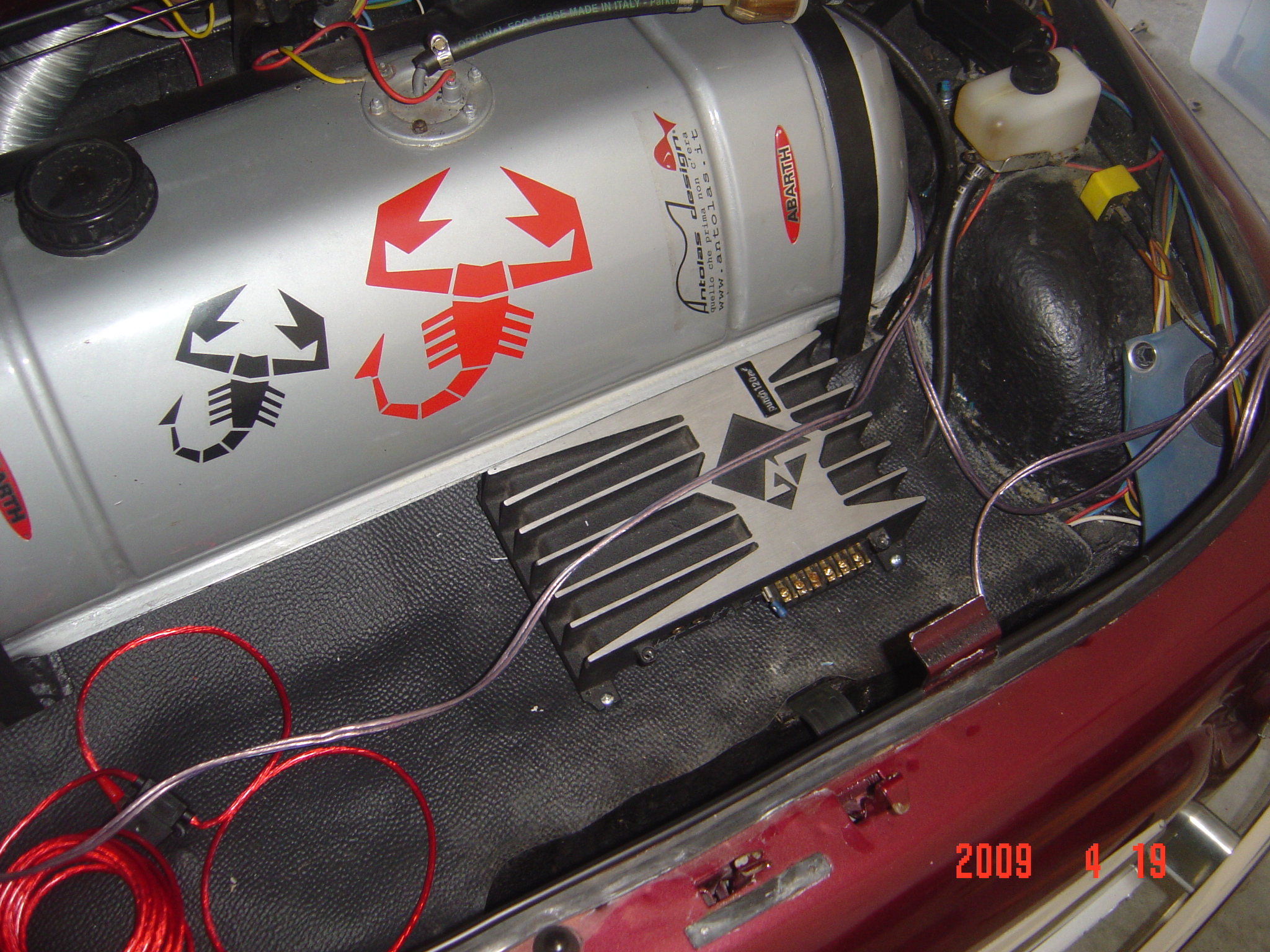

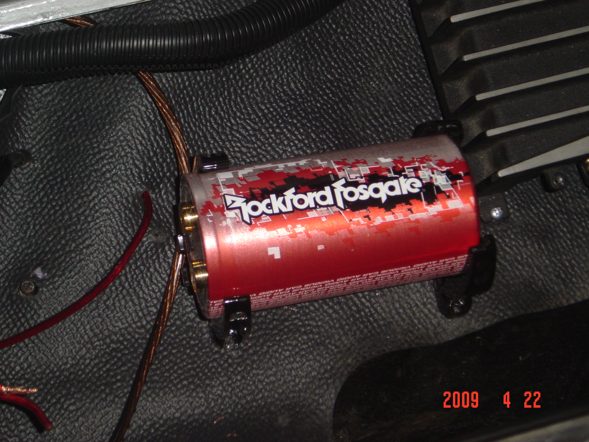

(y) Thanks for the compliment. But once the Sub gets here I will get a better view of where i want to mount it. I would prefer it to be hidden or somehow blend in with the car's interior. But to save on your Dyno or alternator, you could (should) add a small capacitor (1/2). I'm also using a small Amp (size wise) which fit perfectly. For a car this small anything over 500 watts is basically overkill. Here are some photos from my install.

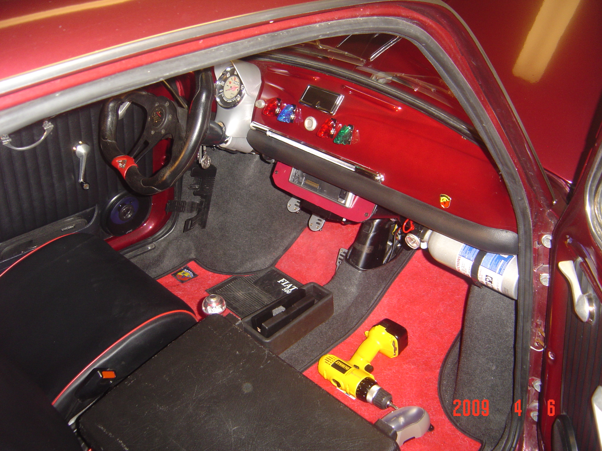

Heres my finished install. I have painted the CD dash mount to match the exact color of the car.
thanks for the advice about the capacitor, I have no idea why it should be fitted. Can you advise how it will aid dynamo output? :confused:
I understand the centre console from a 126 will fit and will try that first, as I have 1 or 2 gathering dust in rear of garage.....:slayer:
The capacitor aids the alternator by supplying power directly to the amp. So instead of your amp using a large amount of your vehicles power, it will also draw power from the cap. The cap gets recharged from your battery. So in essence, the cap acts as a second battery, but made specifically for your amplifier.
