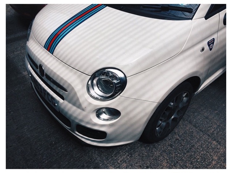

Unrelated; is that vinyl on your roof?

Thanks again for the responses, yep I'm currently running a martini vinyl that was intended for a 911 GT3 as it was a reject from my work, cut to fit with the side shields. ??

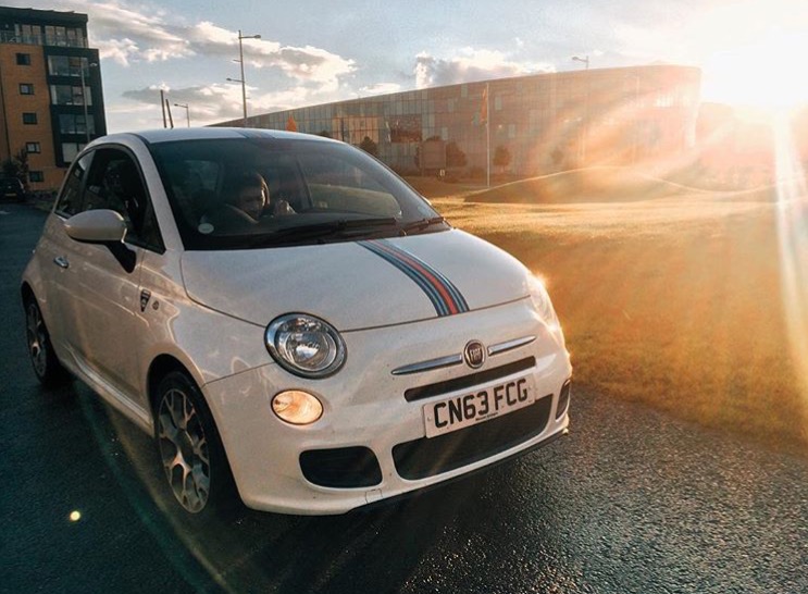

Another photo, fiats are extremely photogenic.

Love the vinyl though!
