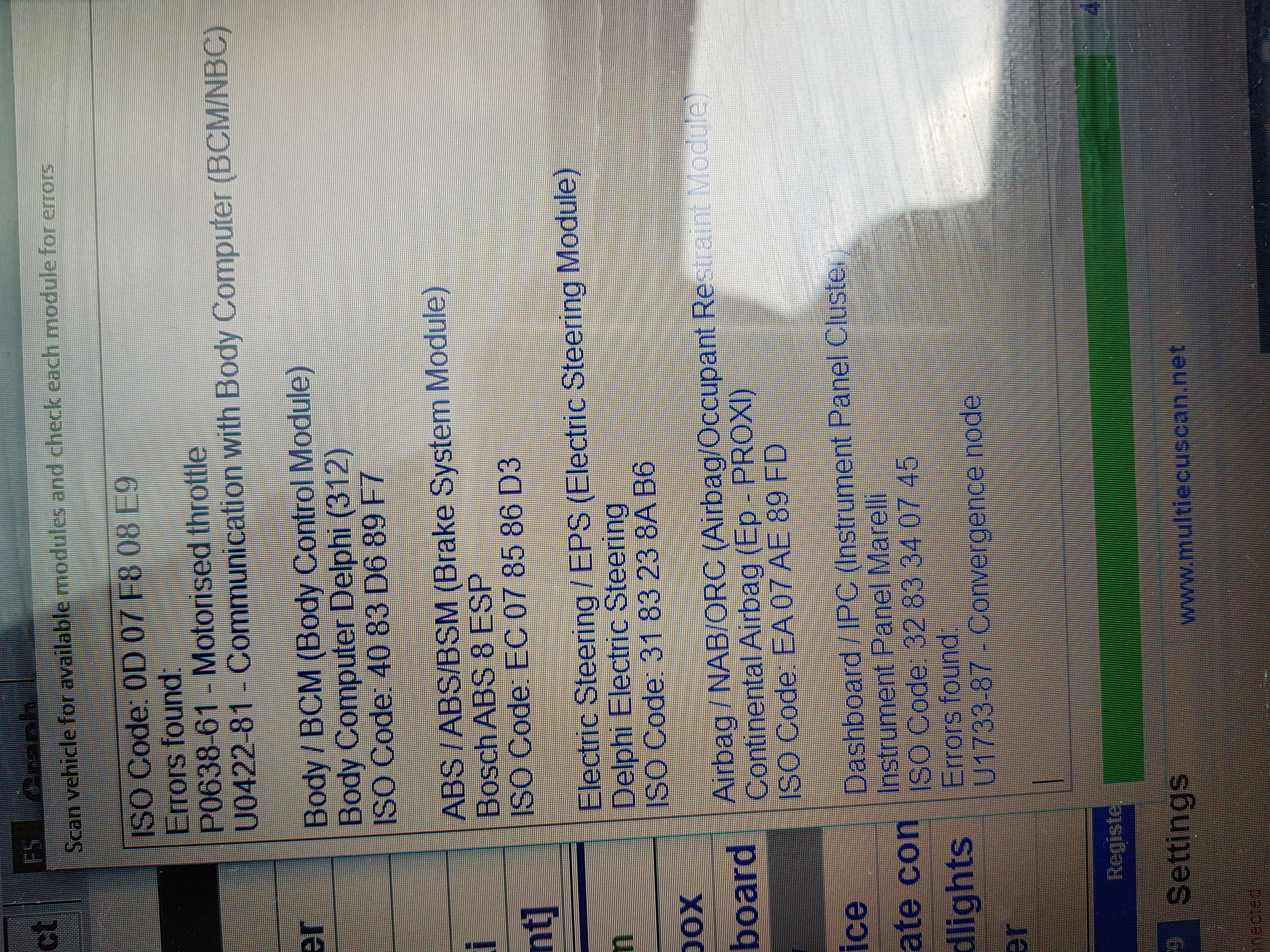

I have a 2013 1.2 8v Fiat 500. It recently had the flashing mileage syndrome...I did a scan with my multiecuscan multiplexed tool and I ran a Proxy alignment as it stated in the cansetup/proxy alignment section to align the modules.
The problem I have is no Blue and Me working. When I scan the vehicle modules I have no access to any blue and me modules? When I go into the system/dashboard control module section I have no access to any of what I assume are the Blue and me Modules.
It shows these 3 but I have no connection to any of them.

My instrument panel Module is Marelli so I'm guessing I should be able to access either the 2nd or 3rd option.

The initial scan prior to the proxy alignment showed that the Convergence Telematic Node (CTM) was Removed? I am guessing thats the module for the Blue & me and it has failed hence it states its been classed as 'removed'?
After the Proxy Alignment the Convergence Telematic Node is no longer visable in the list of modules in the can set up section.

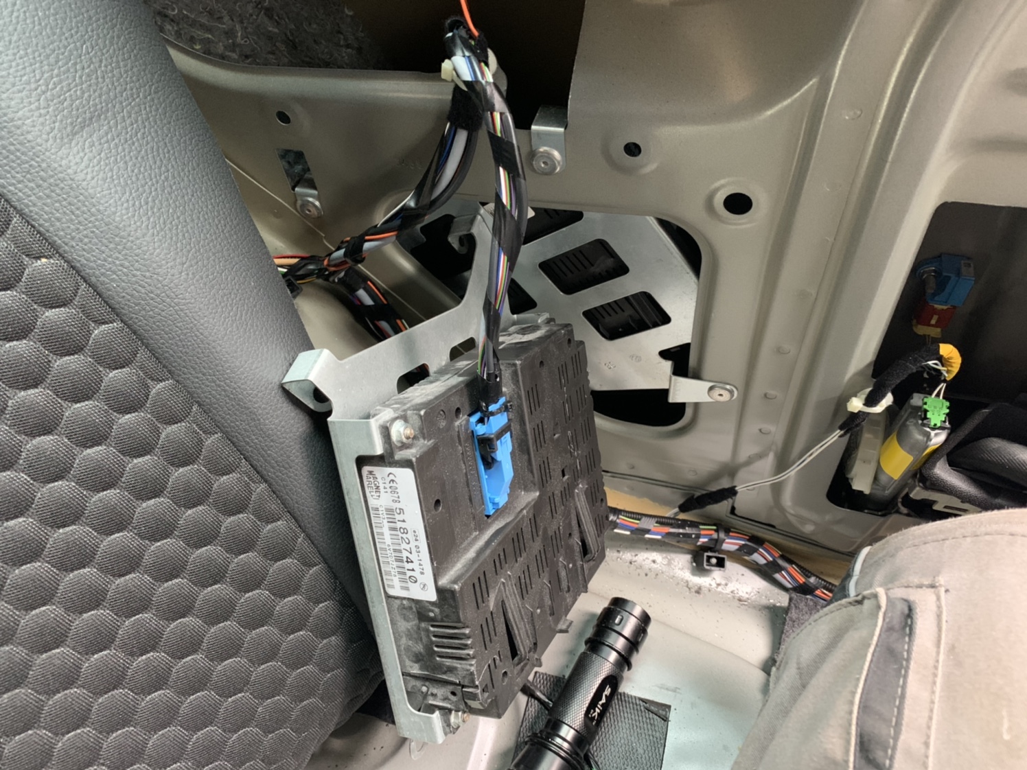

If you select the wrong one you just need to click on another but if none of them are connecting then it’s not that uncommon for these to fail. You can pick them up on eBay for under £100. I did a guide recently on how to change one, I’ll find the link.
Replace blue & me unit
https://www.fiatforum.com/showthread.php?t=473718

Hi. Many thanks for the reply. I have got it all stripped out, I have ordered a replacement unit.
I was just hoping that I was barking up the correct tree and I can see from your experience I am:) (Hopefully)

I fitted the replacement B & M module today. No dramas.
The module I fitted had the same CE0678 141 numbers but the part numbers were different, mine were 51944597 and the replacement was 51827410.
I had read that you must fit with a unit of the same numbers or it would not work? Well this has, so obviously it does not have to be a direct like for like.. I had to perform the Proxy alignment as it set the mileage flashing as expected but it has all gone ok.
Thanks for the help from this forum...

@typecastboy - would you happen to have the part numbers and/ or a picture of the telematics unit itself? I've searched on ebay but not been able to narrow it down

On my diesel 500 13 plate I had trouble with the battery becoming completely flat if I left it for more than 4 days and also the blue and me and stop start not working. I have used multiecuscan and turned the flashing odometer off before but when disconnecting battery when parked up for a long time to save a flat bettery I would end up with it flashing again ..now i know the battery had a 0.45 amp drain when parked up but I’ve put up with it for 40000 miles
So following typecast boys pictures/advice ?removed side panel ,unplugged blue&me and then put side cover back on.. and went for a run ..no flashing odometer straight away and stop/stop returned immediately when I returned home I checked discharge rate when parked ..zero??
