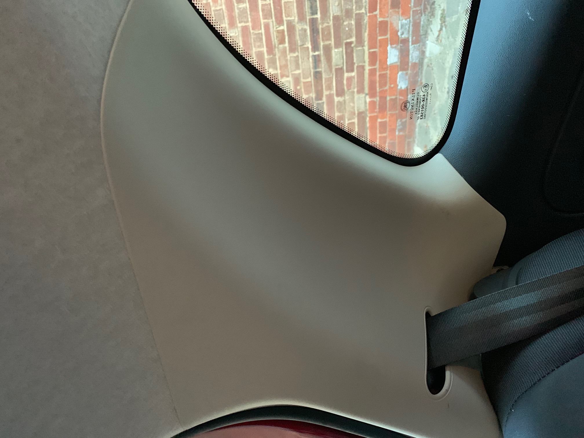

Remove the 2 bolts holding the seat backs in the boot area. Two bolts either side. Leave the brackets connected to the seats, just remove them from the side of the car.
When you've removed the four bolts which you will find easier to do with the seat backs pushed at varying angles forwards, fold both seatbacks flat and you will see between the two seat backs is an Allen bolt. Remove that and the flap that holds the cotton reel between the two seats. Then manouvre the seats out of the car via the hatch, keeping them together.

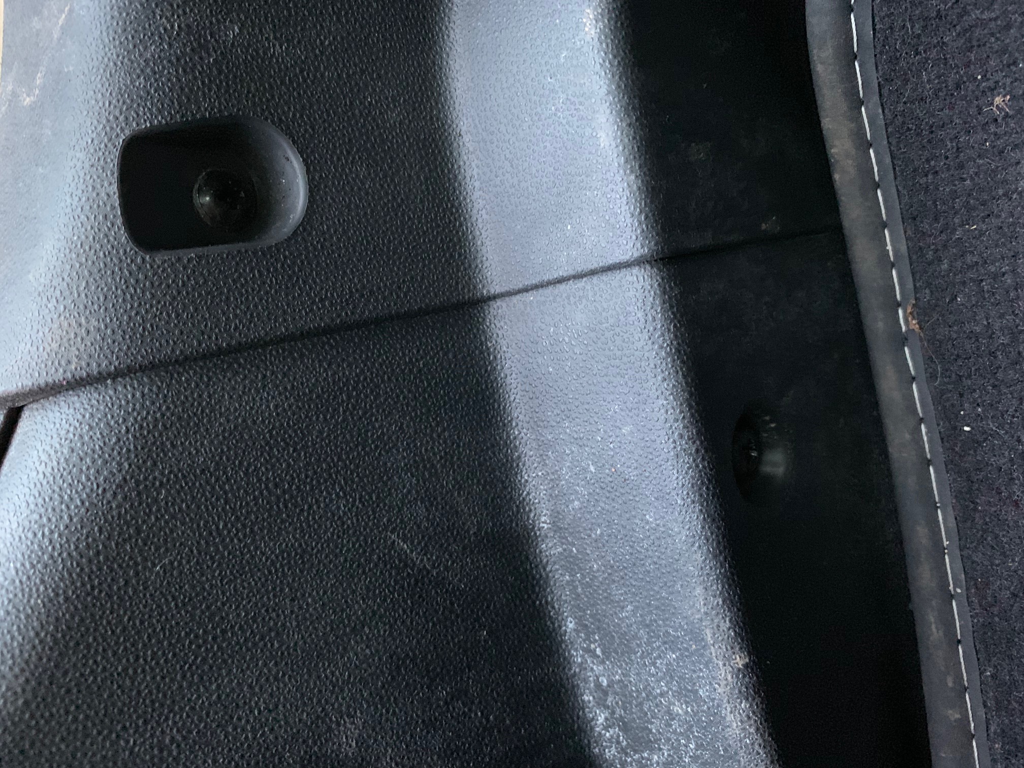

Inside the rear cabin, the seat pad is bolted to the upright part of the rear floorpan with one bolt either side. Remove this and the seat pad just lifts away.

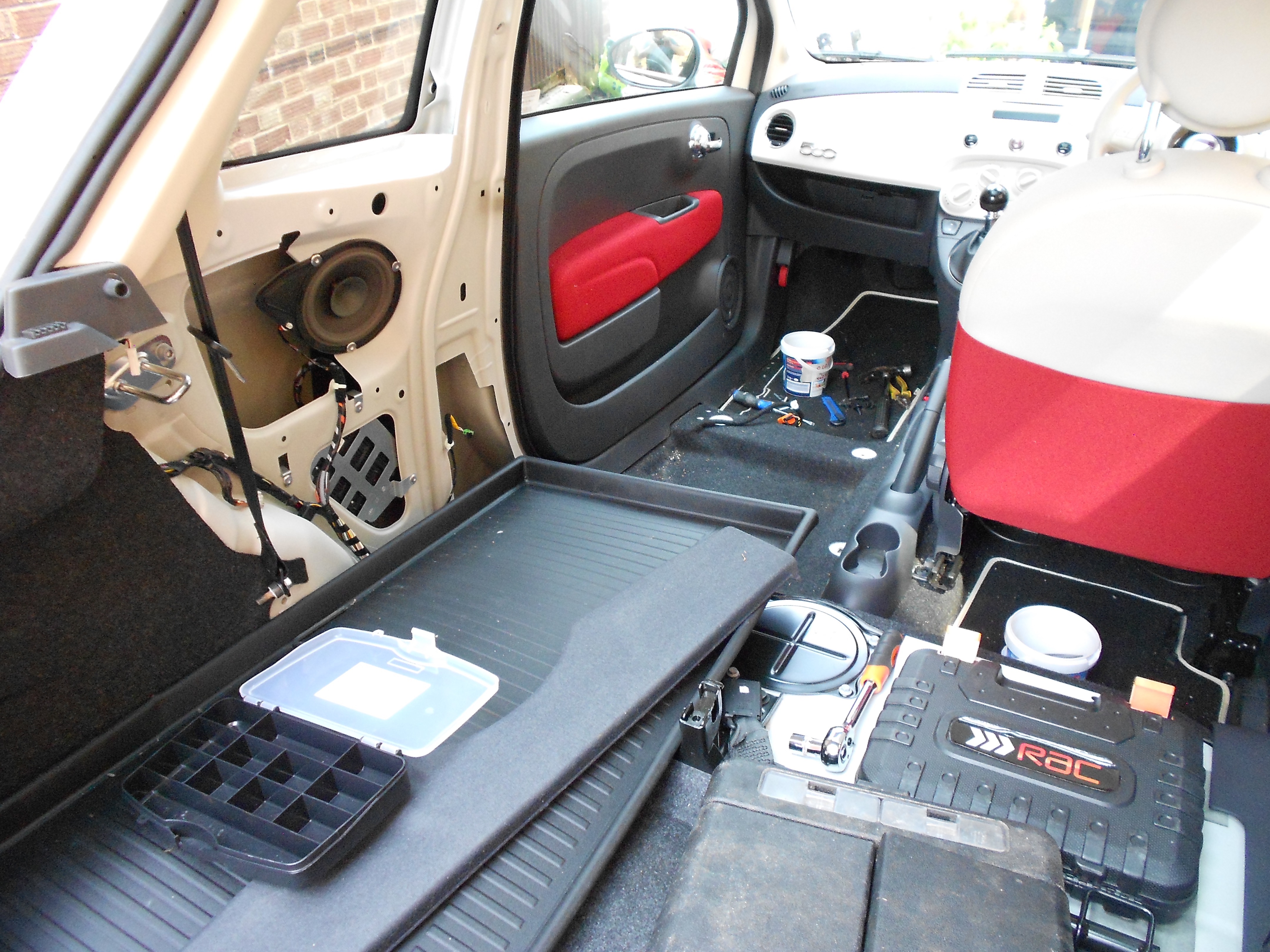

The last photo shows the panel removed and you can see the Blue & Me module at the bottom underneath the rear speaker.
