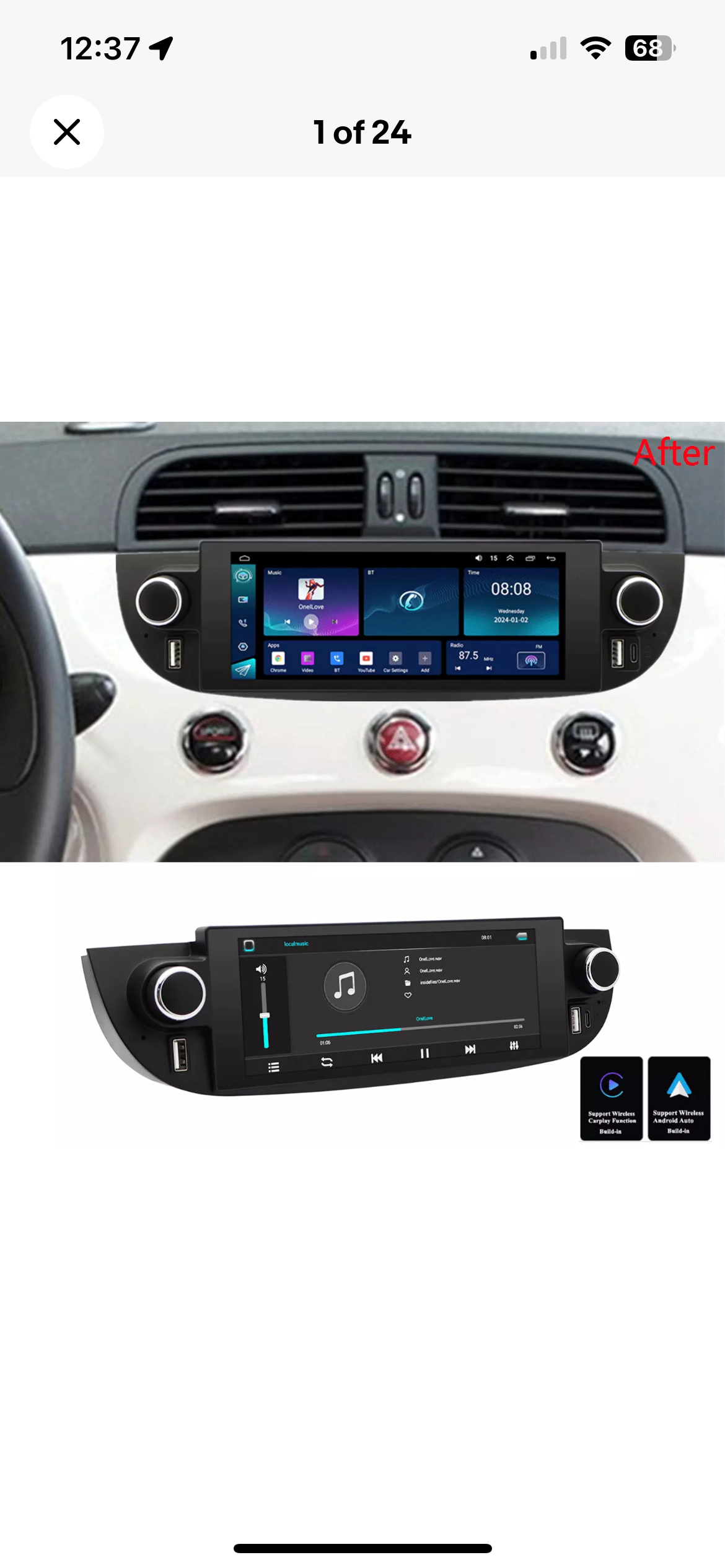

Can anyone help me. Has anyone fitted this unit? I fitted it it works fine but now the mileage is flashing and I can’t get the steering wheel controls to work? It’s to do with the cambus settings… I just have not got a clue.
These things generally come with breakout boxes that are supposed to fool the car into thinking there is still a Fiat stereo fitted. Flashing mileage would suggest that something is amiss with this.
Steering wheel controls not working might be because there's a connector that hasn't been plugged in. This is a bit vague, but it's exactly the problem "Love 500" ran into in one of his videos.
