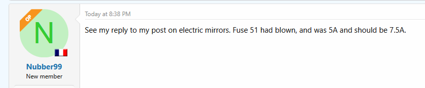

Is the F51 fuse OK?
Is this wire from fuse F51 to ISO connector pin A7 OK?
Ha :D
Recheck after replacing the fuse, please.
Is the F51 fuse OK?
Ha :D
I did check after I replaced the fuse. No supply to the cigarette lighter with the key in the accessory position. And, there's no connection at all in position A7. As I said above, I think that is only wired in for cars supplied with no factory radio, but pre-wired for a generic radio.
