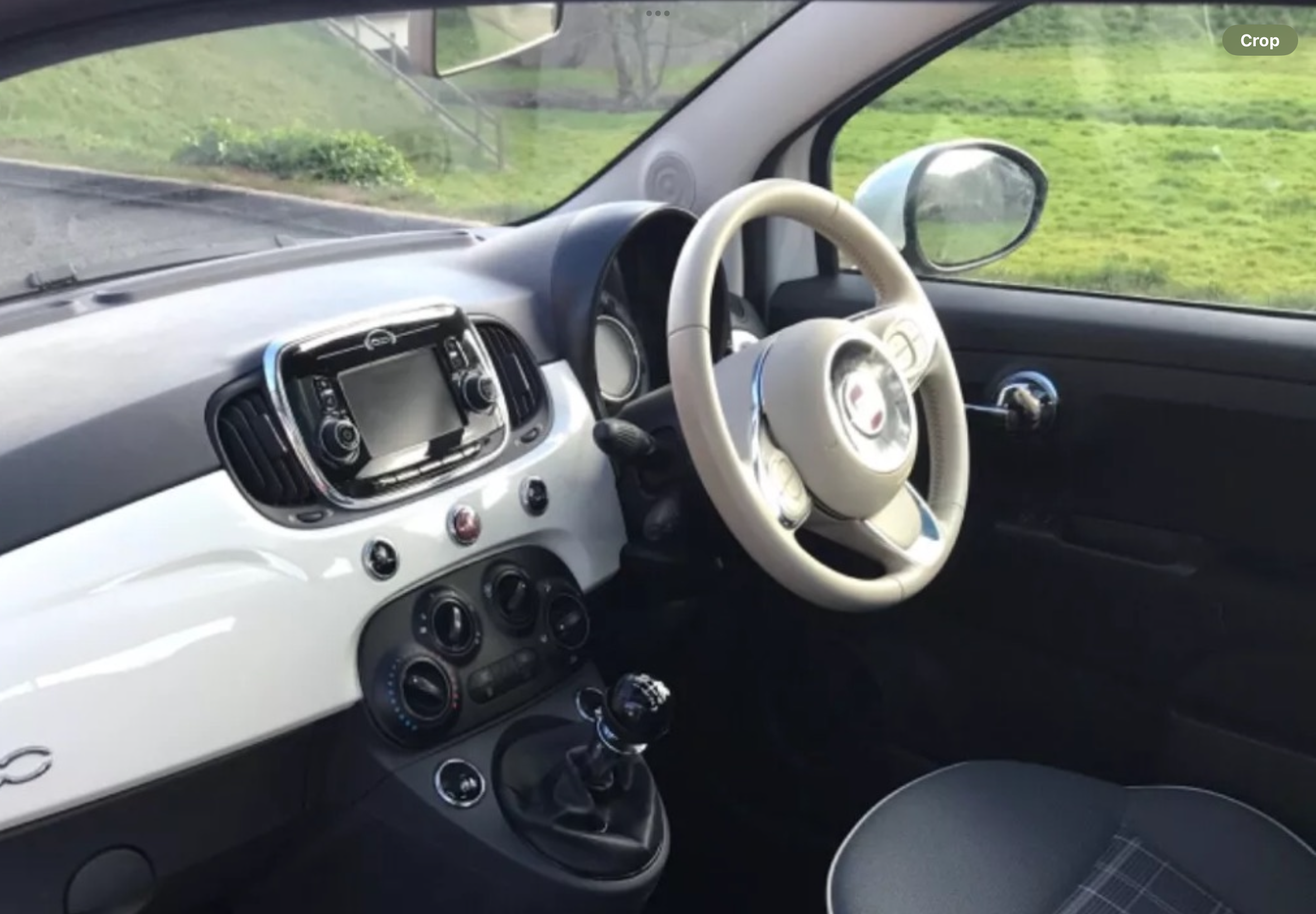

I’ve recently purchased a 2017 Fiat 500 1.2 Lounge petrol, which currently has the Uconnect unit with physical buttons (photo attached). The unit only has the ‘Trip’ button and no ‘Nav’.
