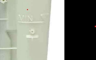

Whichever one you buy, make sure this part of the expansion tank is blind, or seal it off.
