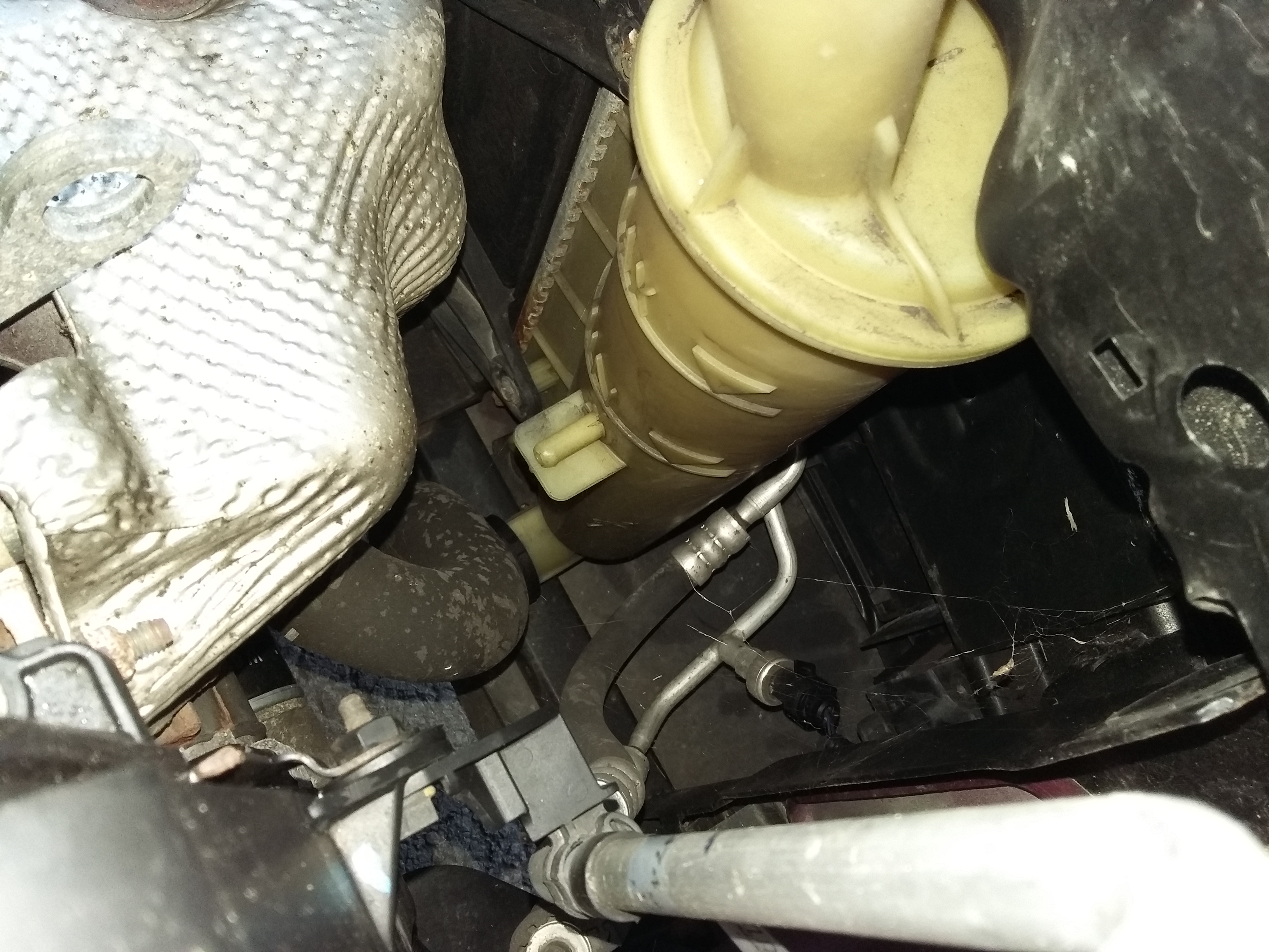

Hi I have a question on the radiator on a 1.2, it has maximum and minimum on the filer but underneath the minimum is a bit of plastic pipe that lets water out if you go over it. So it basically does not let you get to minimum never mind maximum. I have attached a picture.

Hi,
if coolant comes out of that point then the side tank is broken . The point indicated should not be a hole through the tank.

You sure mate cause it’s a brand new radiator just purchased and it was coming out the one I took off also. Strange this

Is it not meant to have a blanking thing over it and the hole is for fitting it to another make car with a return or something.
Thats a mounting lug.. not regularly used on a 500
But maybe its had a long bolt..or screw wound into it and has punctured it?
I suppose you could attemp to plug it with a bolt if you are stuck.. BossWhite plumbing paste is pretty effective for such uses.
That was my first thought as the radiators are common to a few cars that have different mounting points…if it’s brand new it could still be faulty
I will block the hole tomorrow with a bolt and silicone and check the radiator I removed to see if that hole is blocked off. It probably is to be honest. It was leaking out the bottom right corner so I changed it. The factory who made this must have made a mess up cause I have not screwed out in there and was careful with it.

Looks like we need a new radiator evidence of moisture drips
