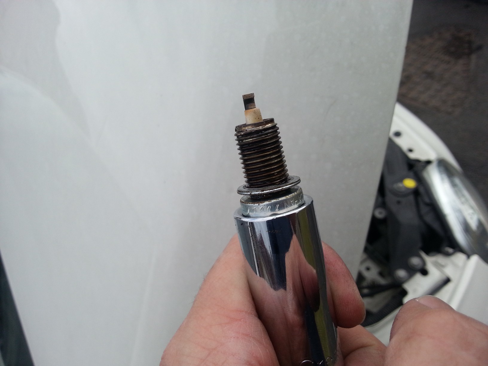

Nice oily watery emulsion around the throttle body some photos of the plugs that came out, the first one looked good, the second and third ones had quite a bit of oil on the threads and the 4th one (closest to the battery) was a bit sticky which I suspect is down to perhaps having a little bit of the oily emulsion from the throttle body mixed with some throttle body cleaner going down in there from when I cleaned it last time.

Looking closely at those plug pics, the first one shows a thoroughly knackered plug, the centre electrode has lost all of its square edge, and thus a much higher current is required to fire it, and the spark won't be anywhere near as 'crisp'.
But it's always satisfying to change plugs - you don't notice them degrading slowly over time, and the change when you fit new is often quite marked.
