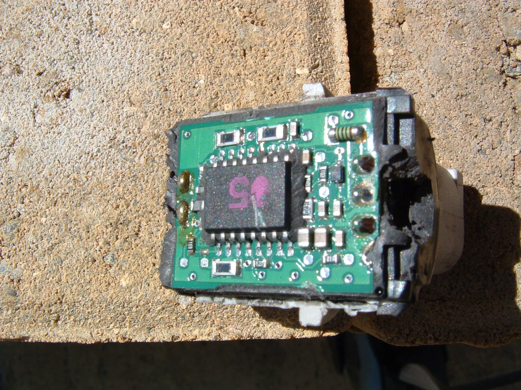

Further to my last post, I've dismantled one of the faulty sensors to see what caused the problem in the first place. The thing to note is that these are not user-repairable, they are sealed from manufacture. Water ingress is unlikely to be a problem as the sensors are completely filled with rubberised foam.
As you can see from the picture, the problem would seem to be one of poor quality soldered joints. Nothing you can do about it I suppose. Apologies for the picture quality, my camera doesn't have a manual focus.
HTH.

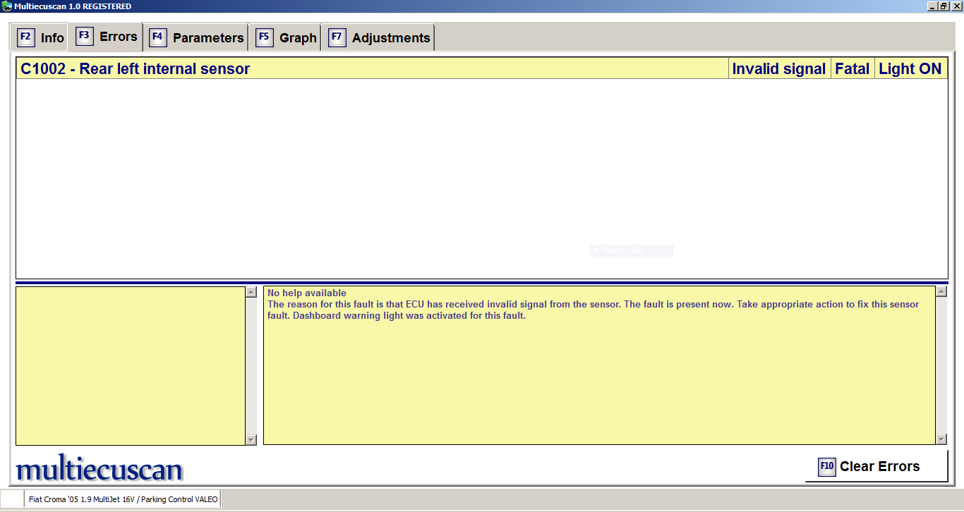

I just plugged in multiecuscan and got the code C1002 Rear left internal sensor (see screenshot attached) but now I come to think about it a bit more I'm confused about the word "internal". It might just be imperfect translation though.
I would assume that it means the 2nd in from the left. Do you have the full paid multiscan (mine has just expired) and did you connect to the main ECU or to the body ECU?
Yes, you must be right - obvious now you've said it, but it didn't occur to me! I have the fully paid version. I think it was the body ECU, but to be honest I can't remember, and my laptop is at work so I can't open it up and check. I definately had to go to a different menu to the one I normally use, e.g for checking the DPF.
