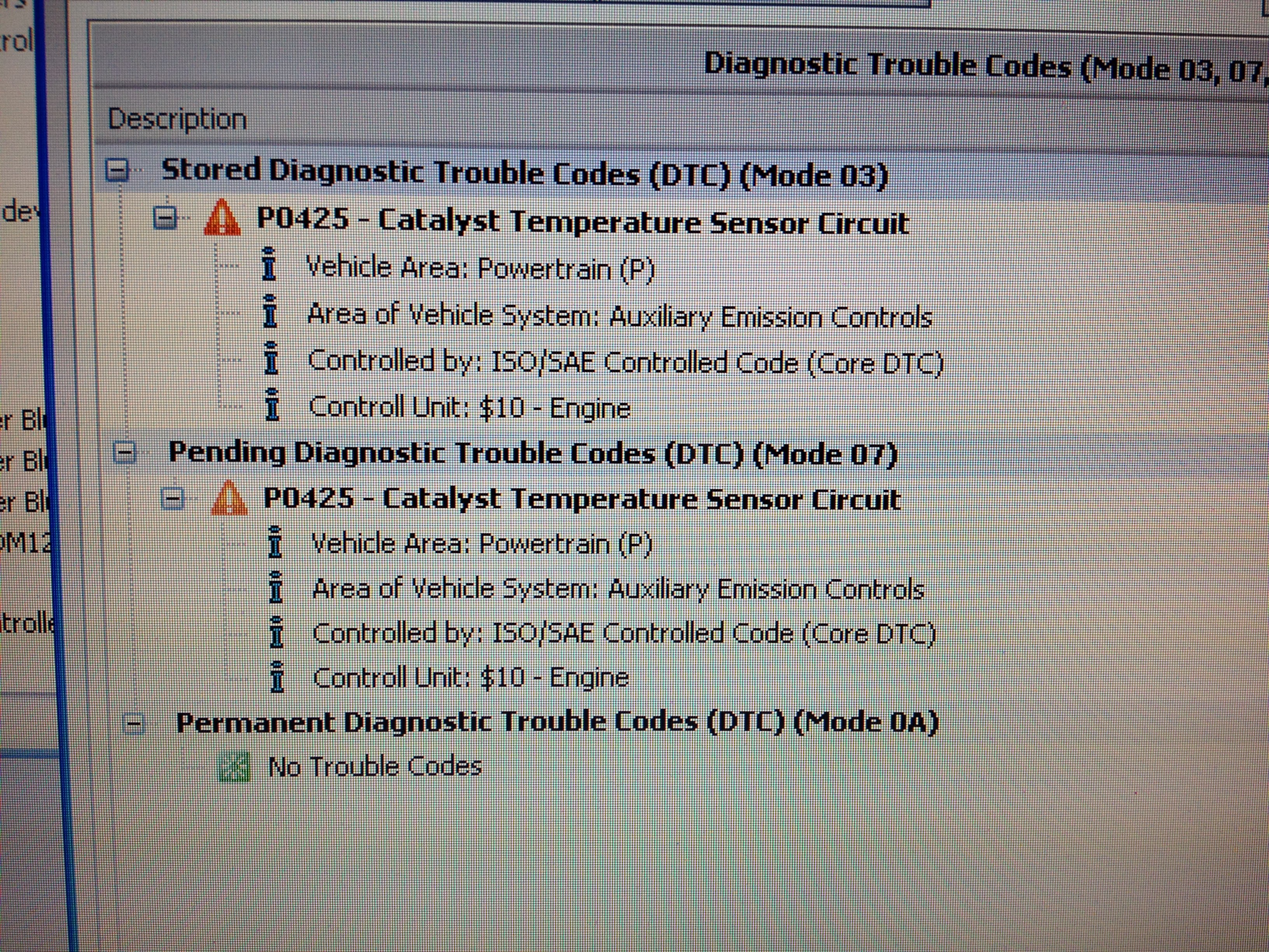

P0425 - Catalyst Temperature Sensor Circuit
Does anyone have any idea where it could be?
Thanks!
