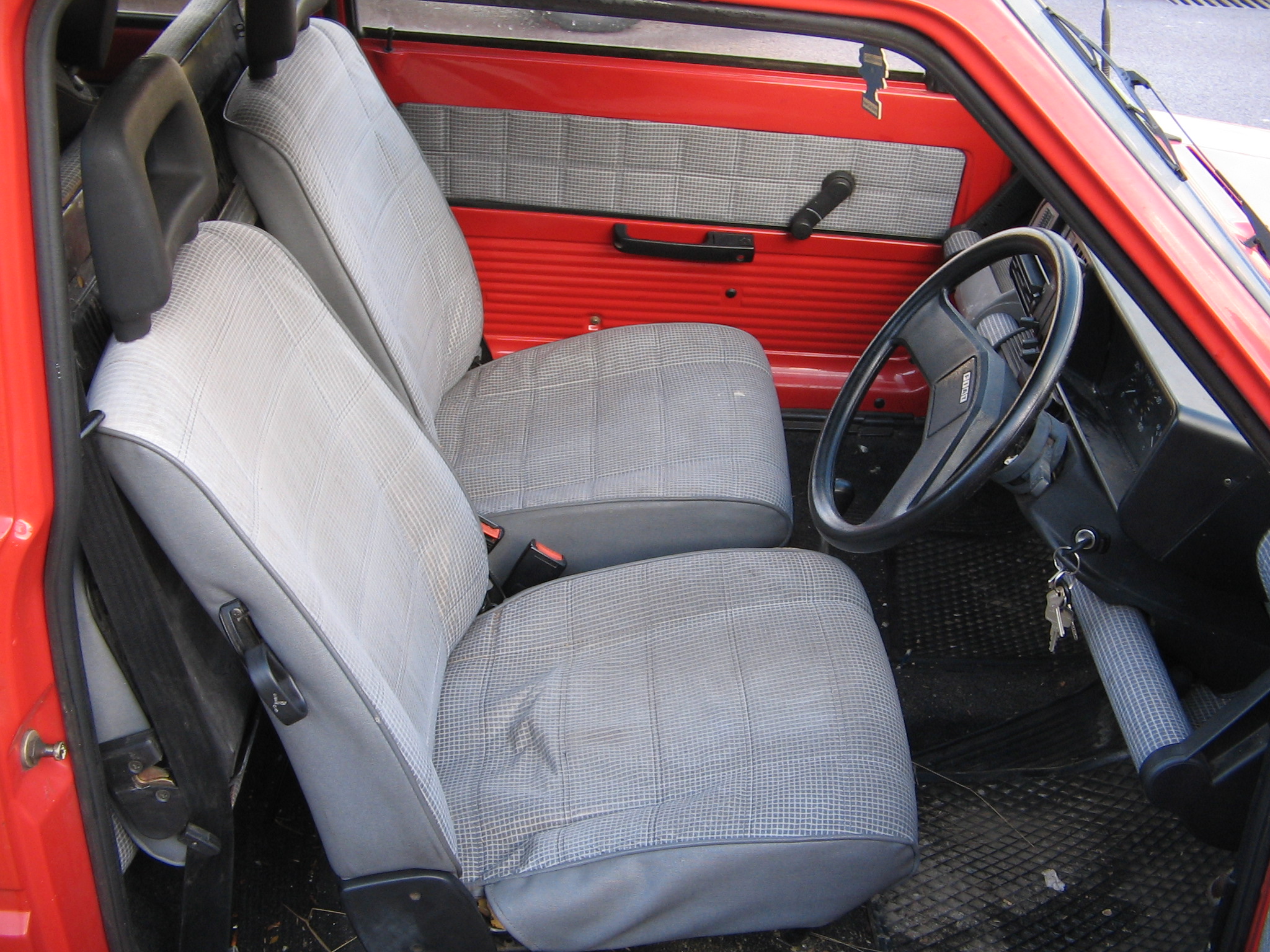

Took the protective seat covers off the front seats and was pleasantly surprised! I won't be using them but another forum member might ;).

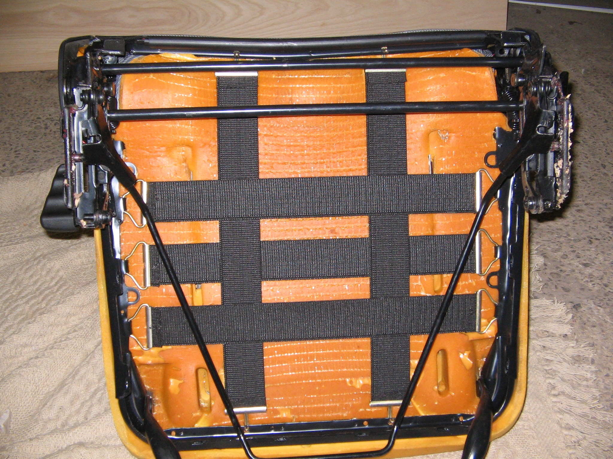

Had a look at the seats from charmania, as it's the one I'm using at the moment it would allow me to test anything I tried.
The strapping wasn't quite as I'd hoped, I thought it would be four or five horizontal straps (as you look at this picture), so wasn't expecting to see the two verticle ones as well. The area that has gone week is at the back of the seat base (top in the picture), and as there aren't any horizontal straps in this area I couldn't replace them.

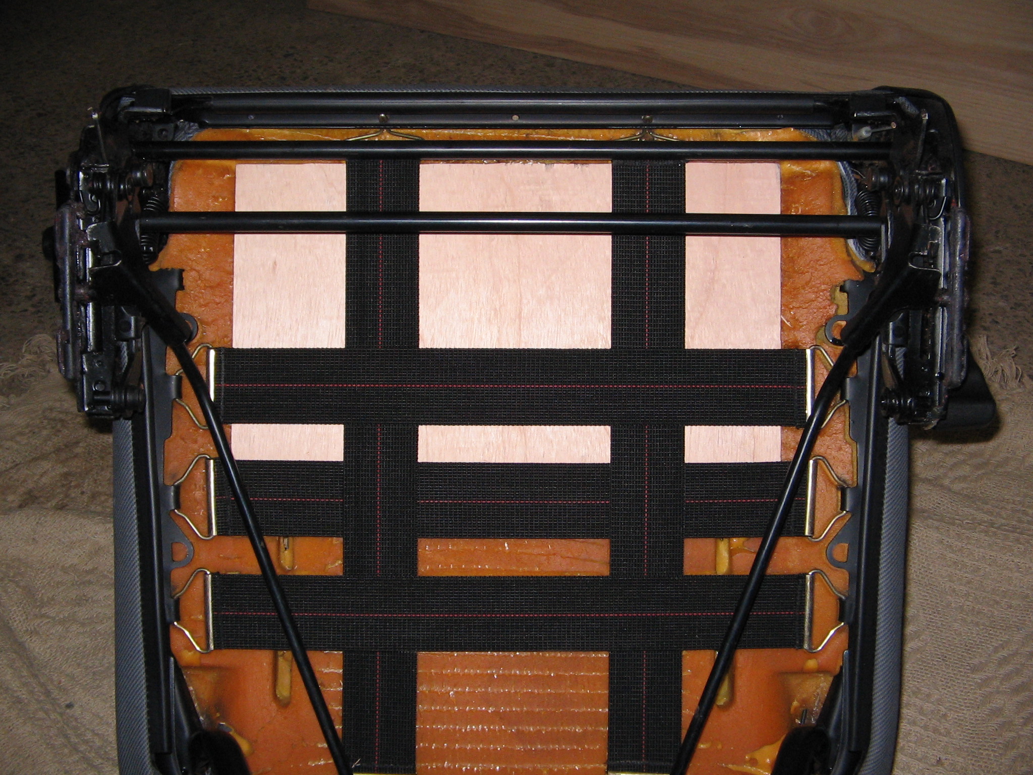

As this isn't part of the project I didn't want to spend too much time on it so went for a quick fix............
It's simply a piece of 6mm plywood slotted in between the foam and the straps. When I went for a spin to test the results I found that I was no longer sitting in a dip and had restored my ride height. I could no longer feel the seat frame in my back so comfort was improved also, however, I could feel that I was sitting on a board which kind of suggests that the foam had lost alot of it's strength and this was the main cause of the sagging, more so than the straps. I'm happy with the result though, and shall enjoy my more Germanic seat for a couple of weeks until it's replaced by something far more siutable.

That's interesting - I thought you'd got a strap missing there as the hooks are there for one at the rear, but on checking my '90 4x4 found it's just the same as yours in the pic with hooks there but no strap. Would it be possible to fit another strap from a scrapper at the back?
Yeah, if the hooks are there I see no reason why not, I can't remember seeing them when I had the seat out but they'll be out again soon as the next job on Charmania will probably be fitting the new seats. I'll have another look and report back (y).
