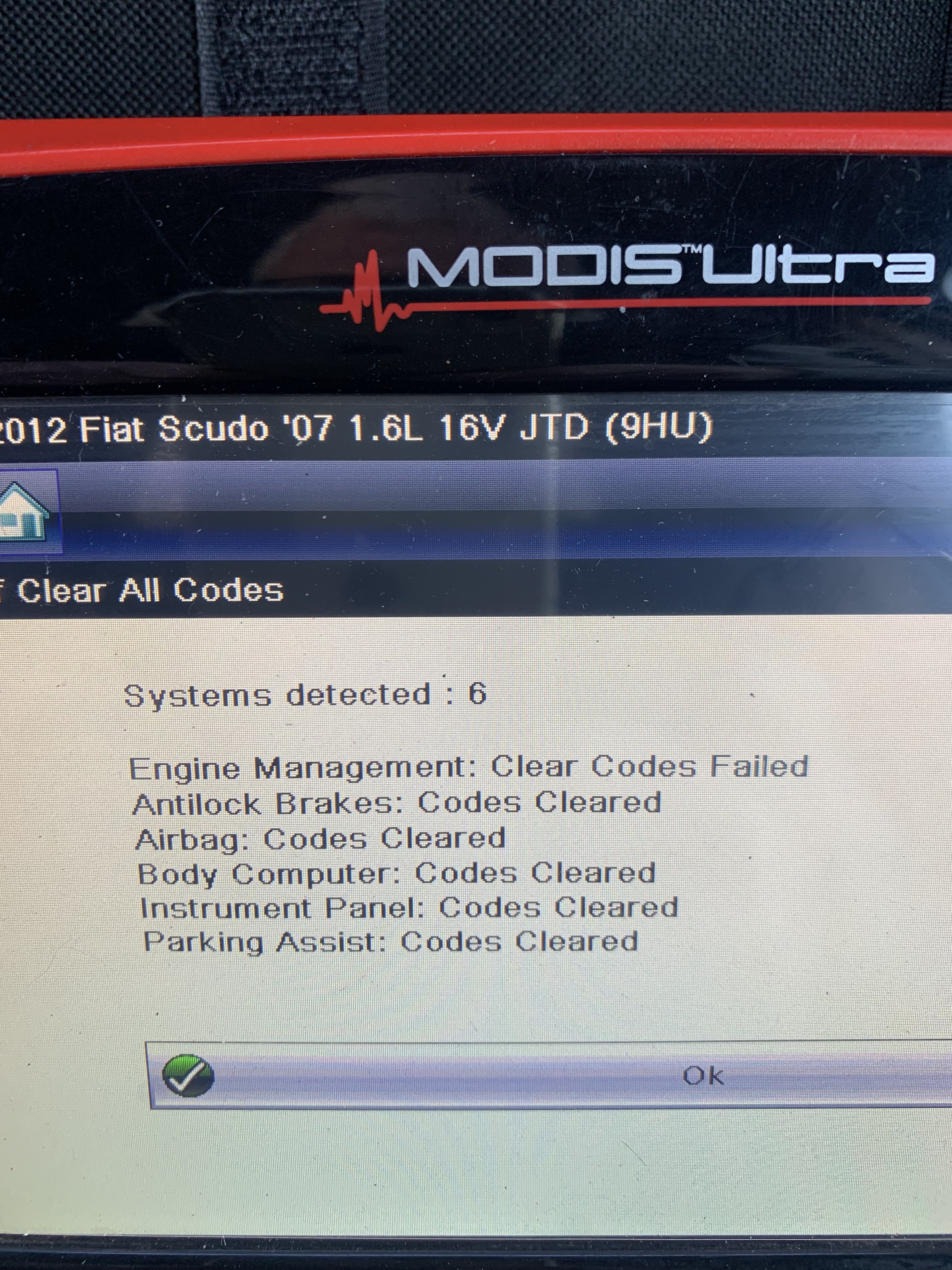

With your code reader were you able to delete the code and come out of limp mode?

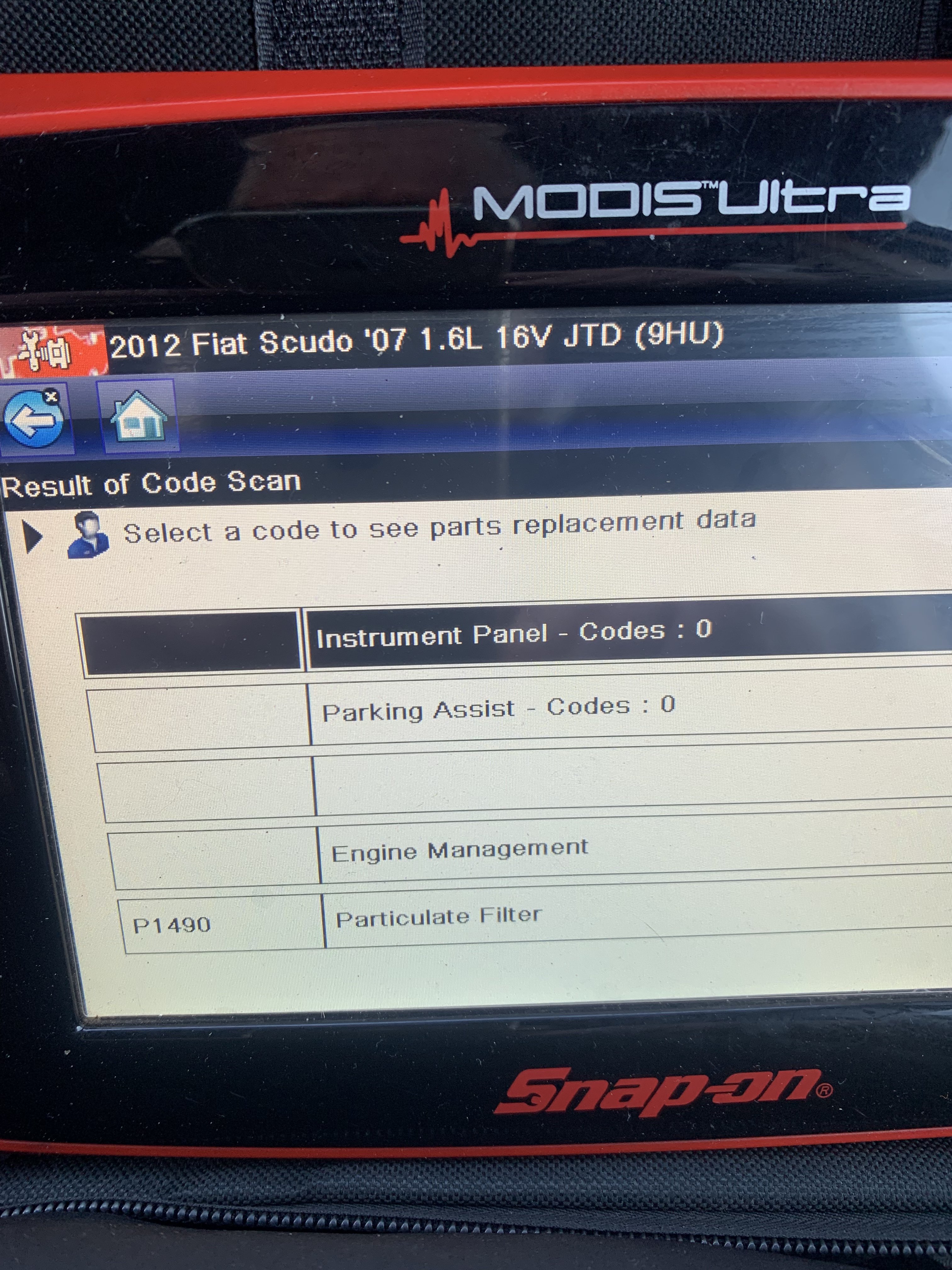

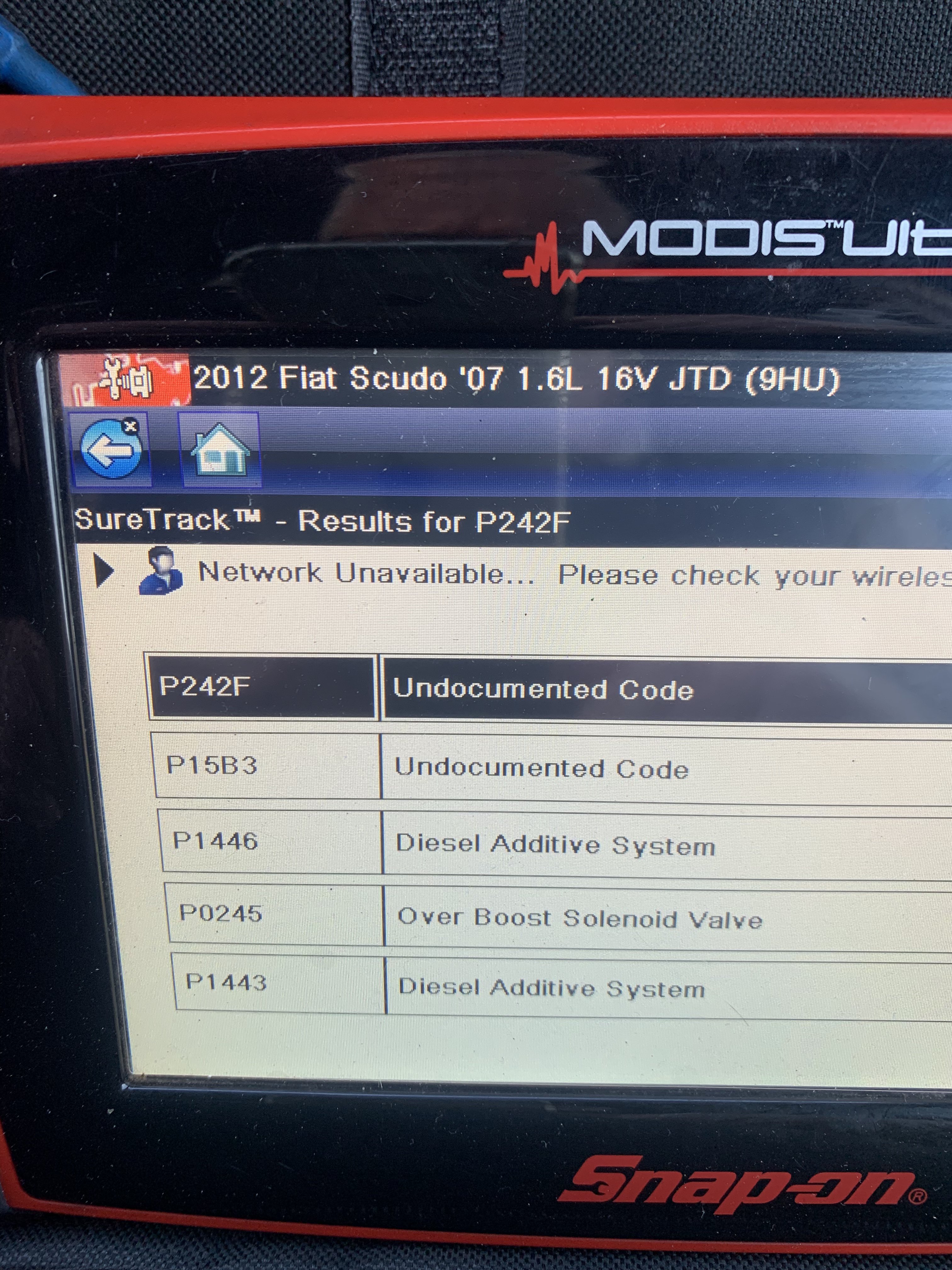

Yes its a snap on proper gear heres some codes deletes then they come back

Similar to Peugeot Expert and possibly Citroen C3 1.6 also then.
Do you know what the state of the DPF system is , Additive levels , whether it is pumping /working correctly to administer the additive , is the DPF possible partially blocked etc.
The reason I am going in this direction is I bought a 2012 C3 picasso 1.6 , it was chucking out loads of white smoke and not revving properly (only paid £300 ;)) I removed and cleaned the DPF using bleach , strong oven cleaner and a commercial steam cleaner, got loads of brown muck out, used my mates Snap On Zeus to tell it it had a new DPF and sorted the problem, though it did mention DPF fluid (Eloys) getting low so I later refilled that and used same tool to confirm. Car runs clean and like a "horse with it's ears back" at 220 K miles;)
The tank was empty, i put particulate fluid in put it back, the pipes are fool proof because they only go in one place, resetting doesn’t clear code 🤷‍♂️
