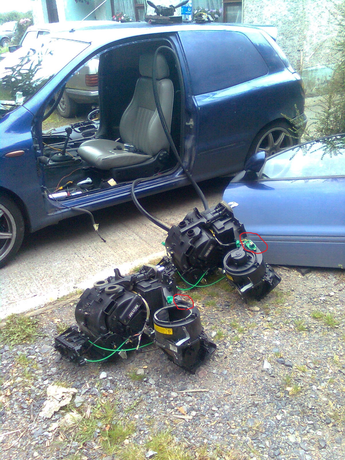

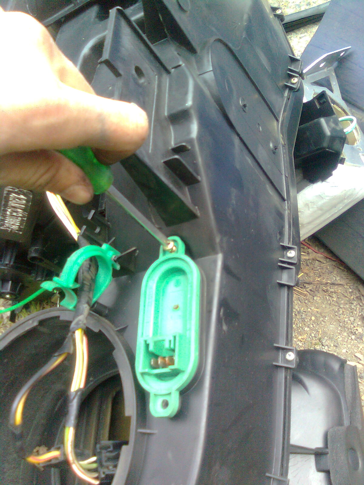

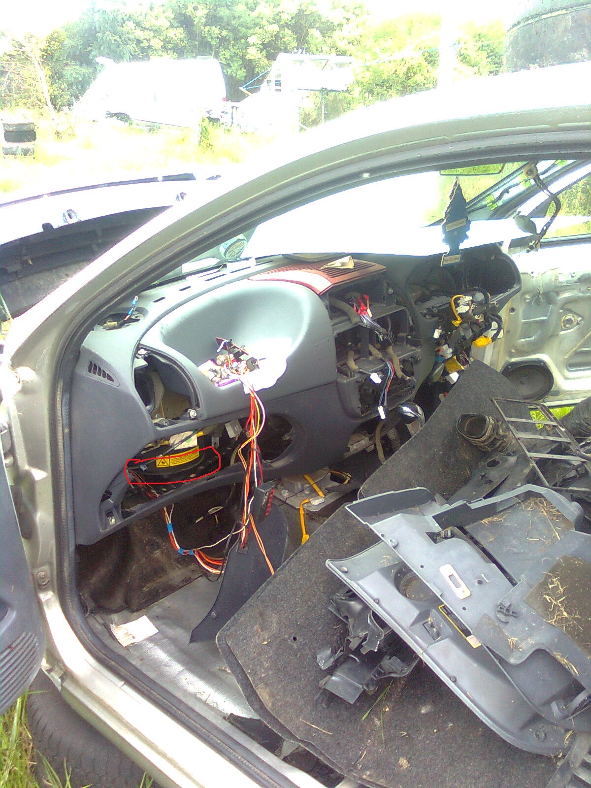

Thanks to m20b25 here are some very useful pictures
