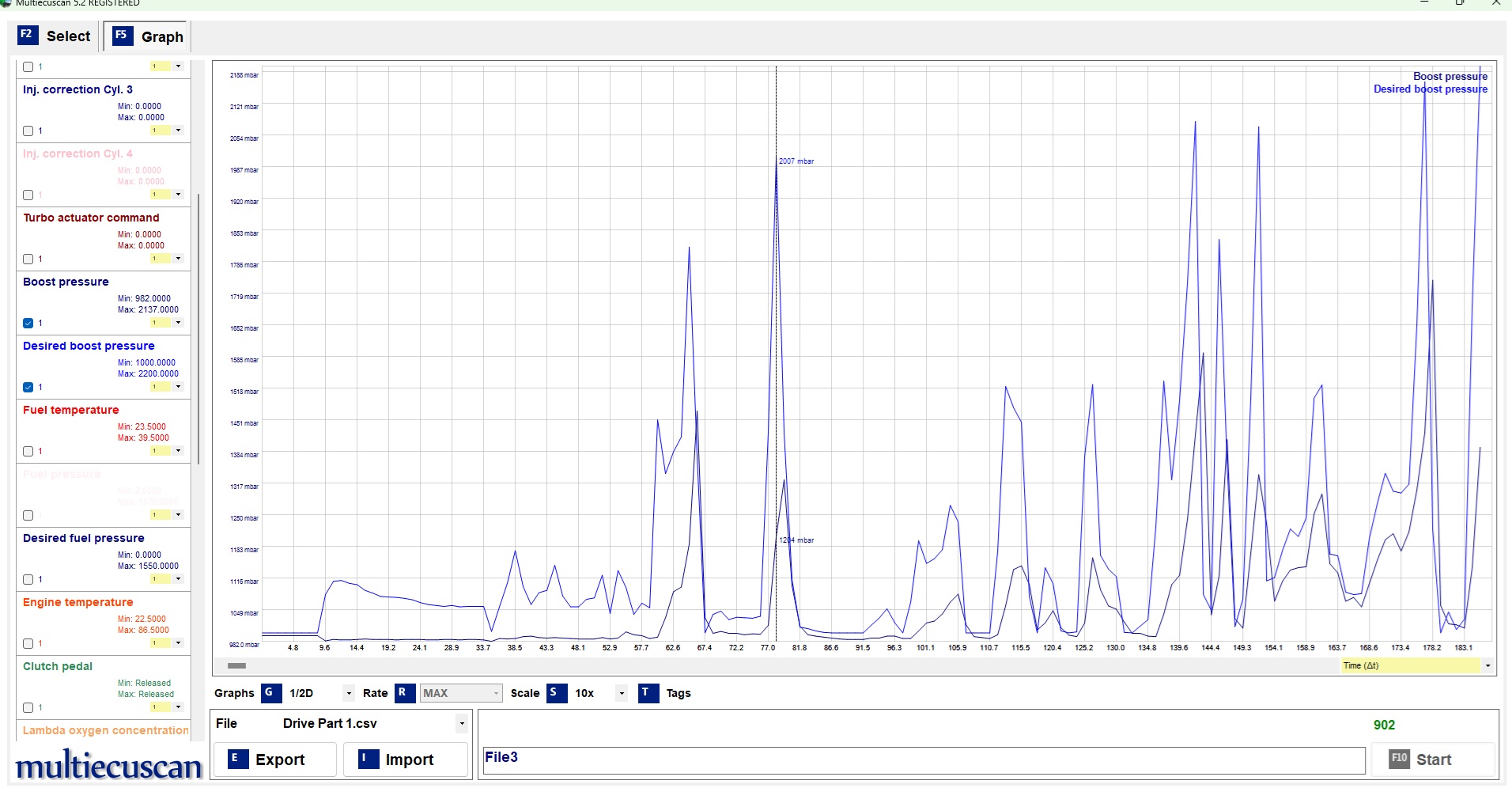

from looking myself surely this isn't idea
actual boost pressure vs desired boost pressure
also noticed there is no reading for fuel pressure?View attachment 448749
