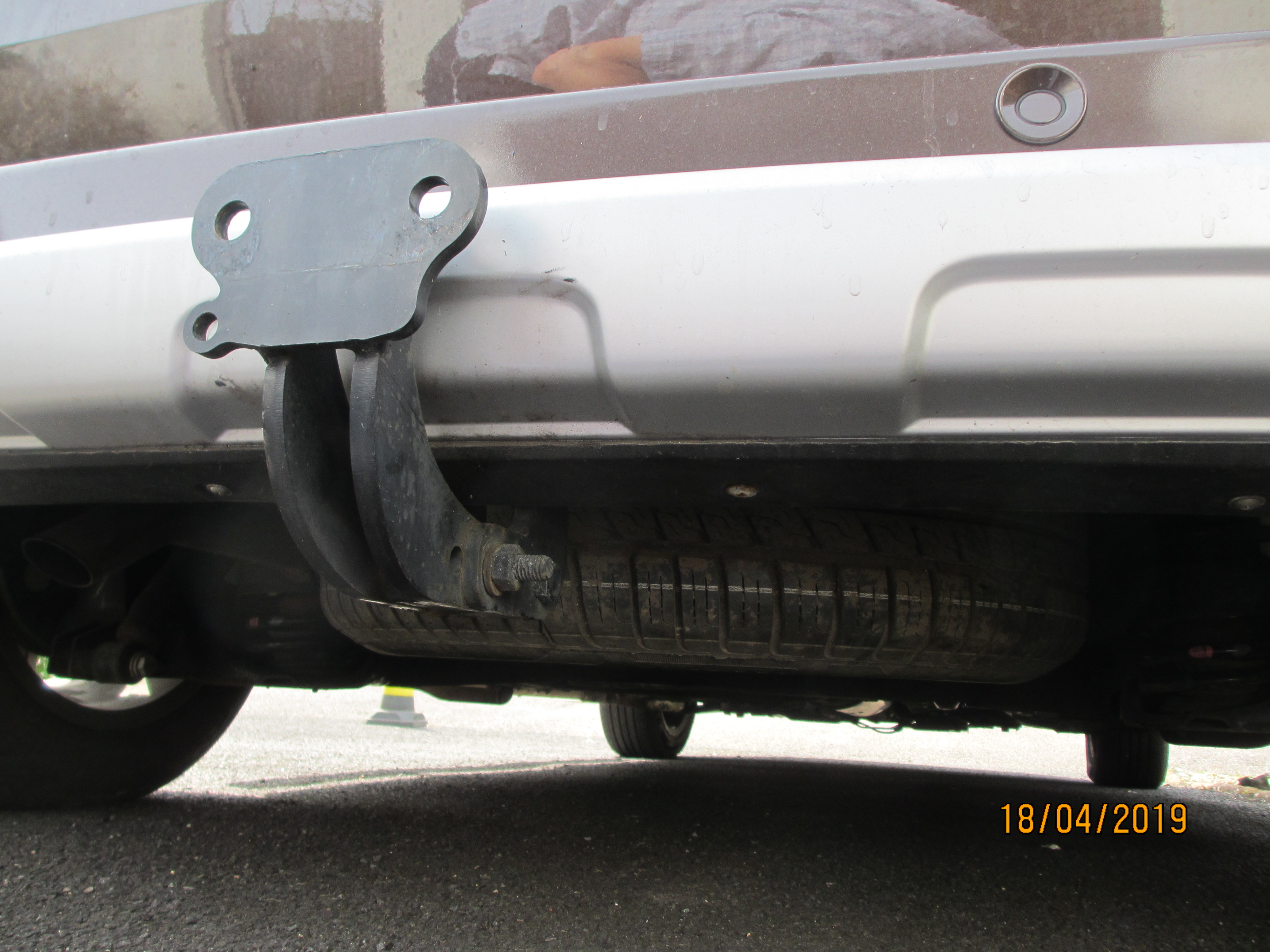

I went under the Qubo yesterday and photographed the stud layout with the previously ok wheel stand-offs. Enclosed are reasonable attempts showing the 2 smaller brackets do fit (relying on gravity to hold them temporarily in the pic, no nuts affixed) but the larger one (which is the RH bracket in the photo,) is to fit the stepped mounting where one stud is on the rear ledge and the inner stud is 'up' on the plane of the other bracket mounts. The larger studs in the middle (group of 3) is for the wheel lowering/raising unit that comes with the cable winder etc.
First picture, the bumper is at the bottom of the pic, 2nd pic it's on the LH side.
As I haven't got a spare (other than the Fiorino steels with winter tyres on, poss different size?) and I haven't got the winder unit either I can't stretch the larger bracket to the new dimension to see if the wheel still fits ok.
I might have the two smaller brackets the wrong way round but the spacing is still ok.

before you fit them could you photograph them with a ruler along side. They look as though they should be possible to copy if you end up using yours.

Hi, thanks for the photos - I can tell your that your layout IS the old type and the standard winder will fit. The V brackets are fine on mine and youalways have to either stretch or compress them slightly to match the holes. I have 4 studs in a rectangular shape where your 3 stud triangle is and there are studs on mine where there are holes in yours each side. The design changed in Jan 2017 apparently and my car was registered in March 2017 (£30 road tax) so I think maybe your car was made BEFORE Jan 17 if my info correct?

The larger bracket may well stretch, I did think that when I was underneath and I was pleased to see the three studs for the winder mech.

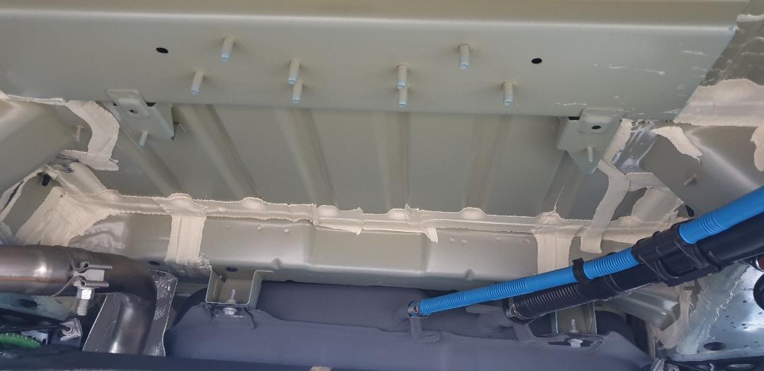

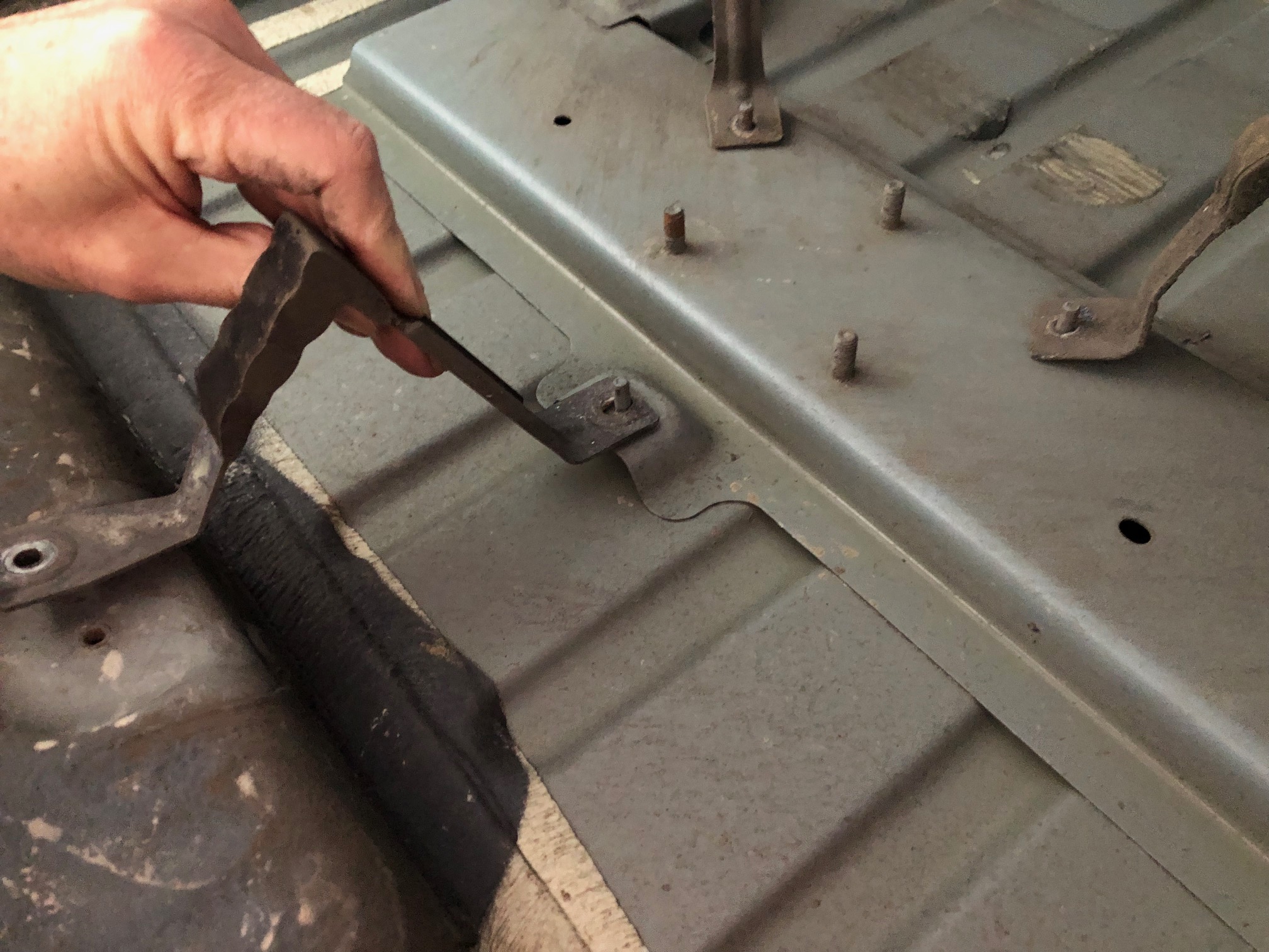

Well I got the blooming carrier fitted but had to hack off the side flange strengthening fins and drilled 2 new holes as well as elongate the other 2 original holes. The 3rd hole is redundant and the carrier is off centre by about 15mm so tyre doesnt go as high as it should but isnt wobbly. I tried to take pics but dark under car. have found a few 17 platers that are 2016 manufactured so mine if definitely a 2017 manufactured vehicle.

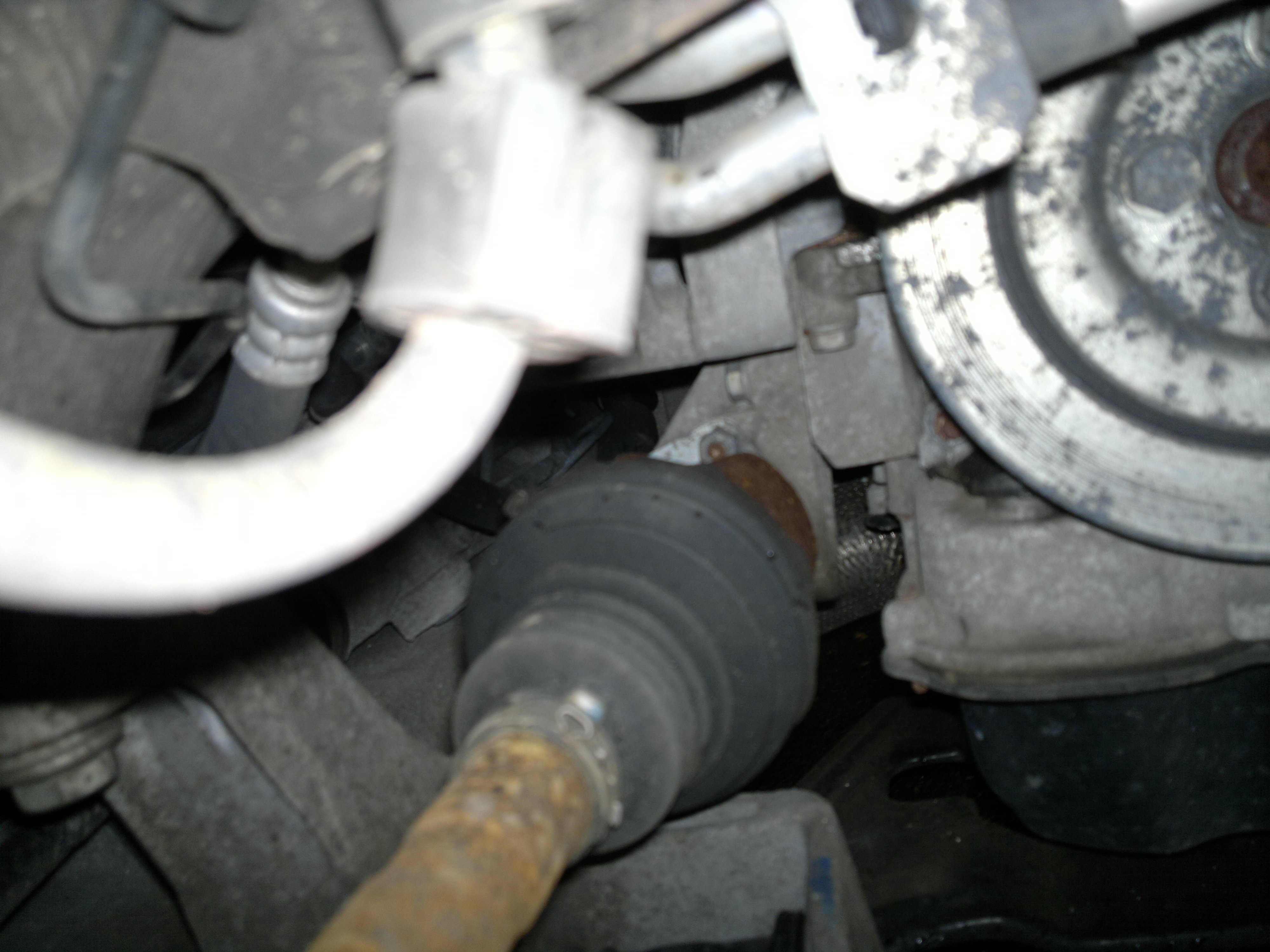

Re steering hose issue - was it on drivers side as per photo attached?

What a fag - why did they have to change the winder mount? Just NO point at all!!!
I don't know where the pipe split on the steering escapade, nor if it was a rigid or a flexi. Must have been o/s as that's where the mess is on the garage floor and the drive shaft region underneath.

Thanks for reply - did you note the rust on driveshaft? - same both sides on mine. I am tyring to find a fiorino van or qubo post 2017 with spare wheel fitted so that I can give the reg to fiat parts who can then get an image and part number. I am sure they did this to stop people getting old ones off ebay.
