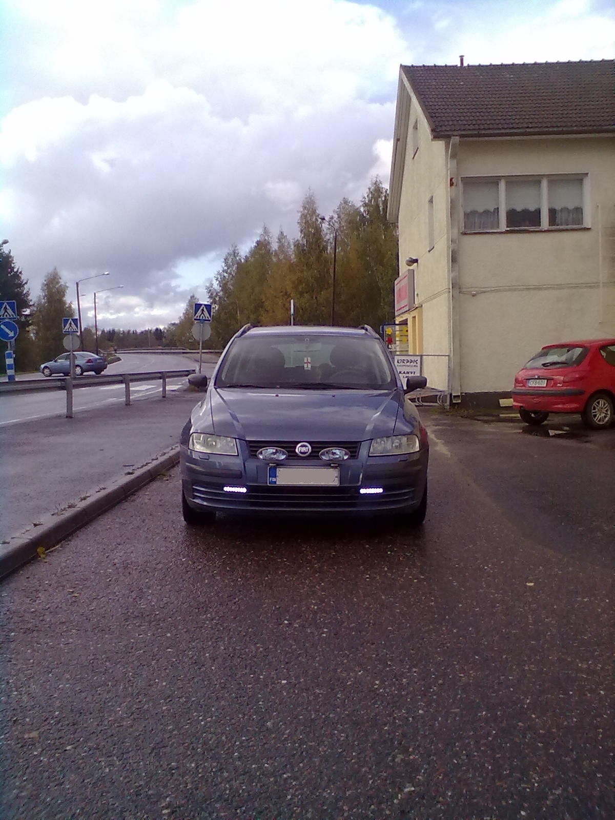

Update: I finally had the chance to fit the extra lights, and I had no problems. I fitted them using the standard procedure for fitting extra lights and they work with main beam and also when I flash the lights.
The lights are Hella's 17,5 ref full/main beam auxiliary lights, so they're legal here and in Norway. The blue and the shape was a coincidence (these were left over from a previous car), but I think they look ok!
I fitted them behind the number plate using a standard black plate with mounting ears on it. You probably have them in Norway - Biltema sell them in other Scandinavian countries anyway (I looked for it for you:
http://www.biltema.no/no/Sok1/Alle/?quicksearchquery=42490). I bolted mine on with three bolts, if I remember right. I drilled through the bumper plastic and fitted right length bolts with big washers so they don't rip through the plastic bumper. It was difficult but possible to get the bolt up behind the bumper, with the washer in place, and push it through. A spanner can fit in there to hold it when you are tightening nuts from the front.
