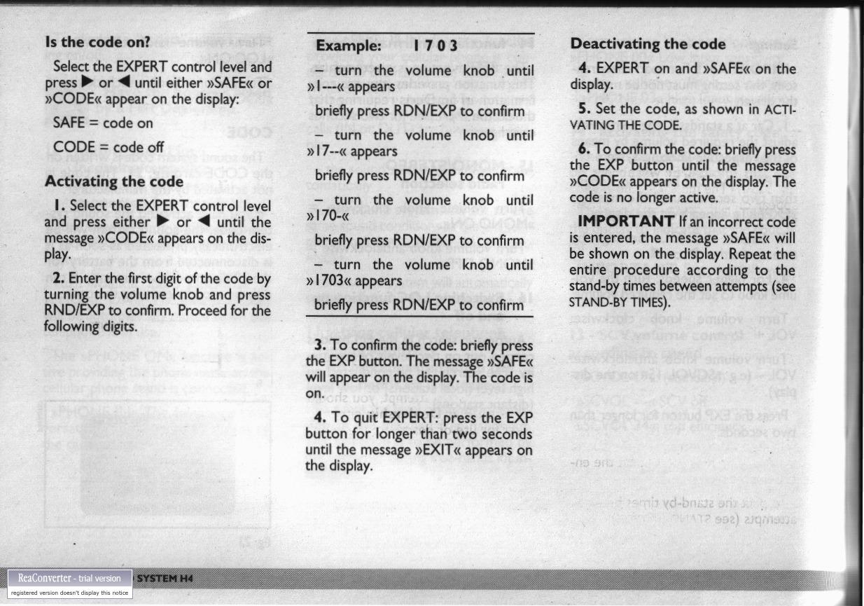

werdna Fiat 500 Devotee Parked in the garage Joined Mar 19, 2005 Messages 1,351 Points 451 Location Under The Hill May 5, 2006 #1 Help please........ can anyone scan the relevant pages of the radio manual so I can change my settings please... thanks in advance.....

trumpeter New member Joined Sep 7, 2005 Messages 96 Points 28 Location ramsgate May 6, 2006 #2 Here we go. Hope you can read them and they are in the right order! Attachments Changing EXPERT functions1.jpg 199.7 KB · Views: 132 CHANGING THE SETTING.jpg 194.3 KB · Views: 120 code on Select.jpg 179.2 KB · Views: 87 eliminate boosts when.jpg 199.6 KB · Views: 94 Resetting for use.jpg 195.3 KB · Views: 97 Setting IMPORTANT For.jpg 191.4 KB · Views: 84 switching sound system.jpg 235.5 KB · Views: 78
OP OP werdna Fiat 500 Devotee Parked in the garage Joined Mar 19, 2005 Messages 1,351 Points 451 Location Under The Hill May 6, 2006 #3 Thanks trumpeter, just what was needed.
