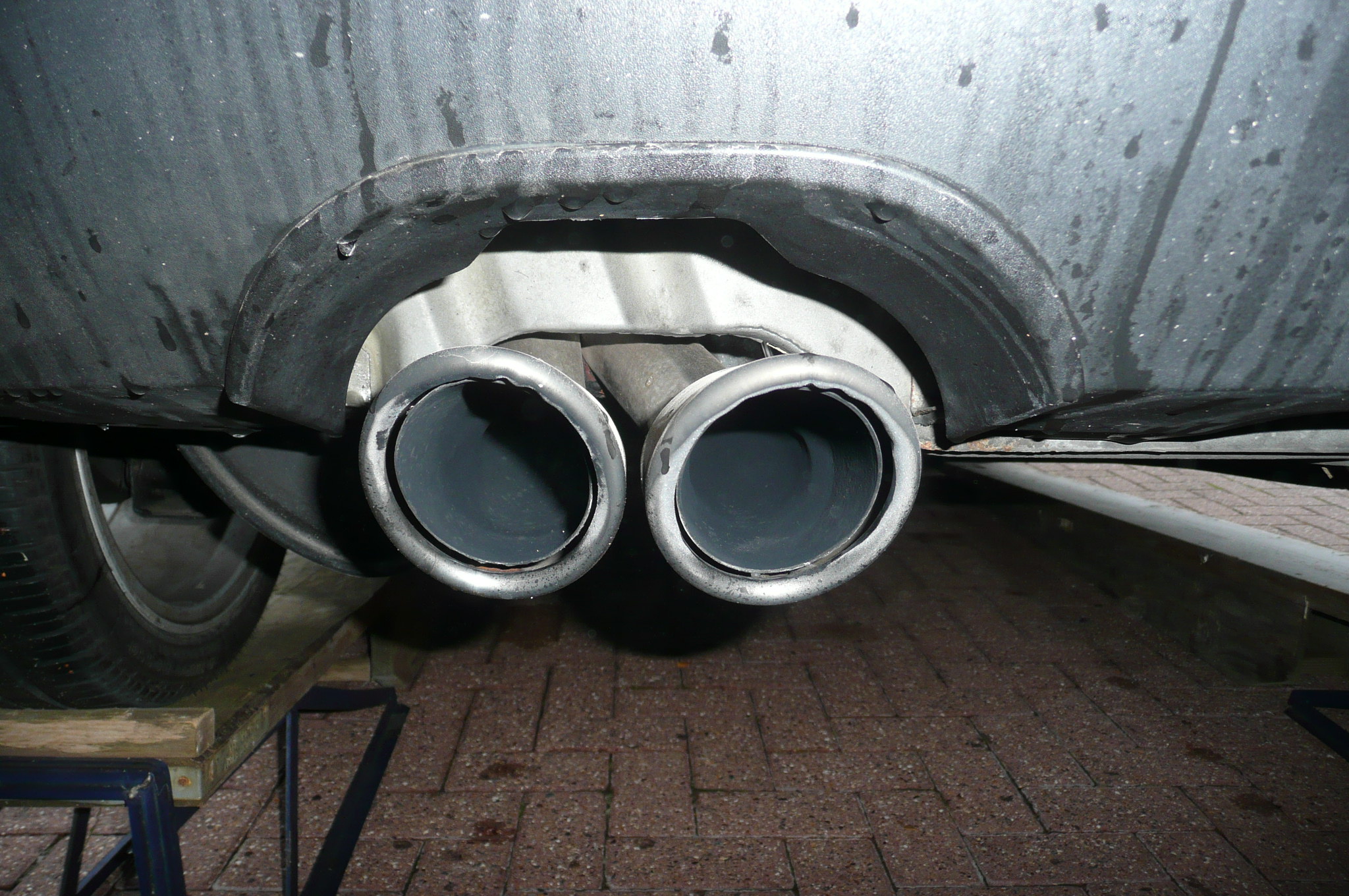

OK. Re-did my exhaust hangers today and as requested, took a few pics along the way.
First, here's a 'before' pic. The reason for doing the job was excessive lateral movement of the rear part of the exhaust, rather than how the tips were 'hanging'.

And here's an 'after' picture. Compare this with the first one and you'll notice the tips now sit a little higher in the bumper cut-out. The lateral movement was greatly reduced.
Hope that was useful.
